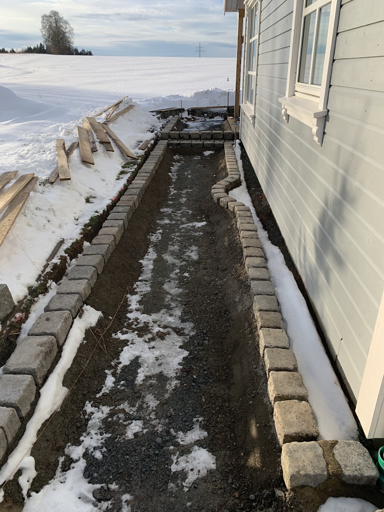

At the moment, we are using old street paving stones to edge our paths. These stones rest on a mortar bed made from gravel concrete and cement (mix ratio 4:1, earth-moist). On the actual path, we will lay small stone and mosaic paving on paving sand. But that will be done in summer.
The doorstep stone and the steps were then set on the same mortar bed. We initially planned to lay them only on frost protection because the stones themselves are incredibly heavy. But we changed our minds at the last minute.
From December (until hopefully the end of February) my husband’s company is providing us with an excavator. During that time, we want to complete work that requires an excavator. Unfortunately, the weather and a broken excavator are currently holding us back completely. The plan was to have the edge stones of the access path set, pour the foundations for the veranda and the carport, and excavate 50 meters (about 164 feet) of foundation for the dry stone wall by the end of February. From February, we sadly have to work full-time again and will only be here on weekends. By now, I’m just glad if we manage to finish the edge stones.

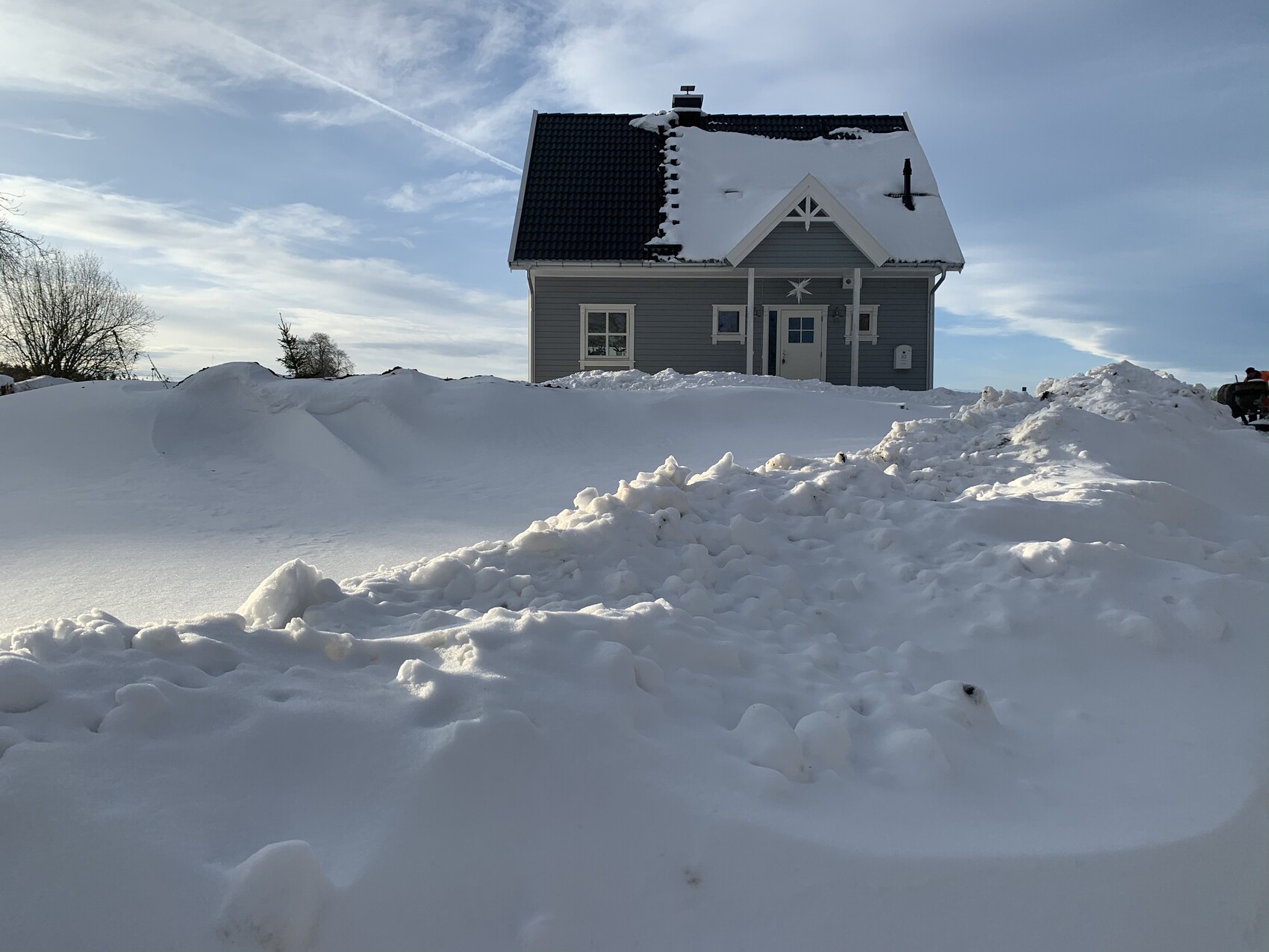

Nice house. But that's hardly any snow. You should come down here to the south 🤨 Even for Upper Franconia, 60 cm (24 inches) isn’t really much snow. But if you want to do paving, unfortunately every centimeter (inch) counts. :-( (on the pile of paving stones, the pile of sand, etc.)
