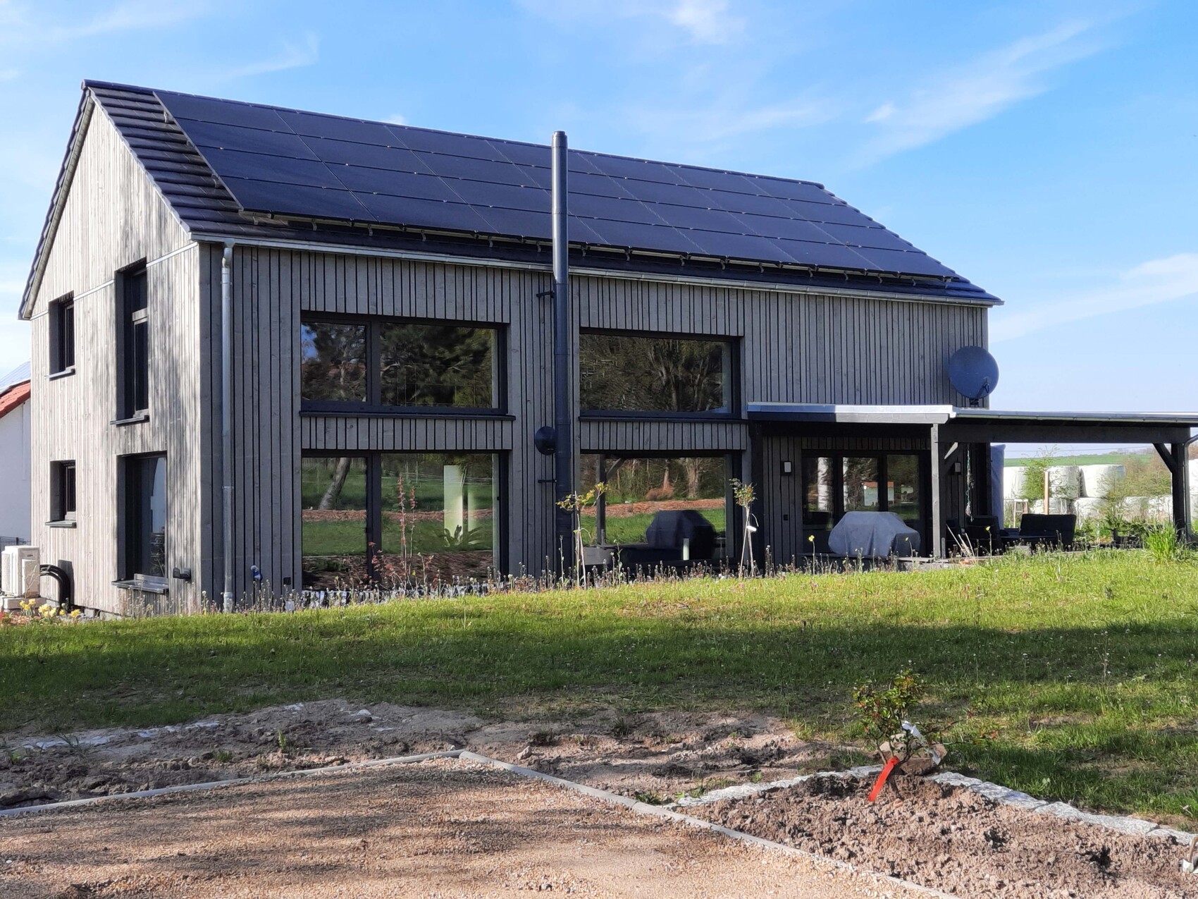

motorradsilke15 Apr 2025 23:41Arauki11 schrieb:
Of course, it’s a matter of personal taste. Ours is gray, and we like how it looks with our wooden facade. I would suggest carefully weighing the pros and cons of having a fireplace in combination with a rather slow-responding underfloor heating system. We use the underfloor heating extensively in winter and only use infrared or air conditioning for occasional supplementary heating. But if you only plan to use the fireplace on a few nice evenings and don’t need regular heating, I would seriously reconsider spending that much money on it and definitely install an air conditioning system. My wife was initially skeptical about that, but now she says it was one of the best decisions we made for our home because the air conditioning is powered 100% by our photovoltaic system and is used frequently in winter for quick additional heating. A really nice and high-quality wood stove is quite expensive, as are the ducts and connections, plus chimney sweeper charges. As I said, if you only use it occasionally, I would prioritize other things, especially alongside underfloor heating. Also, an indoor fireplace takes up space or may cause other issues.
I’m certainly not trying to promote fireplaces, as depending on use, I wouldn’t have one myself, but I do prefer it over, say, a slate-clad fireplace somewhere in the attic—even though that is, fortunately, a matter of different tastes. Some outdoor heat pump units in our neighborhood are a real eyesore, especially when poorly positioned. I actually find a fireplace great, especially with a slow-responding underfloor heating system. During the day, when you’re active, 21 degrees Celsius (70°F), which the underfloor heating is set to, is sufficient. But in the evening when you’re sitting, it’s not warm enough. So in winter and transitional seasons, we often use the fireplace for additional heating in the evenings. We wouldn’t want to do without it.
