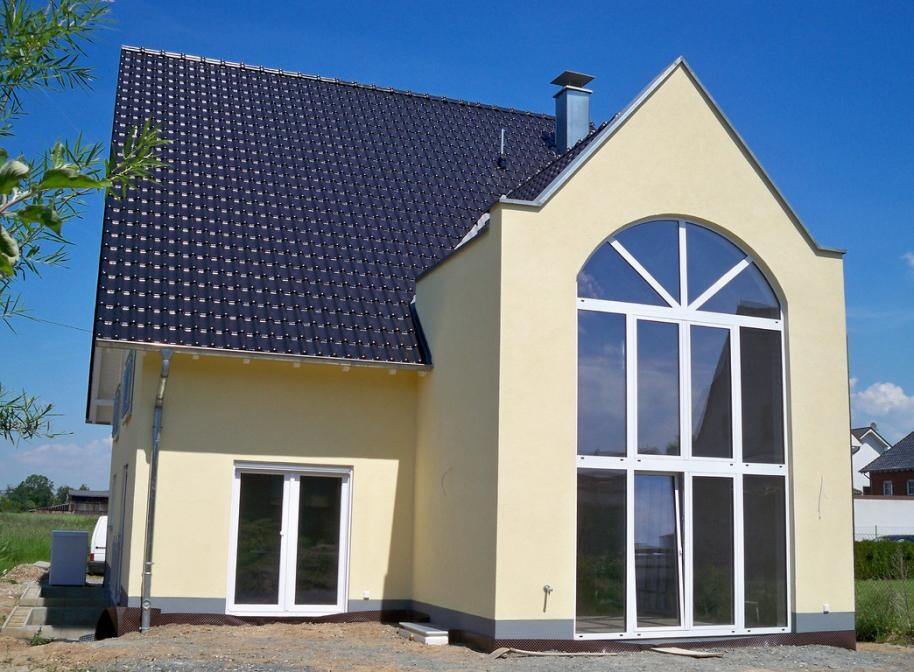

By the way, you will probably not even be allowed to install standard plastic windows; the structural engineer will likely object. The "cathedral" unit is an aluminum-reinforced window element.
Again, you should ask your architect what alternatives they can offer.
Best regards, Bauexperte
kirsel schrieb:A small cathedral as well? One of our clients wanted that too (attachment) 😉

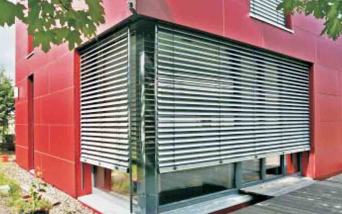

kirsel schrieb:Whether a roller shutter box is a thermal weak spot is debatable; energy saving regulations do not allow much room here. What is certain is that you will not be able to install conventional roller shutters. In the attachment, you will also find a picture of a flush-mounted external roller shutter; if you have enough space above the window element, this is an alternative. These external roller shutters are also available with visible guide rails on both sides; much depends on your building’s architecture. Both systems can be motorized.
