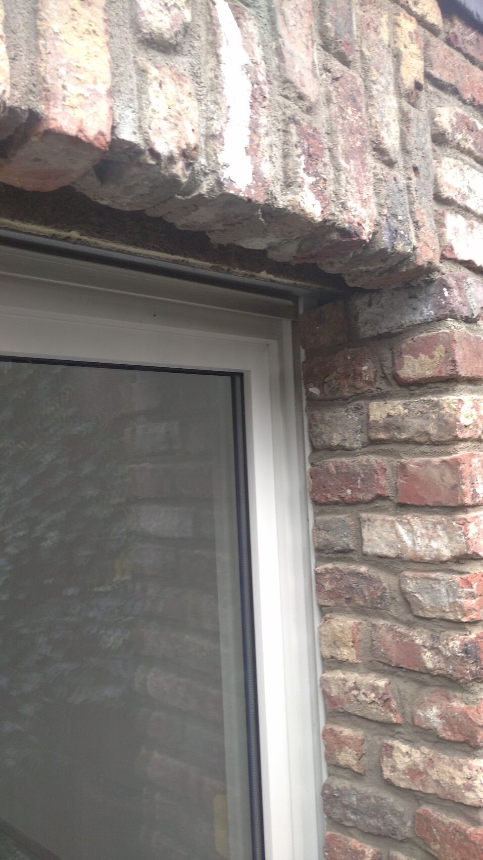

In the picture, you can see the patio door, and above it, there are bricks used as cladding. Shouldn’t there be a lintel installed here for support?

Brick facade with glass sliding door, ivy-planted containers on both sides, paved forecourt.
In der Ruine19 Mar 2024 19:31
The lintel is securely embedded behind the facing bricks in the wall.

Hello, thank you for your reply.
The bricks are simply laid in place. I will upload one or two more pictures over the weekend.

thopke63 schrieb:
The bricks are simply laid like that.
Sure. That's basically how nearly every brick-clad house looks. Mine from the 1960s is the same. Behind the brick cladding, there is often a roller shutter box and above that a lintel (or the concrete ceiling).

I found another picture on my phone. As mentioned, I will take more photos over the weekend.
White window frame in red brick wall; visible crumbling mortar above the window.

nordanney schrieb:
Sure. That’s roughly what every brick-faced house looks like. Mine from the 1960s is the same. Behind the brick veneer, there is usually a roller shutter box and above that a lintel (or the concrete ceiling).
Exactly. The bricks used are facing bricks. But is it really safe if the bricks are simply mortared in place like that?
