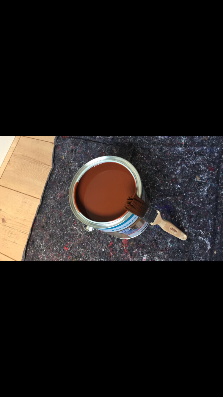

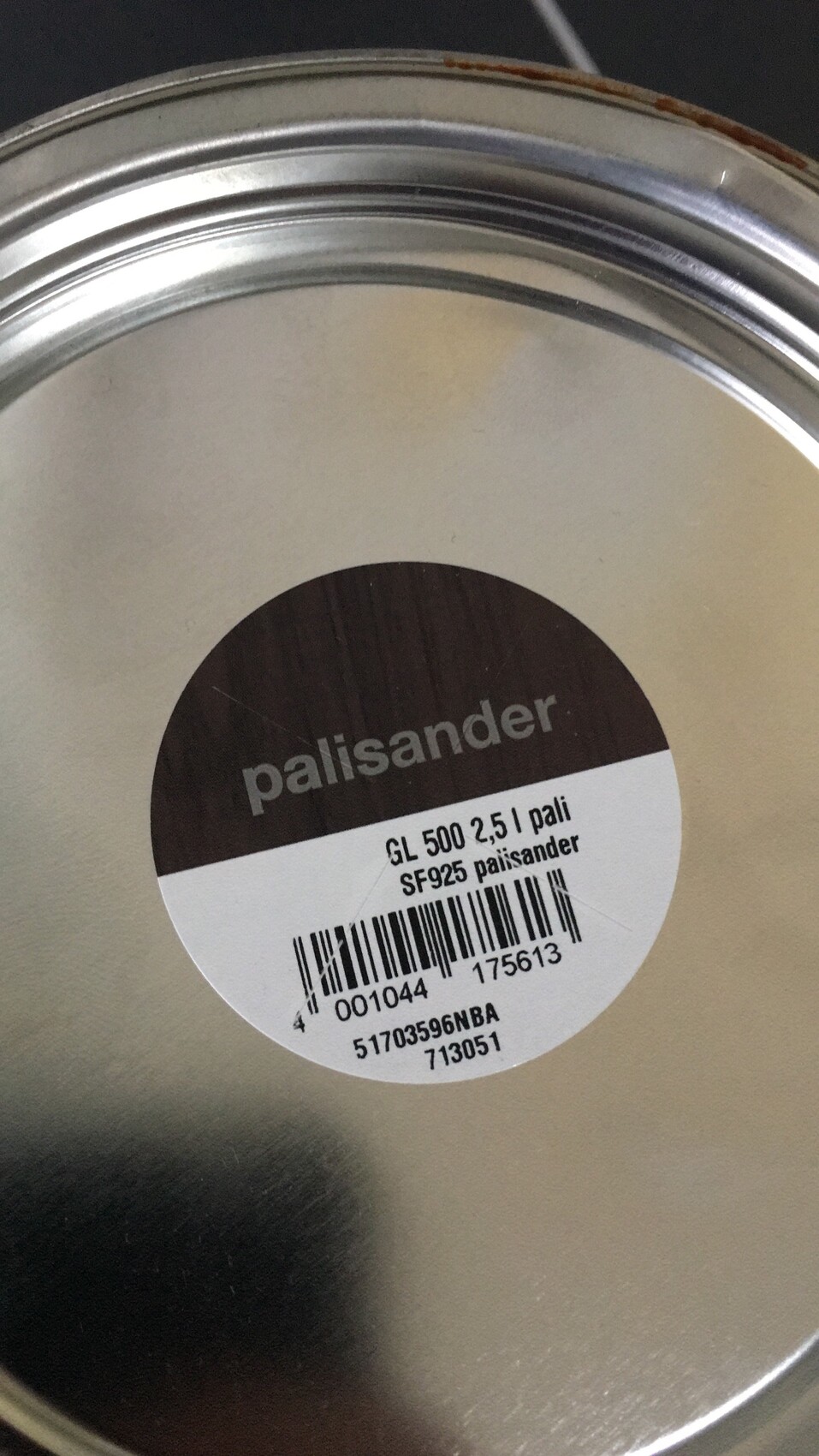

I’m about to start lightly sanding and painting my wooden windows.
I chose the color Palisander, which exactly matches the color on the lid, matching my window color. When I opened the can (see photos), the color looked much lighter. Once applied, it actually looks almost orange.
Question:
Will the color darken over time, or did I receive the wrong can?
Thanks!
Close-up of a metal can with Palisander color label and barcode
Close-up of a worn stair railing with painter’s tape on the wall edge
Brown paint can with brush on a workspace during interior construction.
18 Jul 2017 14:41
Nothing here darkens over time.
But you should give the color pigments a good stir—have you done that?
A glaze is always lighter and is only intended as a color refresher. Maybe a tinted varnish would be better for a more opaque coat?
Best regards in brief
Nordlys
18 Jul 2017 17:44
Paint oil. Owatrol, for example. Stirring is a good idea. A very good idea!
