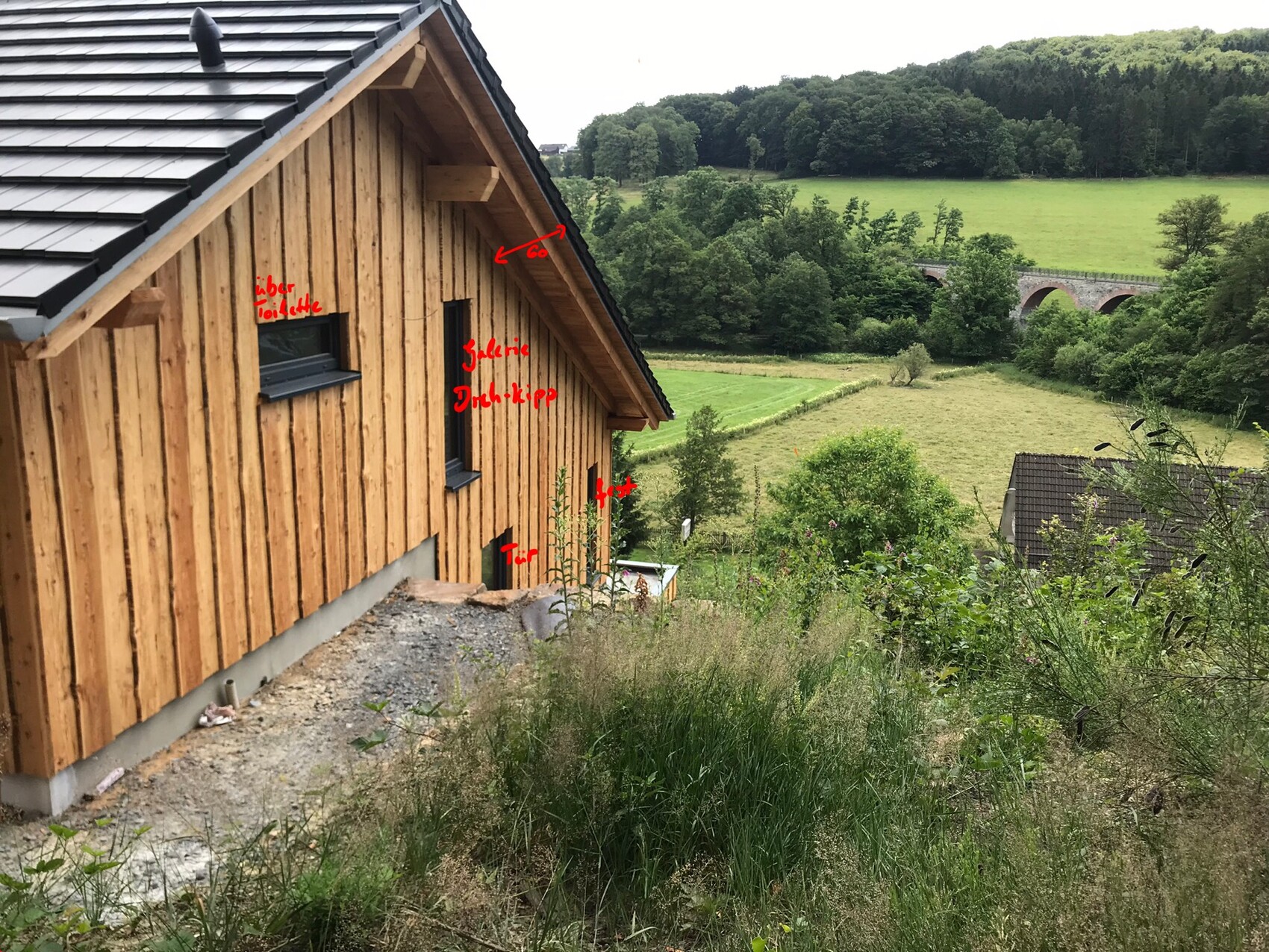

hampshire14 Jul 2019 10:50haydee schrieb:
Light should come from above. How do you shade the windows?The upper windows have electric shutters (if needed), with an all-around roof overhang; the two west-facing windows are structurally unshaded.H
