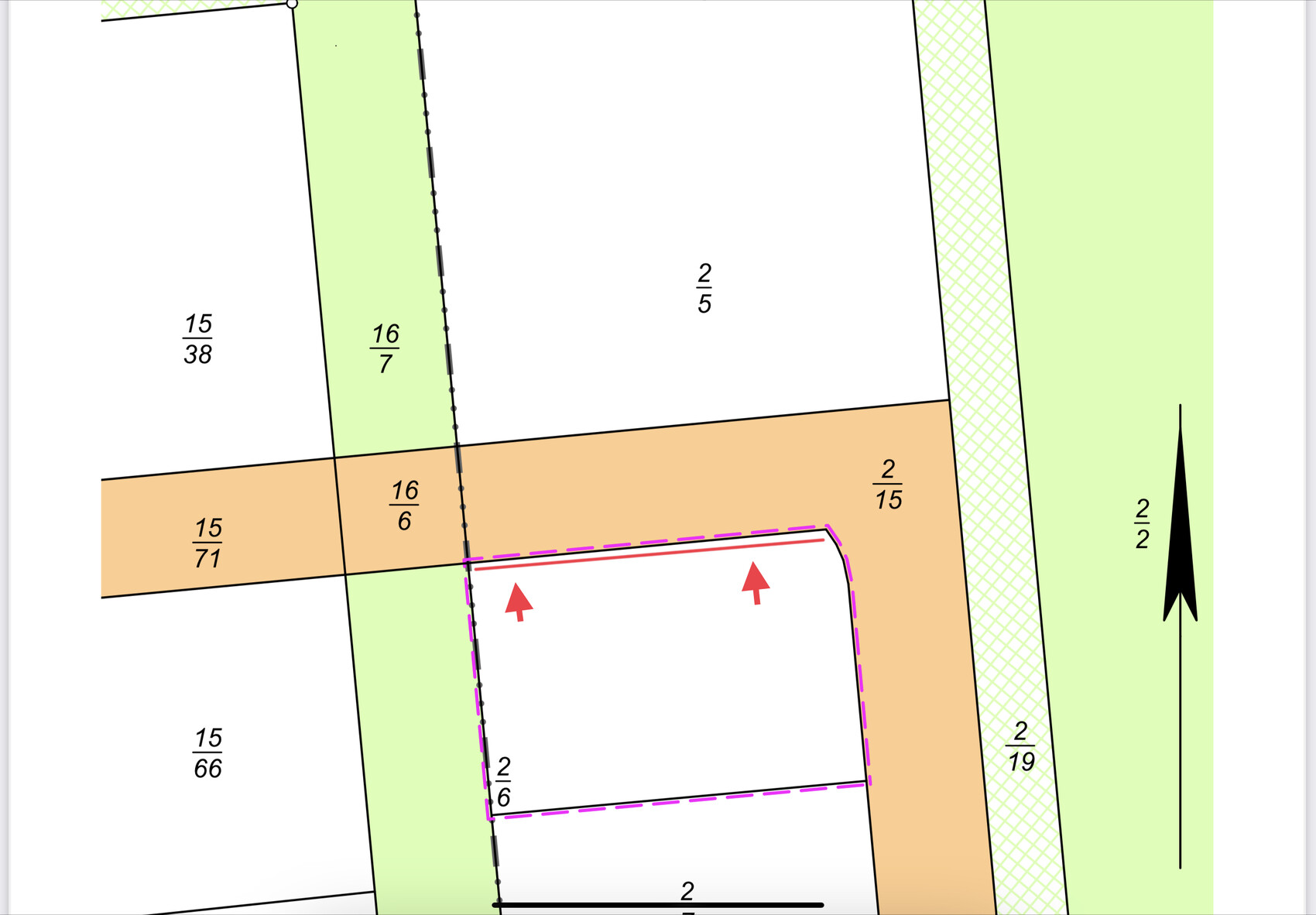

here is the situation..
The fencing regulations in our development specify a maximum height of 0.80m (0.8 feet) for my property (purple boundary).
However, this means that the entire side (red marking) would theoretically remain open, providing an unobstructed view into my garden.
Is there any way to have privacy screening there without having to maintain a 5.0m (16.4 feet) distance from the street?

Plant a hedge or something similar and wait until the housing development has settled in? If the greenery looks nice and grows well, hopefully no one will mind. And until then, you’ll get to know your neighbors and the street life 😉

The same applies to the adjacent property areas up to the front building line, but no more than 5.0m (16.4 feet) from the roadways.This is certainly a typographical error that I do not believe requires any change to the development plan. I don’t see any judge disputing if you, as probably intended, install a fence 0.80m (2.6 feet) high in front instead.https://www.instagram.com/11antgmxde/

Is there also a protected area there, for example a terrace, or just a “border strip”?
Terraces should be equipped with privacy screens or planting close by, as protection works best when it is near. For children’s play areas, it hardly matters whether they are visible or not.
In the unique corner location, at least you’ll get a chance to talk with the neighbors 🙂
Otherwise, there probably isn’t any other solution.

hampshire9 Feb 2021 23:37A curtain construction is also possible. It is not permanently installed and can be easily pulled closed or set up when needed. A few taller stabilized fence posts, steel wire cables, and a suitable tarp...
