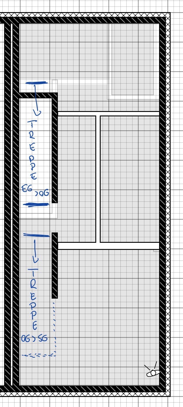

The floors are connected by two straight staircases (i.e., the line of sight from the entrance to the top floor is one continuous line), which
  • on the left side run along the partition wall to the neighboring house (20 cm (8 inches) calcium silicate brick – 8 cm (3 inches) mineral wool slats – 20 cm (8 inches) calcium silicate brick), and
  • on the right side along a load-bearing partition wall (17.5 cm (7 inches) calcium silicate brick) within the house.
Below the stairs are the basement stair(s) and a room; mirrored next to the partition wall is the staircase of the neighboring house. On the upper floor, the staircase is visible from below. Attached is a sketch of the upper floor layout (where the stairs meet), which hopefully helps to understand the setup.

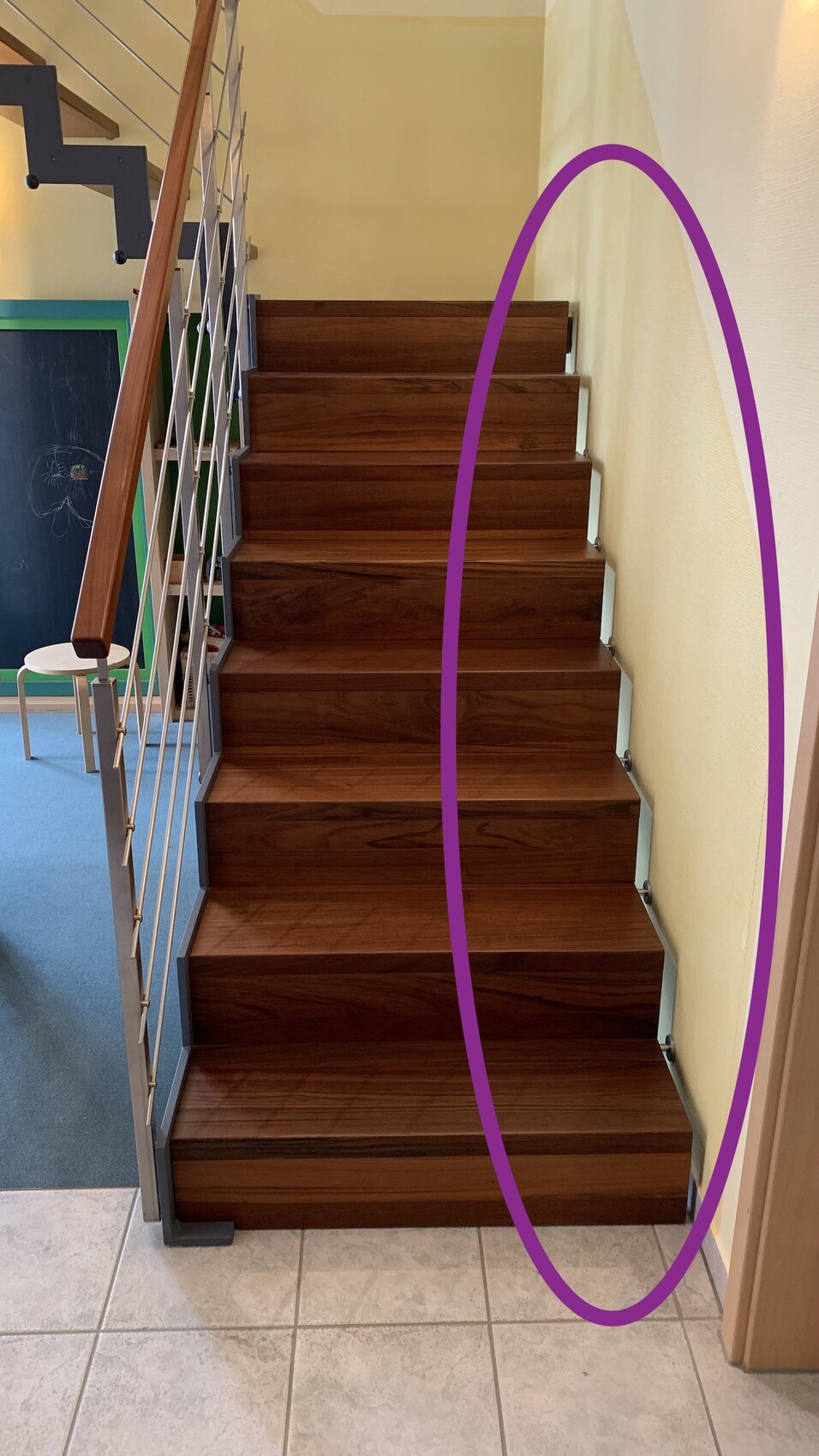

Our original wish was for a folded-stringer staircase (or a staircase with the appearance of one), which would also be flush with the wall and, given the rooms underneath, naturally fully enclosed—or a staircase without visible stringers. As far as I understand, these types of stairs can apparently only be constructed if one side of the staircase is open, because the stair treads are slid onto bolts anchored in the wall? Is a similar construction possible “between two walls”? Above all, we want to avoid gaps between the stair treads and the wall, because there are rooms beneath and we have cats that shed dirt and long hairs...
For the first stair selection offer, we were told that due to sound insulation requirements next to the neighboring house, a fastening method like that of a folded-stringer staircase is not possible. The only two options are:
  • attach a stringer from below, on which the treads are mounted with rubber buffers to cushion them, but this method cannot be implemented quietly, or
  • a bolt stair, which would have at least a 2–4 cm (1–1.5 inch) gap on the left and right sides of the treads (see highlighted area in the attached image), which cannot be avoided. On the one hand, I find such gaps aesthetically unappealing, and on the other hand, we have the problems already mentioned.
Our preference would be a staircase, ideally in the style of a folded-stringer stair, that has no gaps to the wall on either side and is as quiet and sound-insulating as possible.

I don’t quite understand the general contractor’s argument. After all, every staircase will need to be anchored somewhere into the party wall. Sound issues can be avoided—for both the neighbor and yourself—by using a concrete staircase finished with a “folded plate” design.
