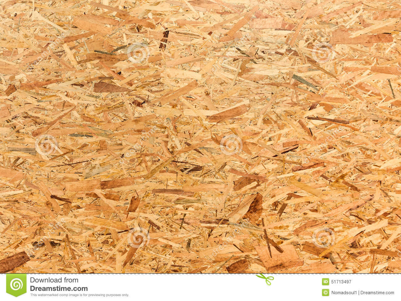

During the laminate installation, when the baseboards were removed, you could see wood fiber boards (see picture below). These were probably added later and then wallpapered over? But they are still not fully installed at the bottom. Currently, you can push the entire construction aside at the window and see the masonry behind it.
Close-up of OSB boards, wood chipboards used as building material in the shell construction.
