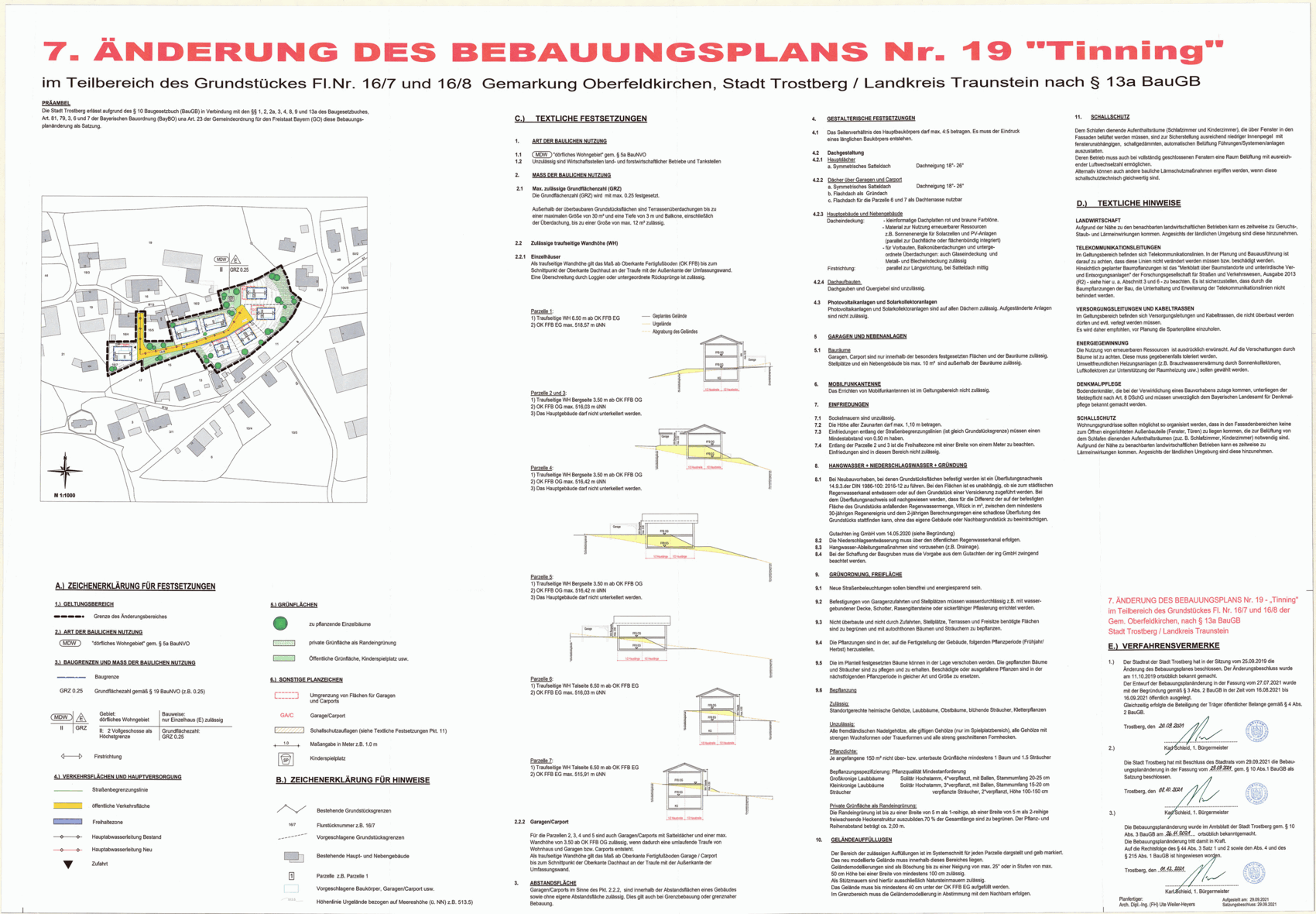

we are beginners and about to purchase a sloped lot on a south-facing hillside (elevation difference north to south approx. 5 meters (16 feet)). The plot is located in Bavaria.
The supplement to the development plan allows for 2 full stories, but it must appear as a single story on the uphill side, while two stories may be visible on the downhill side.
The following notes apply to this parcel:
1. Eaves height on the uphill side 3.50 m (11.5 feet) above finished floor level of the upper floor
2. Finished floor level of the upper floor maximum 516.03 m (1693 feet) above sea level
3. The building may not have a basement.
The development plan and section look as follows, but unfortunately we cannot fully understand the ground floor.
[IMG alt="SChnitt.PNG"]https://www.hausbau-forum.de/data/attachments/68/68660-6985244365f74d16227805dd8e906317.jpg[/IMG]
Does the ground floor therefore have to be completely underground, is that what is meant by the “yellow” area, or how should this be interpreted?
Could, for example, the yellow area be exposed so that the “ground floor” is flooded with natural light from three sides?
Best regards from the building novices
Manuela and Sepp

Indeed. We had to process that first yesterday 🙂 because to get a reasonable amount of daylight into the ground floor, we have to build very deep (actually, 8 meters (26 feet) was planned, but that would only just bring us "above ground").
If I may ask again, you mentioned raising the house. That can only be done by a maximum of 50 cm (20 inches), right? Due to the maximum eave height.
Many thanks!
Many thanks!
MaSeBau schrieb:
If I may ask again, you mentioned raising the house "higher." But that’s only possible by about 50cm (20 inches), right? Due to the maximum eaves height.
Yes, it probably won’t be much. But that also depends on the storey heights. Also, keep in mind that standard windows on the side have a sill height of about 90cm (35 inches). You might not be able to plan terrace doors on both the left and right sides, but you can still have plenty of windows.
