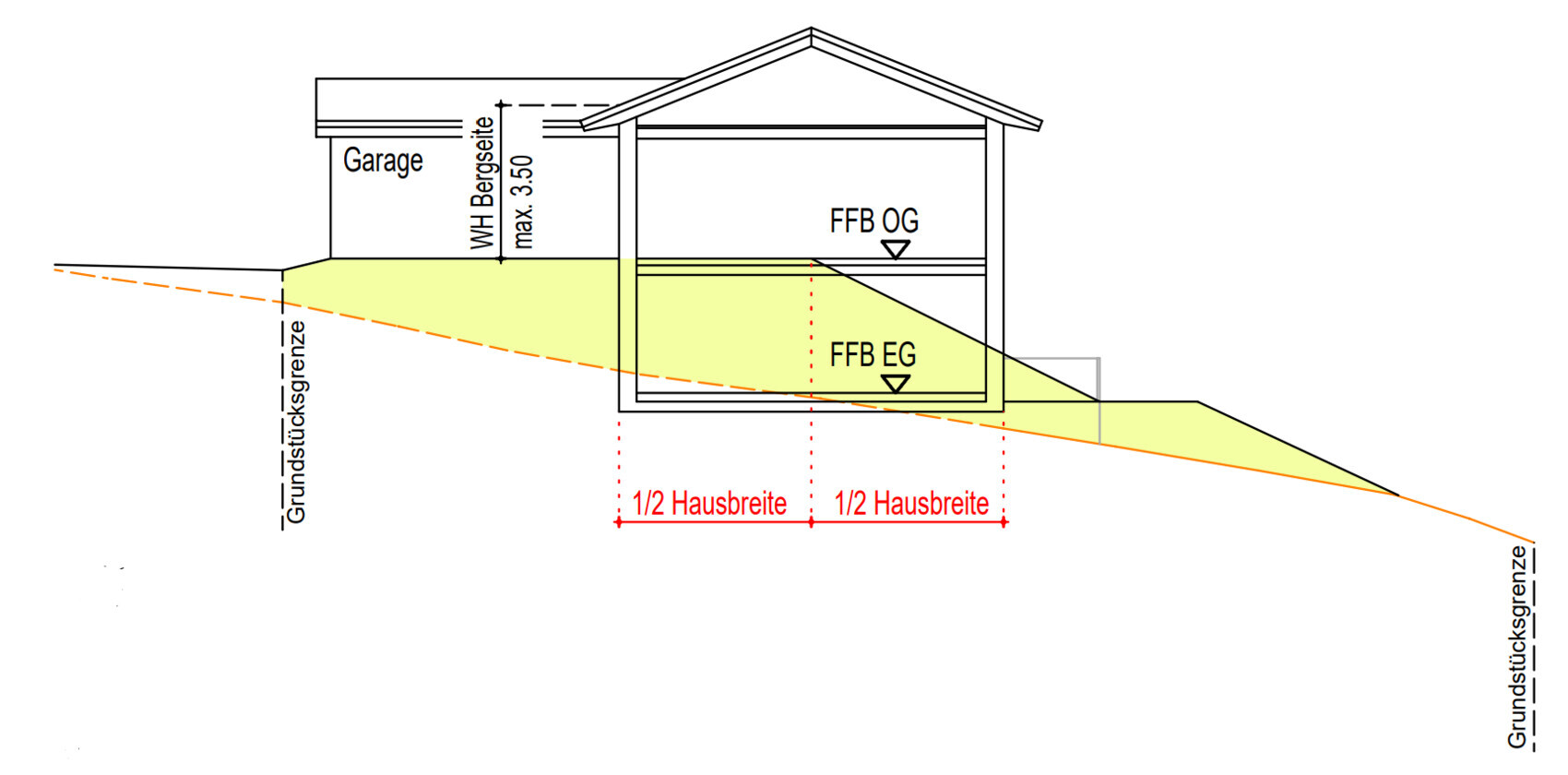

The development plan and section look as follows, but unfortunately we cannot fully understand the ground floor.
[IMG alt="SChnitt.PNG"]https://www.hausbau-forum.de/data/attachments/68/68660-6985244365f74d16227805dd8e906317.jpg[/IMG]
Does the ground floor therefore have to be completely underground, is that what is meant by the “yellow” area, or how should this be interpreted?
Could, for example, the yellow area be exposed so that the “ground floor” is flooded with natural light from three sides?

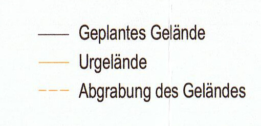

Regarding the legend:
The red dashed line represents the current slope of the terrain. The yellow area indicates the slope fill.

First, here is the legend for the cross-section drawing:

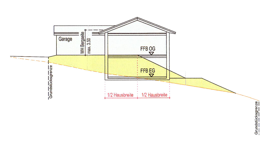

And to have everything together, here is the cross-section again:

My interpretation is: Within the yellow area, you are allowed to shape the terrain. For your property, this is almost the entire plot—the yellow area ends only at the lower edge of the slope, where the natural terrain must be maintained.
The house itself must initially be built with at least 40cm (16 inches) of fill up to the finished floor level of the ground floor. The terrain shaping mainly refers to the remaining area around that.
Where you start modeling the terrain or whether you do it at all is up to you. The only restrictions are that you must not exceed a 25° slope or build retaining walls higher than 50cm (20 inches)—and those have to be natural stone, which is costly. Regarding width, I think the description is somewhat unclear. I assume the 1m (3 feet) refers to the depth of each step (but it could also mean width—worth checking).
Accordingly, you can calculate how much you can shape the terrain within your building area by either using retaining walls or a 25° incline.
With a 25° slope, you overcome a height of 3m (about one story) over approximately 6.4m (21 feet). Using steps, you can reach that height faster, roughly after 5m (16 feet), assuming the note about width/depth is correct. But it also depends on where your basement starts. Do you place it fully embedded on the slope side, or do you raise it somewhat? Your eaves height may be up to 3.50m (11.5 feet) (based on height line 516, which likely corresponds roughly to street level). Depending on the building depth and gravel (both figuratively and literally), your basement may be exposed on more than half of its sides. (Unfortunately, I can’t find the depth of the building area in the documents.)
Putting theory aside, it’s a very nice property but also expensive to build on. You should budget over 100,000 for earthworks and slope support—I would estimate closer to 130,000. Natural stone retaining walls are expensive.
