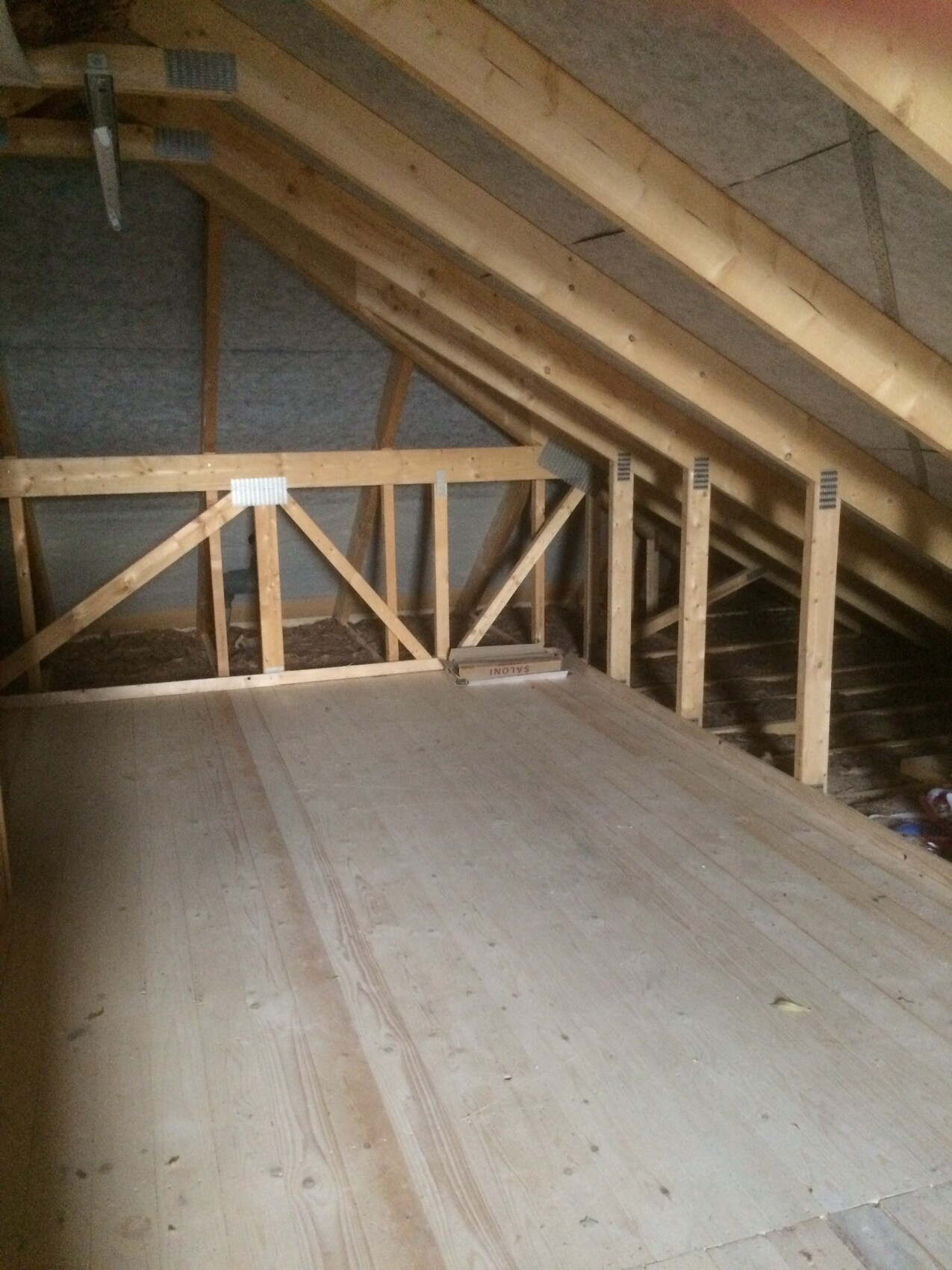

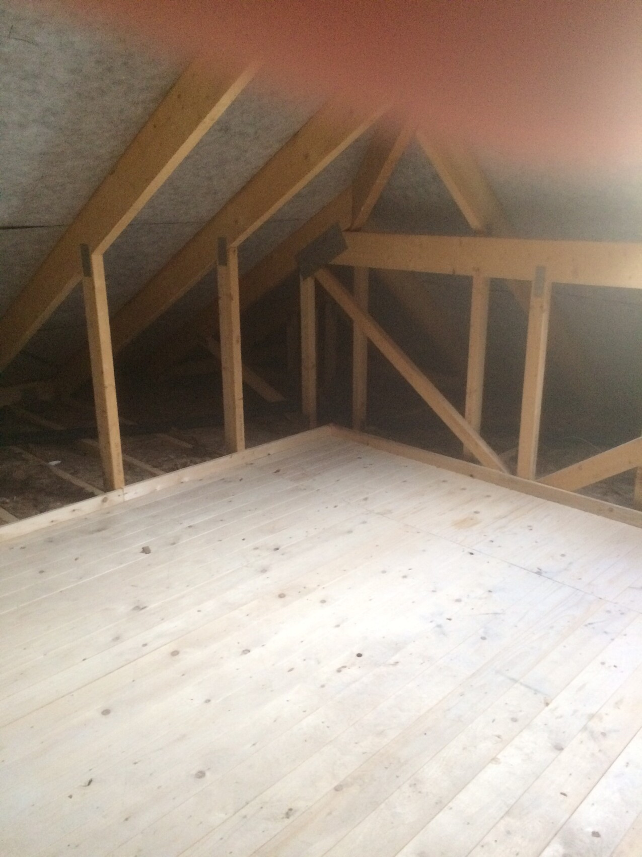

We have a bungalow with a slab measuring 13.5 by 10 meters (44 by 33 feet), and a hipped roof with a 30° pitch along the length and 45° on the short sides. So far, the roof is not insulated. The roof area is approximately 160 square meters (1,722 square feet), possibly a bit more. The ceiling between the floors is insulated. We use the attic not as living space but as a cellar substitute. It is accessible by a staircase, not a hatch, since the stairs are easier to use. A patio door separates the living area from the unheated attic well, providing good thermal separation. Unfortunately, this floor gets very cold in winter during frost — I’ve even had paint freeze — and very warm in summer. Now that we have some funds available, we have asked a carpenter to provide a quote for insulating the unheated attic floor (ceiling below the attic).
He is quoting us 8,500 gross for installing 200 mm (8 inches) of cavity insulation between the rafters, along with a vapor barrier and drywall lining, without plastering or painting.
Is this a fair price? Too expensive? Or even a good deal?

You can certainly "fold" the vapor barrier and attach it directly to the insulation. However, if you stretch it over the rafters and the insulation does not fully fill the cavity depth, you create a separate air space between the insulation and the vapor barrier that no longer mixes with the air in the attic. This risks having different climates on either side of the vapor barrier within those air volumes. In such cases, I would expect condensation to form on the insulation side of the vapor barrier. Using insulation as thick as the rafters avoids this problem (or alternatively "folding" the vapor barrier, which in my opinion is a bit of a tedious task). But be careful – my expertise lies in drawing clerk insults, windows, and a handful of other fields—not in insulation stuff with all its various side issues!
