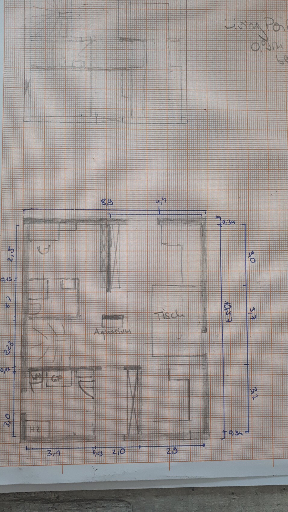

Attachment: Plot sketch 1cm = 2m (0.8 in)
Original floor plan with load-bearing walls in gray
Changes to the floor plan 1cm = 1m (0.4 in)
Technical floor plan: outer rectangle, inner rectangle, green circle, right edge trapezoidal
Sketch of a floor plan with several rectangular rooms, walls, and doors on graph paper.
Floor plan of an apartment with kitchen, hallway, living room, dining room, bedroom, bathroom, and technical room.
Floor plan of a residential house with bedroom, bathroom, kitchen, hallway, and staircase.

A few quick notes on the floor plan.
If room 3 on the upper floor is the master bedroom, try drawing a double bed in actual size. With a 2m (6 ft 7 in) wide bed, there would be less than 50cm (20 inches) of space on each side.
The utility room is very small at 6.5m² (70 sq ft). I don’t see a place for the equipment anymore. You also need workspace next to the appliances and connection areas for water, telecommunications, and so on.
The dining table is located right in the entrance area to the kitchen. The table should be oriented towards the sofa. From the dining table, there is a full view of the entrance to the guest bathroom, which I wouldn’t prefer.

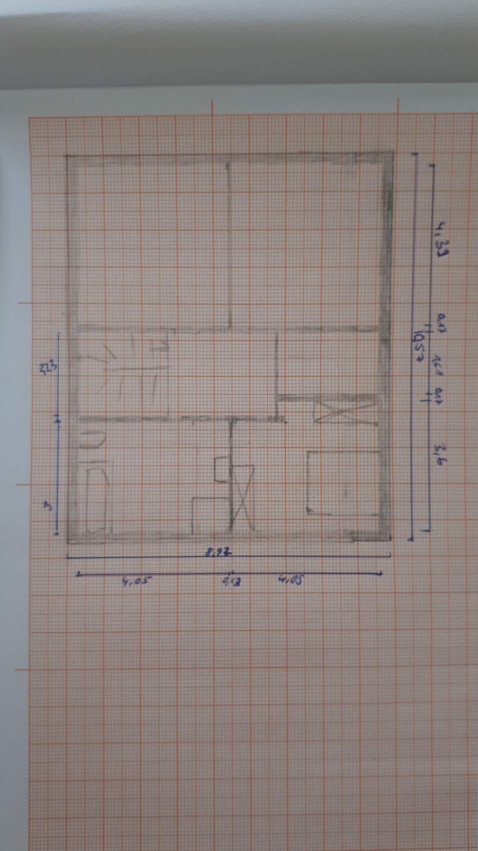

I’ve added the dimensions to the sketch. All the drawn furniture is to scale, except for the sofa, which is actually only 2.2m (7 feet 3 inches) wide.
Now that I’ve included the furniture above, I’m wondering whether the bedroom should be enlarged towards the bathroom or the storage room. I’m not sure if the storage closet adds value, or if ski equipment, a third toaster, and such 😉 can just be stored in the large bedroom closet.
Hand-drawn floor plan sketch of an interior on graph paper with dimension markings.
Floor plan of a residential building with interior walls, doors, and dimension markings on graph paper.

Goldelse2 Jul 2021 11:26
hanse987 schrieb:
A few quick comments about the floor plan.
If room 3 on the upper floor is the master bedroom, try drawing in a double bed at its real size. With a 2m (6 ft 7 in) wide bed, there’s less than 50cm (20 inches) of space on each side.
The utility/technical room is very small at 6.5m² (70 sq ft). I don’t see how all the equipment would fit. You also need workspace next to the appliances and connection rooms for water, telecommunications, etc.
The dining table is placed right in the entrance area to the kitchen. The table should be positioned toward the sofa. From the dining table, you have a full view of the entrance to the guest bathroom, which I wouldn’t prefer.
Good point about the bedroom. Currently, we have 40cm (16 inches) on one side but more on the other.
We plan to enlarge the utility room to 9m² (97 sq ft). Right now, it’s 6.8m² (73 sq ft). There is still room for a cleaning/tool cabinet and a pantry cabinet, but not a door. A dryer is already installed, and a rotary clothesline will be set up in the garden.
We also think the living/dining area looks small on the plan. Currently, it’s 0.8m (2 ft 7 in) longer, but that space is mostly taken up by radiators and unused space in front of them. We don’t really think those 80cm (31 inches) make a big difference, do we? The dining table is actually smaller in reality; the drawn area includes chairs and space behind them. There is naturally no chair in the corner toward the kitchen, so the entrance is free. Also, the sixth chair is only added when guests come. The patio door is currently behind the dining table (between the sofa and TV).
