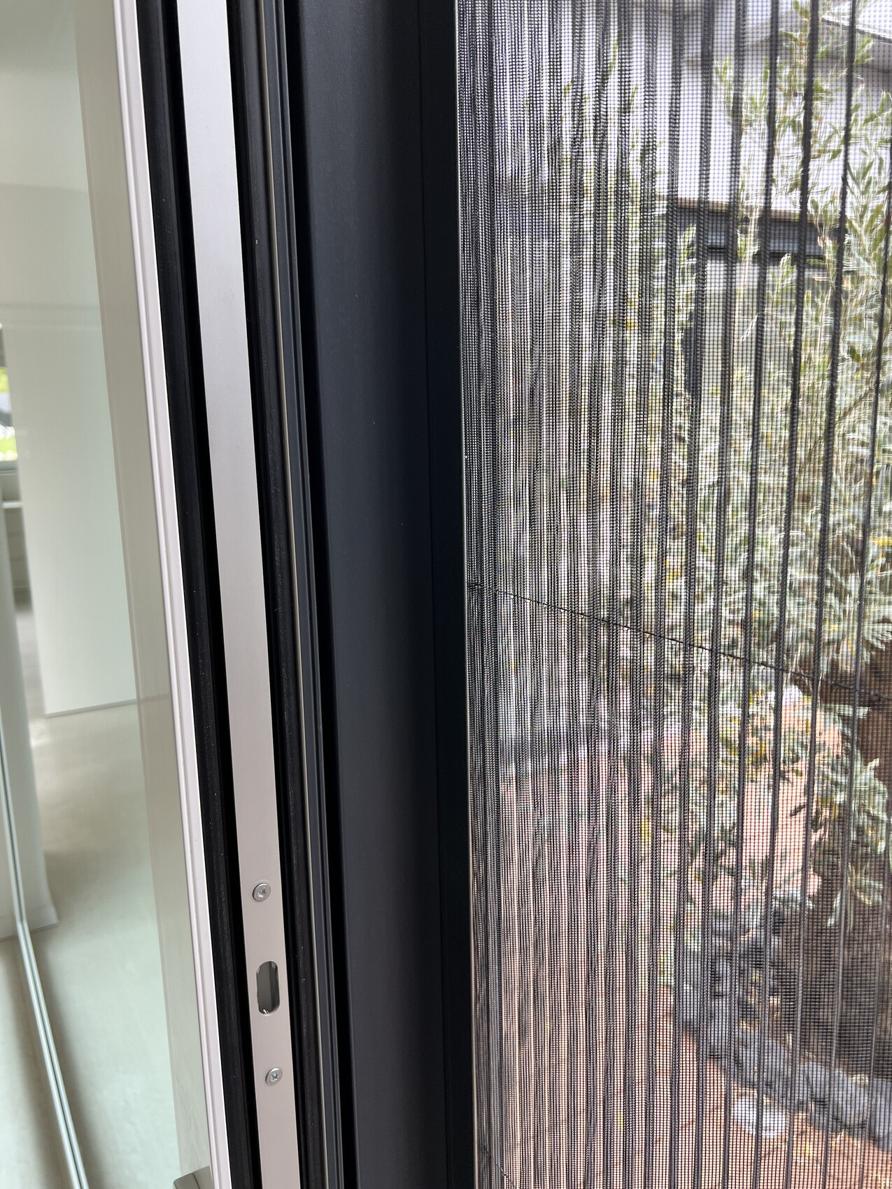

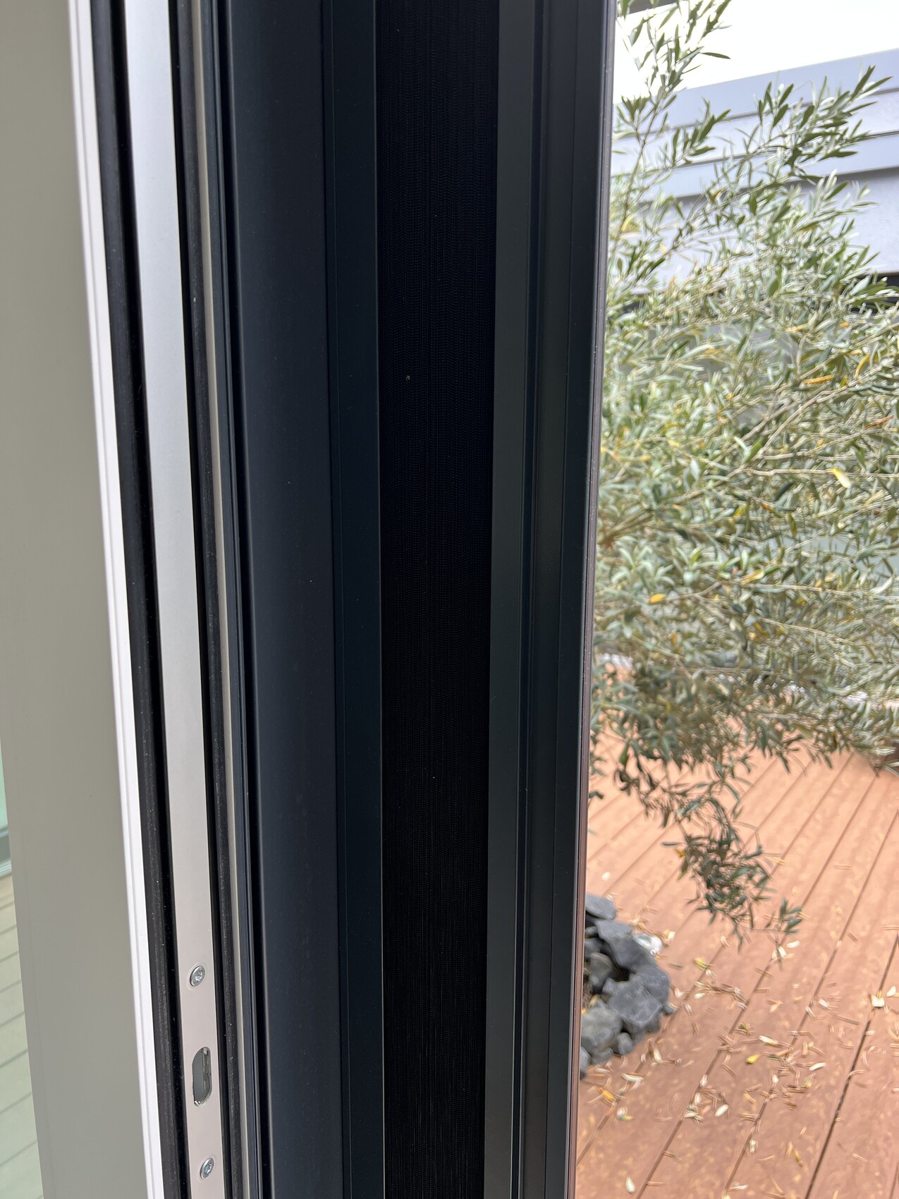

I have pleated retractable insect screens from Neher installed on the side-opening sliding doors, and I am very satisfied with them. They slide open and closed easily and are hardly noticeable when fully retracted. Of course, you will always see the frame or cassette, but that doesn’t bother me. They also work well in combination with venetian blinds and/or roller shutters (I have both on one door).
Due to their pleated design, they are more visible when closed than regular sliding screen frames, but I don’t find that problematic. It’s something you should check out for yourself beforehand.

It is installed in the overhang of the fixed section, so it is level with the fixed glass pane. Roller shutters and venetian blinds run in front of it (i.e., “outside” of it).
In everyday use, I find it much more comfortable than a fixed sliding frame, as those often get stuck. Another advantage is that it stays much cleaner for longer (dust, pollen, etc.) because when not in use, it folds up neatly and is stored away. I have had to vacuum the fixed window grilles twice already, but not the pleated blinds.
