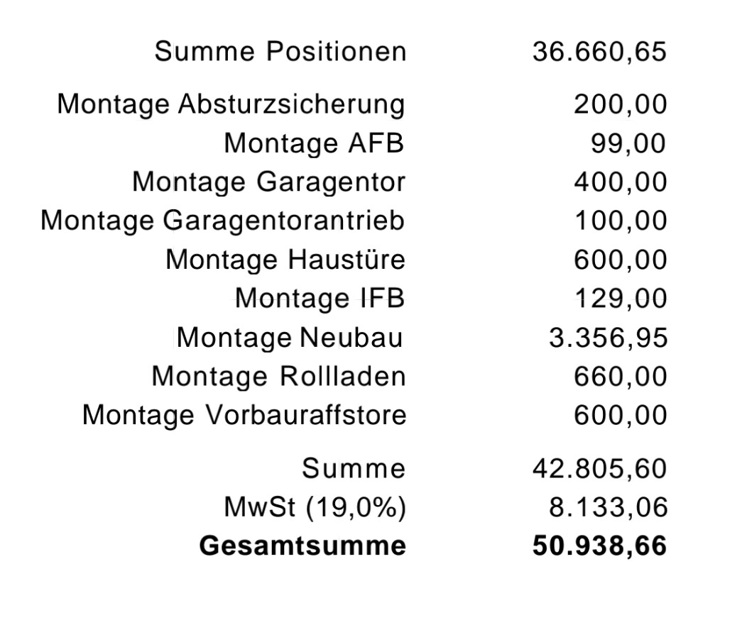

chamäleon9 May 2021 08:37Our current window offer for a total of 24 windows includes installation costs of 3,350 EUR net.
chamäleon9 May 2021 08:52S
Spiegel999 May 2021 09:30chamäleon schrieb:
This is how our offer is put together. Including a 4m (13 feet) lift-and-slide door, external venetian blinds on the ground floor, roller shutters on the upper floor, aluminum front door including sidelight, and garage door. The windows are anthracite-colored uPVC from Weru.
Many thanks to you for this! It’s helpful to have a comparison to see!chamäleon schrieb:
Our current offer for a total of 24 windows includes installation costs of 3,350 euros net.If the installer was already able to include their trade margin beforehand, then this is an apples-to-oranges comparison.https://www.instagram.com/11antgmxde/
