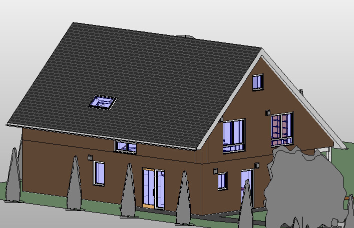

I’m not sure if this exists. The question is, what are your ideas? How high should a knee wall be at minimum? We are currently planning with a 1m (3.3 ft) knee wall and a 45-degree gable roof. Of course, I can raise it, but it’s always a matter of cost. How high should the knee wall be nowadays so that the rooms on the upper floor can be used effectively?
Thanks in advance for your tips.

Thank you for the responses. Well, just two full floors probably won’t work cost-wise. But from what I understand here, it’s better to have a knee wall higher than 1 meter (3.3 feet). I’ll have to check how much raising it would cost. I’m thinking of a knee wall between 1.20 meters and 1.30 meters (4 feet and 4.3 feet).

I don’t disagree with that. But compared to adding an extra square meter of living space by increasing the building footprint, isn’t it still relatively affordable? For a 10 m (33 feet) long house where the knee wall is raised from 1 m (3.3 feet) to 2.8 m (9.2 feet), that would at least add 10 square meters (108 square feet) of living space. Are skylights possibly more expensive than regular windows? (I don’t know) – of course, this comparison isn’t perfect, since even the space under a sloped ceiling is fully usable and livable, for example if there’s a bed placed beneath it.
