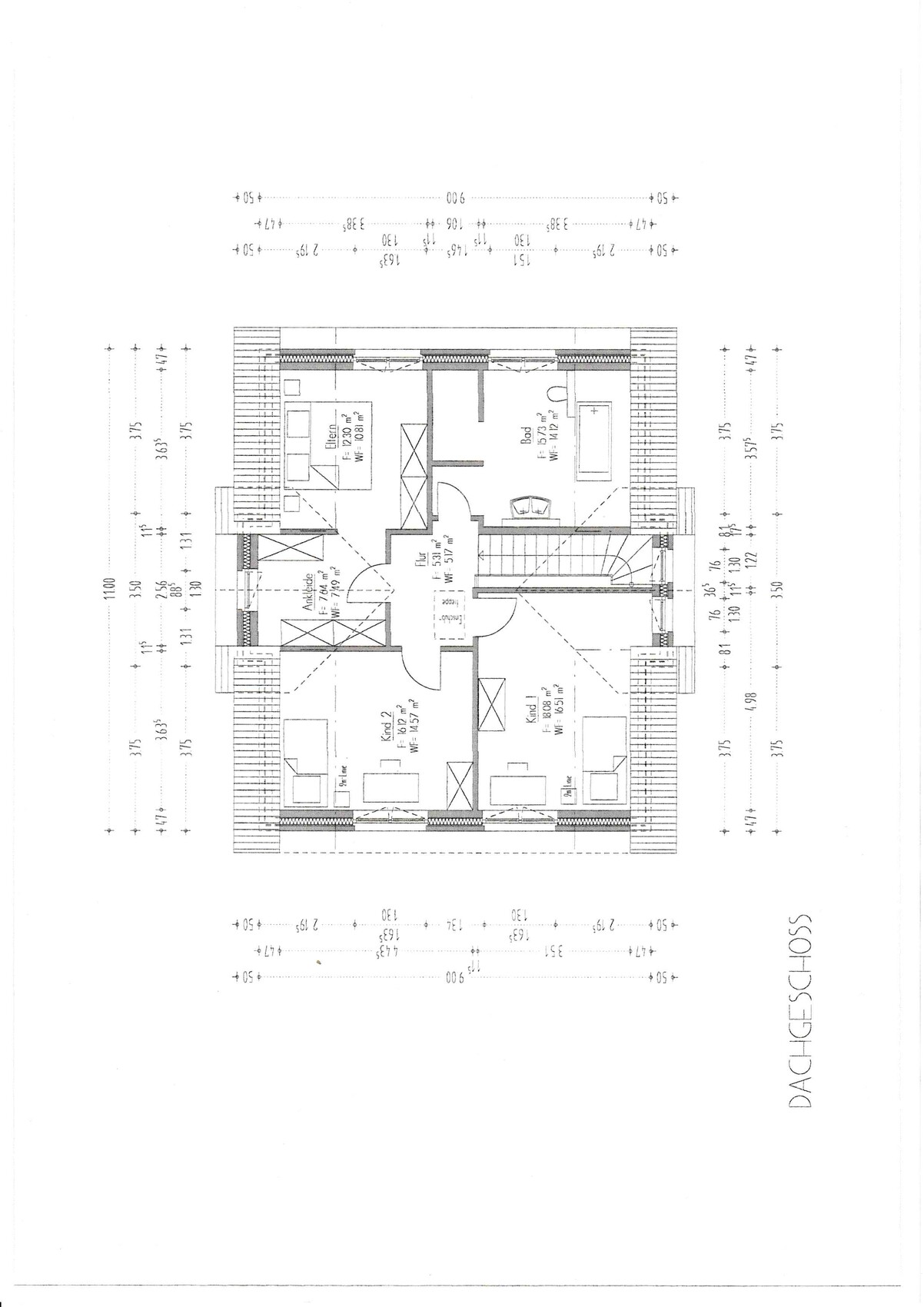

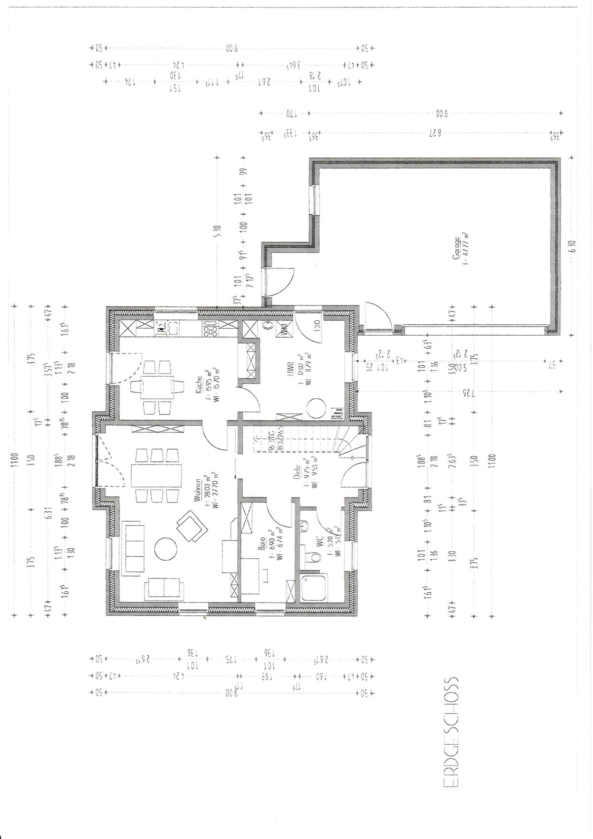

Hello, are there measures beyond the usual options to avoid exceeding the value mentioned in the subject? The common approaches involving roof slope and knee wall height are well known, of course. Our planner is currently somewhat unsure as well. Is it possible to measure from the top of the interior wall? After all, the walls are 47cm (19 inches) thick. Or could the stairwell be excluded from the ceiling height of 2.20m (7 ft 3 in) on the upper floor, and so on? We have two bay windows that are included on both sides in the calculation and are already important to us in the floor plan. Increasing the house width from 9 x 11m (30 x 36 ft) to 9 x 12m (30 x 39 ft) reportedly made no difference according to the builder. However, the bay windows also became wider at the same time.
Ground floor plan: living room, kitchen, office, hallway, WC, storage room and garage
Attic floor plan with staircase, hallway, several rooms, bathroom and balconies

Seriously, how much are you exceeding the limit? Ever calculated it? Hopefully, we are not talking about 5cm (2 inches) in knee wall height and therefore need a complete redesign. Otherwise, I would sooner consider extending the utility room behind the garage. That wouldn’t even be visible from the outside.
By the way, what is that strange corner on the garage supposed to be for?
We planned with a 1.01 meter (3 ft 4 in) knee wall height and have now ended up at 75cm (30 inches) based on the calculations. We then increased the house footprint to 9 x 12 meters (30 x 39 feet) to disproportionately enlarge the ground floor compared to the upper floor. That did not work though. The lateral bay windows also grew accordingly (for aesthetic reasons).
Regarding an extension of the utility room, our developer said that no flat roof could be put on because otherwise the space would not count as living area. We only briefly discussed this, so maybe I misunderstood something.
The corner on the garage was made to still allow easy access to the house. The garage is built on the property boundary. With 9 meters (30 feet) length, we already hit the maximum and had to keep a 3 meter (10 ft) setback from the boundary with this small section.

It requires a single-story building with a maximum eaves height of 4.50 meters (15 feet).
The developer is concerned because the space — if it is built in the garage and possibly walled off — doesn’t really count towards the main living area. The room is located in an outbuilding.
If the utility room is pushed out and enlarged directly, it would look different, in my opinion.

Can someone tell me if the staircase is included in the calculation of the living area on the upper floor? We’re not allowed to exceed two-thirds of the ground floor area. The height above the staircase is, of course, over 2.20 meters (7.2 feet). Our builder has currently included that area in the calculation. With the staircase dimensions of 3.75 by 1.2 meters (12.3 by 3.9 feet), that would be about 4.5 square meters (48 square feet) deducted upstairs—unless I also have to subtract it from the ground floor.

Tx-25 schrieb:
Can someone tell me whether the staircase is included in the calculation of the living area on the upper floor?
I don’t know. But I can tell you that living area does not matter when determining a full storey; instead, the gross floor areas of each storey are used—meaning the area based on the building’s exterior dimensions. Staircases are treated so that their floor plans are projected onto the floor level of the storey they lead to—essentially, the stairwell opening is imagined to be filled in with the stair steps.
Tx-25 schrieb:
Our developer has currently included the staircase area.
Then they acted correctly.
Tx-25 schrieb:
Unless I have to subtract it again on the lower floor.
No, the area counts fully on both floors because there is a dormer above the staircase.
Tx-25 schrieb:
Since we have to keep a 3-meter (10 feet) distance from the neighboring property, I can’t really create much more floor space in the utility room on the ground floor.
I see the following options:
1. Simple, quick to implement, and cost-saving: omit the dormer above the entrance
2. Simple, quick to implement, but expensive—assuming the building envelope allows it: add a conservatory within the thermal envelope
3. Possibly complicated: redesign the utility room, provided that the building envelope or other regulations (which we don’t know—hint: maybe upload the zoning plan here) don’t prevent it
4. Time-consuming and costly: see @ypg: larger house with the knee wall unchanged, adding a dormer at the original knee wall height
5. Dream house gone: leave it to the developer; low knee wall and shallow roof pitch
