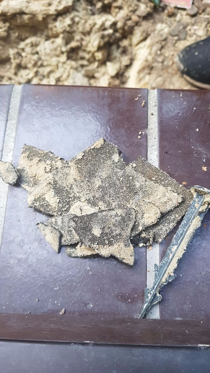

R.Hotzenplotz13 Sep 2017 18:42In the meantime, an unsuccessful leak detection was carried out, and a rainwater drainage channel was inspected. According to the expert, the next step is to excavate around the house to check underground pipes and the building insulation for damage.
Unfortunately, the building insurance no longer covers this. The excavation will cost approximately €1,000 (about $1,100) plus the fee for someone to inspect the exposed areas. Does anyone know if the homeowners' association covers this? Or do I have to pay for it myself and possibly recover the costs later from the homeowners' association if damage to the individual property is confirmed?
