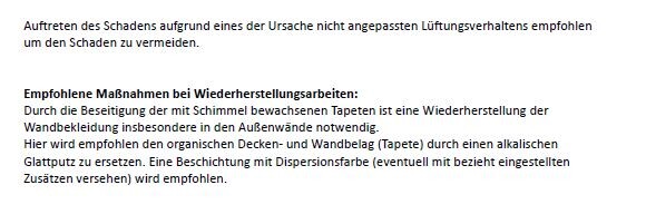

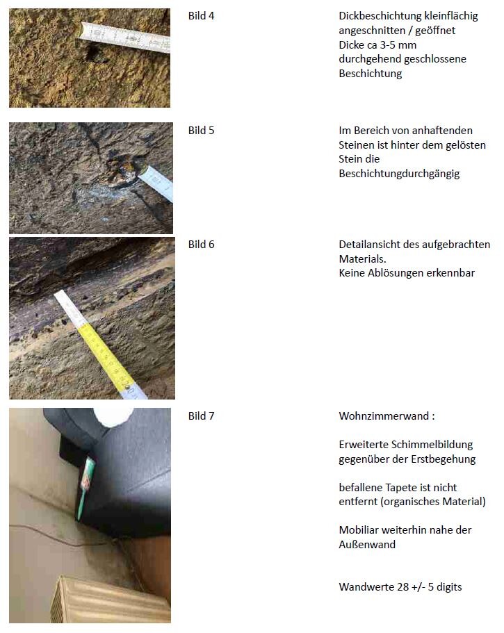

my tenant sent me the following photo from my basement apartment. Apparently, there are moisture problems.
This concerns an exterior wall.
What is the correct procedure here (four-family house with four owners)? Should I first hire a building expert at my own expense to determine the cause (it could also be due to incorrect ventilation, etc.)?
How would you proceed in this situation?

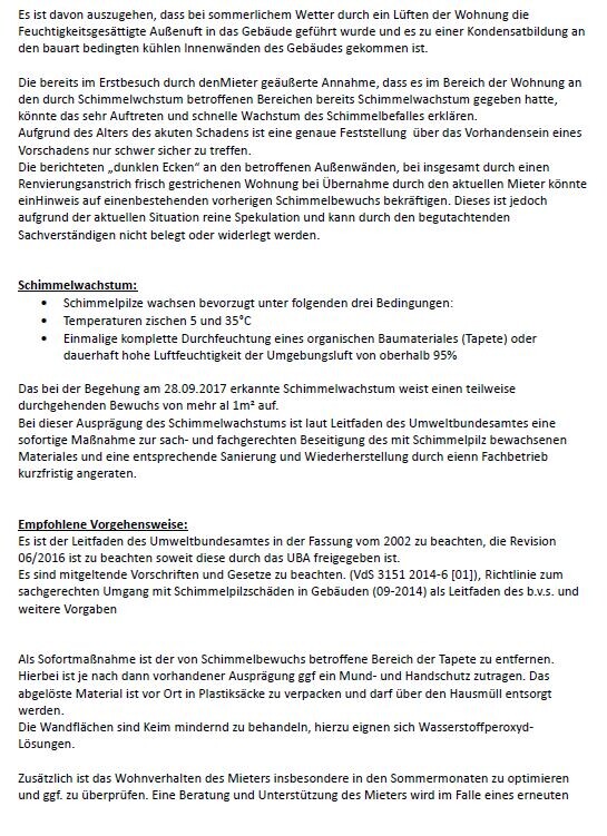

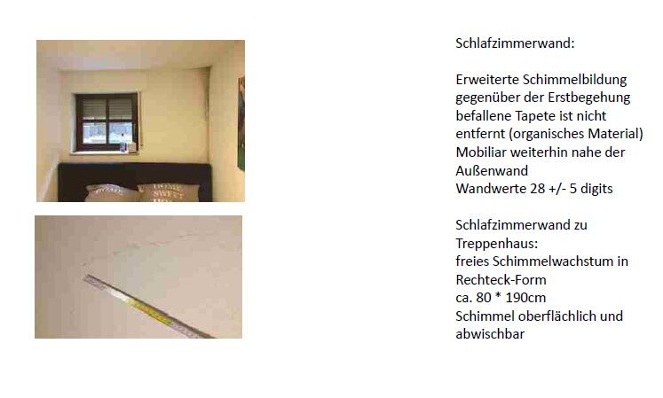

R.Hotzenplotz2 Oct 2017 06:18So it probably isn’t due to the insulation but rather the tenant’s behavior. However, this is likely not a valid reason for compensation. Even though it is frustrating that, according to the report, he still hasn’t moved his furniture away from the wall. That will be costly!
I’ll probably have to draft a comprehensive additional agreement to the lease contract outlining what he is not allowed to do.

R.Hotzenplotz2 Oct 2017 11:34Steffen80 schrieb:
What a mess... If I were your landlord, I'd have a thing or two to say to you.That's what the inspector told me. What am I supposed to do? I can't renovate only for the mold to come back again.....

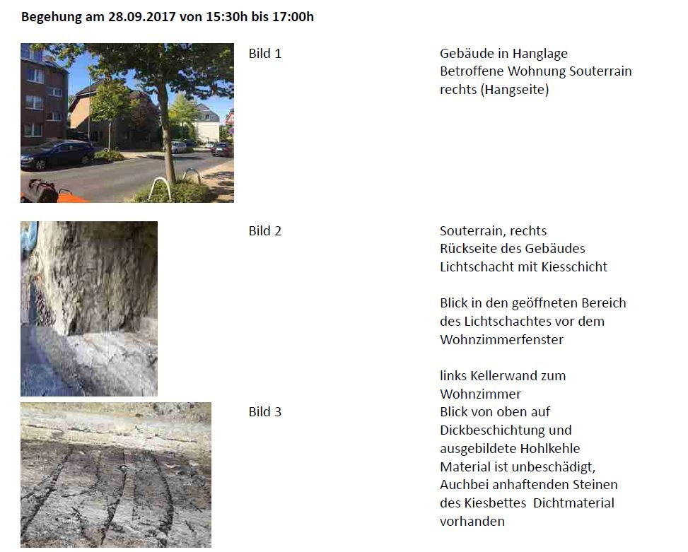

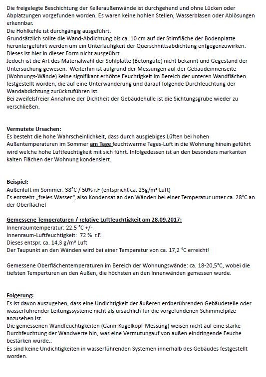

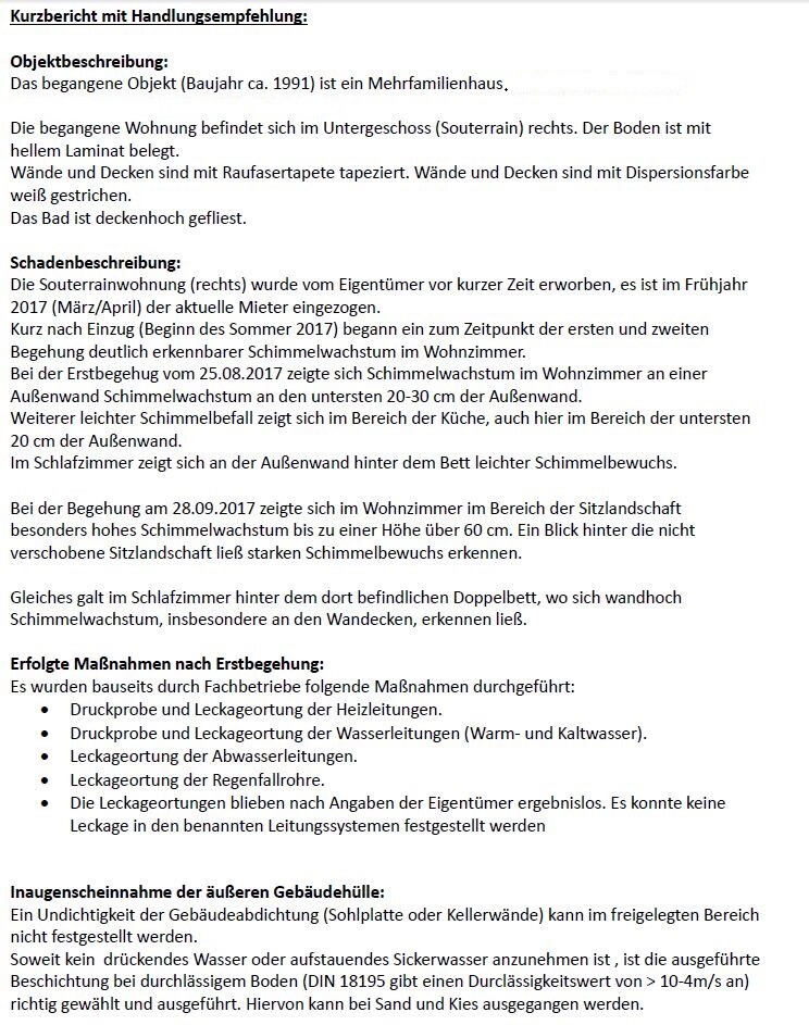

In my opinion, the report is not really accurate. The mold is supposed to result solely from (excessive) ventilation in the summer? Sure, warm summer air has high humidity—but that alone wouldn’t cause damage to that extent! Something must be wrong with the building structure. I suspect the insulation is insufficient or defective. That would also explain the increased mold growth in corners and near the floor.
If I were your tenant, I wouldn’t stay in the apartment a day longer. This level of mold infestation is seriously harmful to health!
