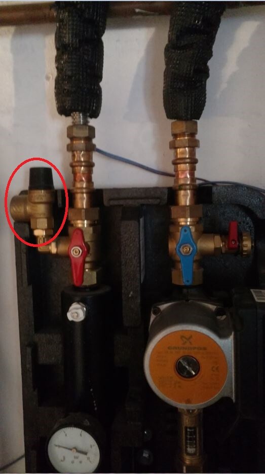

I’m starting to get really frustrated... (My heating engineer is running out of ideas too). Unfortunately, none of the previous measures have helped, or at least not in the long term. --> Installed an air separator on the combined storage tank, flushed the system again, and everything worked perfectly! After a short time, you can observe on the temperature display of the controller (ESR) how the temperature of the storage tank (the heating device was completely switched off at that time) drops, even though the roof is clearly providing sufficient temperature. I suspect that an air bubble forms at some point, and eventually, nothing works anymore?
My heating engineer would like to disconnect the pipes at the top of the collectors and flush the modules directly without the pipes, as well as flush the disconnected pipes from the attic downwards.
I still suspect the problem lies in the routing of the pipes, which go up to the ridge and then back down again, meaning the collector is not (as is usually the case) the highest point of the system. Would it be possible to install an air separator inside the piping (i.e., below the roof ridge)?
