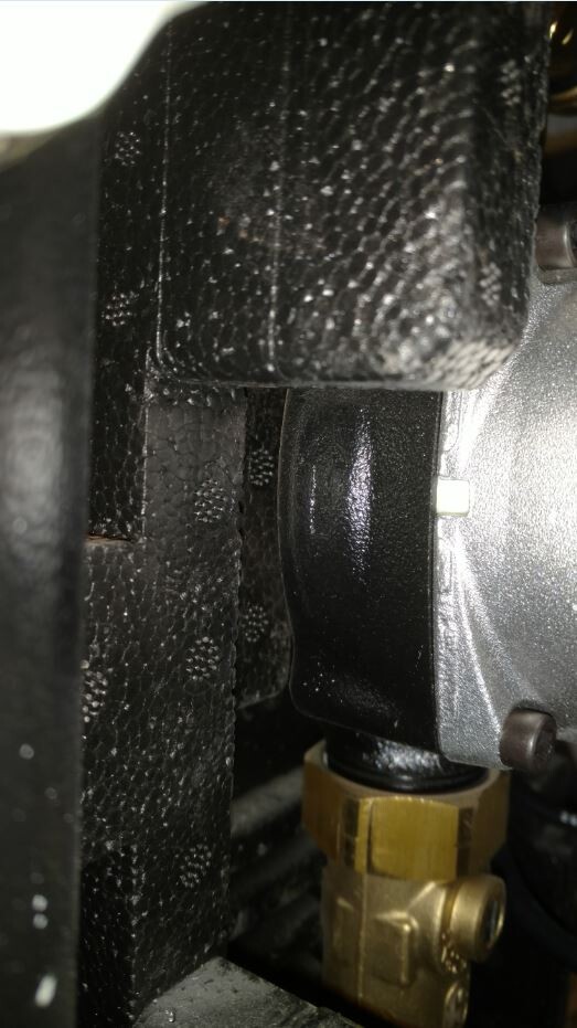

Henny071028 Feb 2018 14:19Maybe a silly question, but could the Taco Setter possibly be installed the wrong way around? Does it have an arrow indicating the flow direction?
wrobel schrieb:
There is an arrow molded on the side of the pump housing; you might want to double-check. I checked again (see pictures attached, unfortunately not very clear...), the arrow points upwards, which should be correct for the return flow, right?
