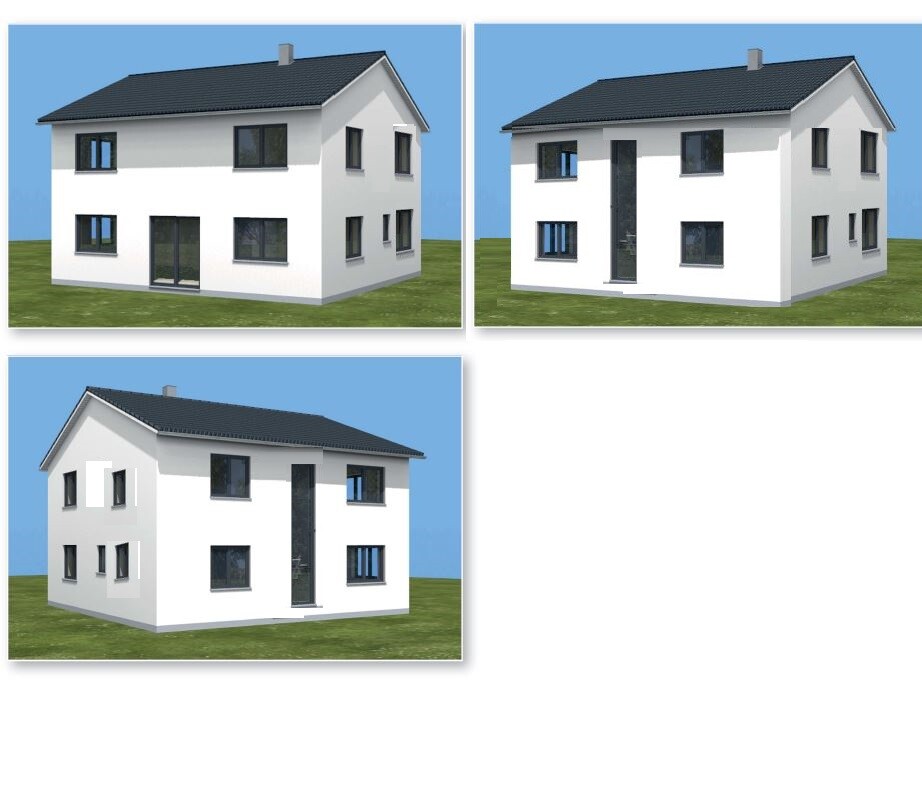

Exterior view; I put together the far right one myself, as we didn’t have a colored version of it.

House exterior views in the terrain

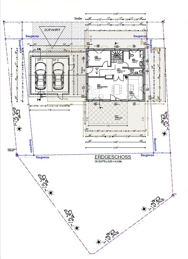

House position on the plot + ground floor layout

Lisa24 schrieb:
I wanted to ask you to take a look and share your thoughts on it. If you resize the images to a readable size, sure.
Well... boring is relative. The windows actually fit the rooms quite well.
Ground floor: Large bathroom and toilet? Why?
Ground floor: Kitchen... I would choose a layout that includes terrace access from the kitchen itself. The access near the dining table might sometimes be inconvenient. So, plan the kitchen with a proper island rather than a small one, and omit the lower section of the floor plan.
Ground floor: The dimensions are not visible, but I would not limit the hallway’s wardrobe area to just a small section. Instead, consider extending the wall to the living room fully along that side to provide enough space for all coats and shoes. This way, you don’t have to rearrange seasonally.
Upper floor: Master bedroom... is the bed really placed under the window? Unfortunately, the sill height and other details are not visible. On the east side (right on the plan), I would consider installing a narrower window between the planned wardrobe and the bed.
Upper floor: Bathroom... I would also consider placing the toilet at an angle, which might allow for better planning of the washbasin area.
