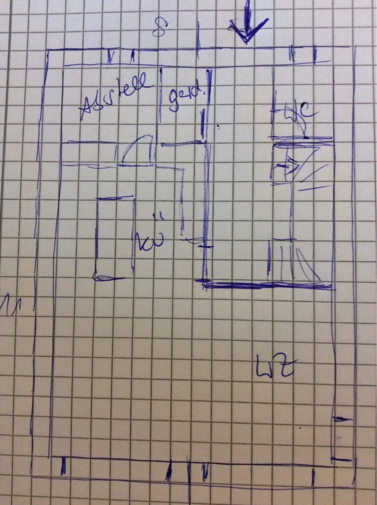

I sketched something out, even though I’m not currently in a creative phase.

Regarding the shower on the ground floor: we only have one bathroom upstairs, but we want both of us to be able to shower in the morning... Also, this serves as an "emergency shower" in case we can’t manage the stairs anymore. My sofas always have a sleeping function. So if one of us breaks a leg (or something similar), they can sleep, shower, and eat. In an emergency, some clothes can also be stored in the wardrobe.
Do I understand your floor plan correctly, with an open staircase? And then between the living room and hallway without a wall? Otherwise, the hallway would be completely dark...
By mirroring the kitchen and staircase/bathroom, the missing window on the ground floor wall now faces the staircase, which receives light from the windows upstairs. The kitchen can have windows on the west side.
I need to let this sink in.
Thank you very much!

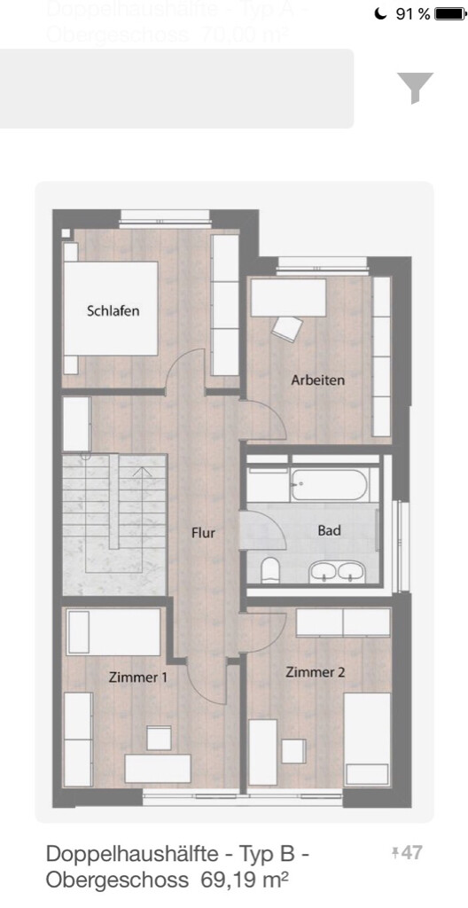

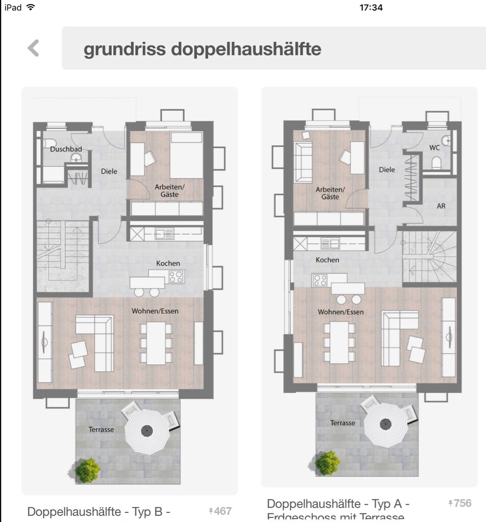

Or you can also find nice examples on Pinterest.
If you really want a stair with a landing, maybe the left suggestion could work? The guest room can be made a bit smaller to create more space for the wardrobe or kitchen. Of course, this floor plan would be mirrored vertically so that the dining and kitchen areas are on the west side for window exposure.
Upstairs, the office could then become the walk-in closet.
Source: Pinterest, Schultheiß-Projekte
Regards
Regards

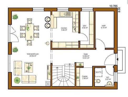

The kitchen feels too open to me. Having the kitchen open to the living/dining area around the corner is fine, but walking through the kitchen to get to the living room is really too much.
However, I found this floor plan on Pinterest—what do you think? The dimensions are almost exactly ours... I would enlarge the bathroom slightly at the expense of the cloakroom to fit a nice large shower. There would still be a cloakroom niche.
I would swap the utility room for the pantry and extend the kitchen up to the former pantry wall. The utility room is still large enough for two doors so that supplies can be accessed directly from both the entrance and the kitchen. On the entrance side (currently the utility room), I can also imagine a small window for aesthetic reasons from the outside. The kitchen/pantry windows can be combined into one larger window, which should be sufficient.
Would it be possible to position a large corner sofa nicely in the living room, or is there not enough wall space for the TV? I would prefer not to have the sofa in front of the window because then you wouldn’t be able to look out into the garden.
This layout would have to be mirrored as well.
A landing staircase isn’t absolutely necessary but would certainly be more practical for bringing larger items upstairs or as you get older (keyword: stairlift).
