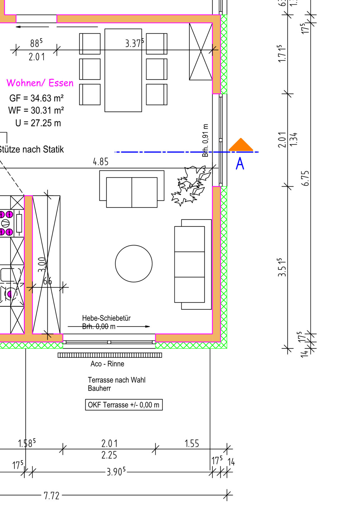

We are currently considering how deep the patio roof should be so that we can still sit outside during a summer shower.
In the model home park, we saw recesses into the house that were 1.50m (5 feet) deep. This seemed insufficient to us intuitively.
We will also have such a recess in the house. Do you have any experience or recommendations on how deep this recess, meaning the roof extension, should be to provide enough protection from a shower?

If you have other large windows on that side, it might work... but for me, without them, it would be too dark...So there would still be a 3m (10 feet) sliding door on the south side and an east-facing window 180cm (71 inches) wide. We also only have a 2-meter (6.6 feet) window facing east, 1.35 meters (4.4 feet) high. As I said, it still works well for us, but we also have transparent panels. The roof extends over a large area.
You have additional windows, so it should work. However, someone with a similar roof design might be able to provide better advice.
As I mentioned, I only know from my neighbor’s place. It seems quite dark to me there—they also have only one other east-facing window, which is even single-leaf with a pleated blind and a flower box on the windowsill.
