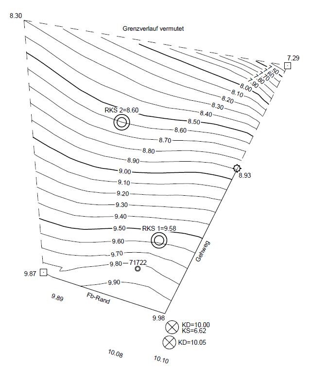

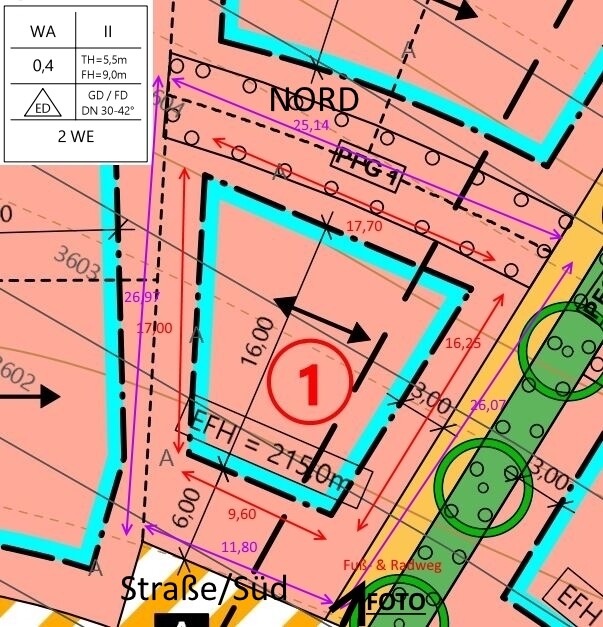

I have bought a plot of land with a slight slope (see attachment).
The plot measures approximately 25m x 26m x 11.8m (39ft x 43ft x 39ft) x 26.9m (88ft).
The building area is 9.6m x 17.0m x 16.25m (32ft x 56ft x 53ft) x 17.7m (58ft).
I like a house with exterior dimensions of about 10.4m x 10.4m (34ft x 34ft).
Question 1: with or without a basement
There is about a 2m (6.5ft) height difference within the building area. Which solution (with or without a basement) is better? According to the builder’s estimate, a usable basement would cost around 80,000€.
We don’t need much space, but we would prefer not to have our house lower than street level.
Question 2: Carport/outdoor area
At the moment, I prefer the solution without a basement. Now the question is where to position the carport (and the house). The more I move the house toward the north, the more I have to fill in.

hampshire9 May 2019 07:581. Don’t build a basement if you don’t need one.
2. Between “backfilling” and a full basement, there is also the option of a partially open or open version. For example, you can have a sheltered parking space simply under the house instead of a carport.
3. Sketch the outdoor area in advance – places to sit, paths, sightlines. You can implement this after construction.

immermehr schrieb:
slight slope (not much) immermehr schrieb:
about 2m (6.6 ft) height difference within the building plot So which is it?
Zaba12 schrieb:
because they underestimated the slope Underestimating is not good; you definitely need to take it into account and budget accordingly. However, for a 10.4m (34.1 ft) high house, the difference here is about 80cm (31.5 inches), or about 1.1m (3.6 ft) including the terrace. So even without a basement, it’s manageable. Now you need to check where the height reference points are for the single-family house, the eaves, and the ridge (is this the 215.5m (707.7 ft) contour line at the southern property boundary?) and where the completed questionnaire is located.

Underestimating is bad, so definitely take it into account and budget for it. However, for a 10.4m (34 feet) house here, it’s about 80cm (31 inches), with the terrace about 1.1m (43 inches). So even without a basement, it’s not a problem. Now you have to check where the reference heights are for the single-family house, eaves, ridge (is that the 215.5m (708 feet) contour line at the southern property boundary?), and where the completed questionnaire is.I haven’t looked exactly at the contour lines yet. 2m (6.5 feet) within the building envelope sounds quite substantial at first.About my neighbors: well, when the sales rep says: “You don’t have a slope” or “It won’t be that expensive,” that’s exactly when things go wrong.
If it really is only 1.1m (43 inches), you can easily handle it with a slope and 50x50cm (20x20 inches) L-shaped concrete blocks from a hardware store, if you’re up for that.
