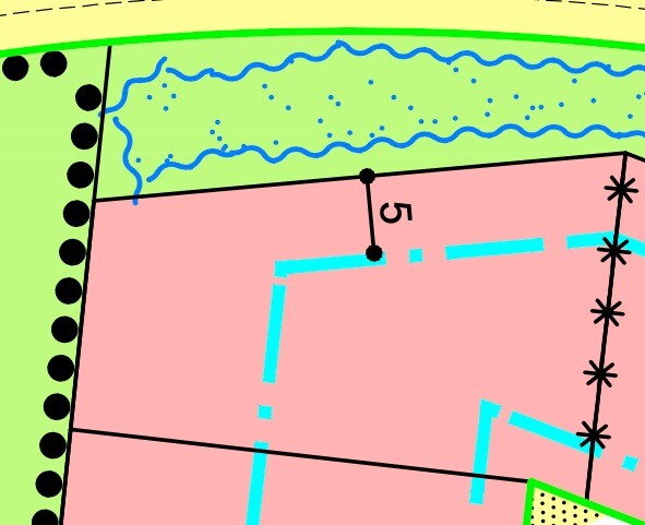

Building window, building line, and boundary: see attachment

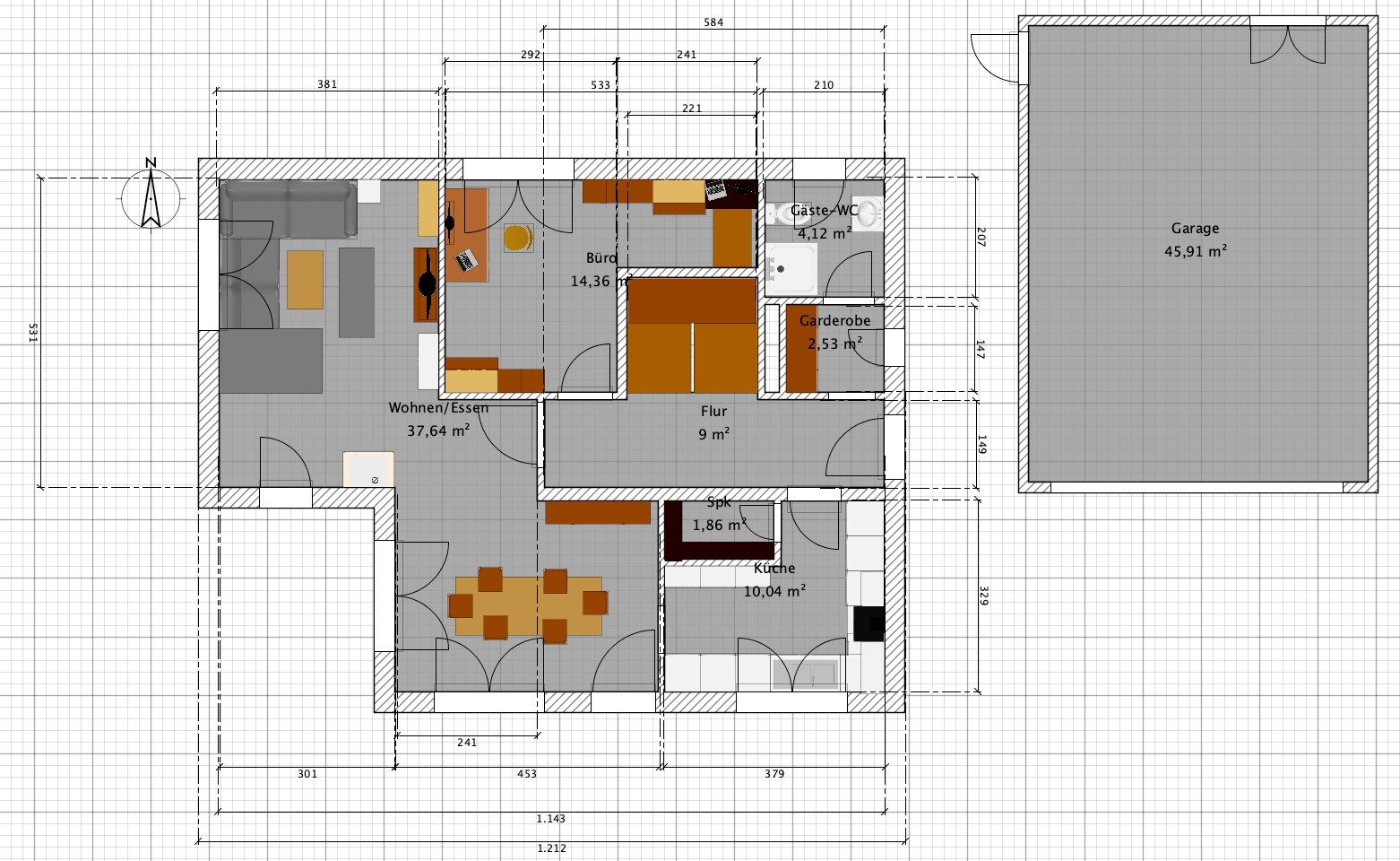

Space requirements on ground floor (GF) and upper floor (UF):
GF: Kitchen (with pantry), dining/living, office (convertible to bedroom later), guest bathroom with shower, cloakroom
Office use: Home office 3 days per week
Guest sleepers per year: 2
Open or closed layout: rather closed
Conservative or modern construction: feels modern
Open kitchen, cooking island: L-shaped kitchen
Number of dining seats: 4 normally, expandable to 8
Fireplace: yes (but could be dropped)
Music/stereo wall: no
Who designed the plan:
- Designer from a construction company
What do we particularly like?
All requirements are covered:
Living area should be at least approximately 3.8 m x 3.8 m (12.5 ft x 12.5 ft) so that existing furniture fits and we feel comfortable.
The dining area should be connected but not a narrow corridor. The first plan had living/dining combined in a 9 m x 3.5 m (30 ft x 11.5 ft) space, which we have seen at friends’ houses, but it doesn’t feel comfortable or easily furnished to us.
We tried to optimize some square meters to reduce the cost.
The office should, in later years, be able to hold a 3 m (10 ft) wardrobe and a double bed.
What do we not like? Why?
The fireplace would be nice but might make the passage between dining and living too narrow, which could be risky with a child when the fireplace is in use. The pantry could be a bit small.
Cost estimate according to general contractor:
470,000 including basement (one room finished), controlled mechanical ventilation, air-source heat pump (eligible for subsidies), laundry chute, KfW 55 standard without deduction of subsidies, without garage.
Personal price limit for the house including fittings: basically already reached with this.
Preferred heating technology:
Air-source heat pump
If you had to give up something, what details or extras could you do without?
- Can give up:
Basement finishing, fireplace
- Cannot give up:
Controlled ventilation, laundry chute, smaller size not possible
Why is the design the way it is now? For example:
This is the third iteration in which all requirements are met for the first time.
Where could optimization still be possible? For example, the passage around the fireplace?
Is the dining room wide enough to pass by comfortably?
Would a different staircase shape help?
We generally like the floor plan very much but are a bit frustrated because it’s not really spacious for the budget.
There is a concern that it might end up too small.
The upper floor is slightly smaller, rectangular. The "bay window" at the living room is removed.
A few words about the location / development plan / building window:
Access to the garage would be through the small section in the southeast. This is a residential street.
To our north, a slightly larger road is planned, but it will only serve traffic to the new developments.
North of that road is open field and likely will remain so for the next 15 years.
We are at the northwest edge of the building area; a nature reserve (forest) starts to the west.
The north arrow in the (redrawn) plan is incorrect. The plan should be rotated ca. 10–15° clockwise.
At the northwest corner, we already touch the building window, as well as on the eastern side with the garage.

saralina8717 May 2020 10:50Is it intentional that you only uploaded the ground floor?

morgenstern17 May 2020 11:11Yes, it is intentional that the upper floor is missing.
Above, we have a first draft, which is good enough for an initial version.
The plan for the upper floor is to include two children's bedrooms, one master bedroom with a walk-in closet, and one bathroom.
From a space perspective, it is simpler, so for now we are focusing on the ground floor.

saralina8717 May 2020 11:15I’m afraid you won’t get many constructive responses here without an associated upper floor. Generally, people say the upper floor should be planned before the ground floor (it has to do with the staircase).
