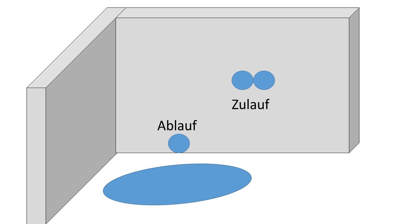

I am currently in the process of choosing a bathtub.
The current situation regarding the connections can be seen in the attachment.
If I understand correctly about freestanding bathtubs, I can’t use one now because my drain is located on the side?
Are there any solutions for this?
Thank you very much.
Whether it is beside and above the finished floor level or below the finished floor level is crucial.
However, I have a freestanding bathtub where the drain was planned and installed below the tub. That is why I don’t understand what went wrong here. Was the freestanding bathtub not fixed from the start, or was this not communicated?
