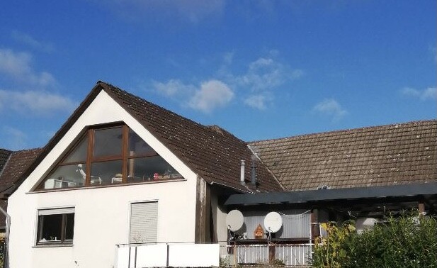

We live in a location that’s perfect for us, in a small town on the beautiful main street. We have a corner plot with a large garden facing south (picture 4). This means that on the north side you are close to the action, while the garden remains peaceful.
