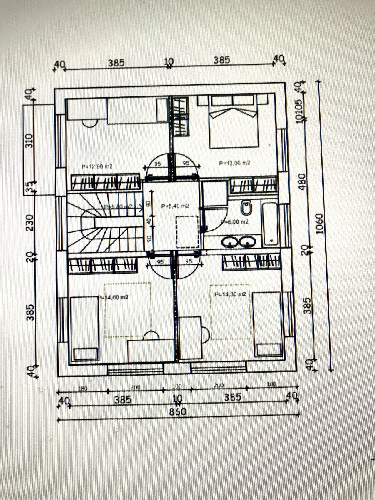

Upstairs, we would like natural light in the hallway, two children's rooms of about 13-14 m2 each (approximately 140-150 sq ft), facing south, and a bedroom facing northeast, where we need to place my wife’s Ikea PAX wardrobe measuring 200x70x240 cm (79x27.5x94 inches). In the bedroom, my wardrobe should also be placed, but it can be smaller than my wife’s.

It may be that 3.85 meters (12.6 feet) could still work, but the claim that 4.00 meters (13.1 feet) or even more is structurally impossible is really nonsense. I managed to get 4.29 meters (14.1 feet) without a lintel or anything similar. And that was from my general contractor, who usually had difficulties with my requests.Thanks for your response. The latest floor plan version has two children's bedrooms of about 16 square meters (172 square feet) each. I wanted three similar children's bedrooms, so I suggested reducing the size of the two bedrooms on the south side. The architect said he would have to automatically reduce the living/dining room downstairs because of a load-bearing wall.
prm2021 schrieb:
The architect said that the living/dining room would have to be automatically reduced downward due to a load-bearing wall.I assume this means that a wall in the living room has to be moved because otherwise, a wall upstairs would not be properly supported above. One possible solution could be to build the relevant wall upstairs as a lightweight partition wall instead of a masonry wall.https://www.instagram.com/11antgmxde/

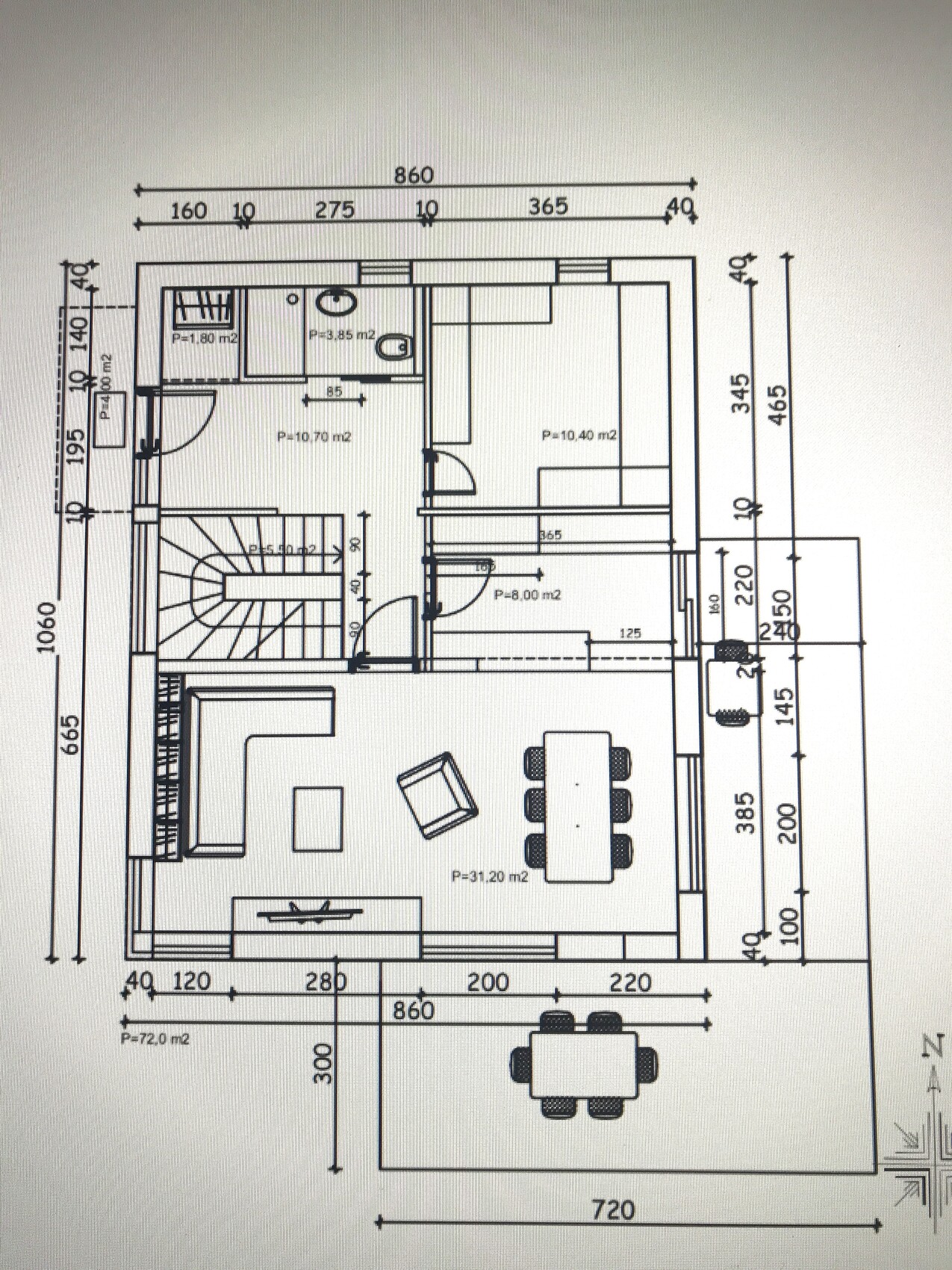

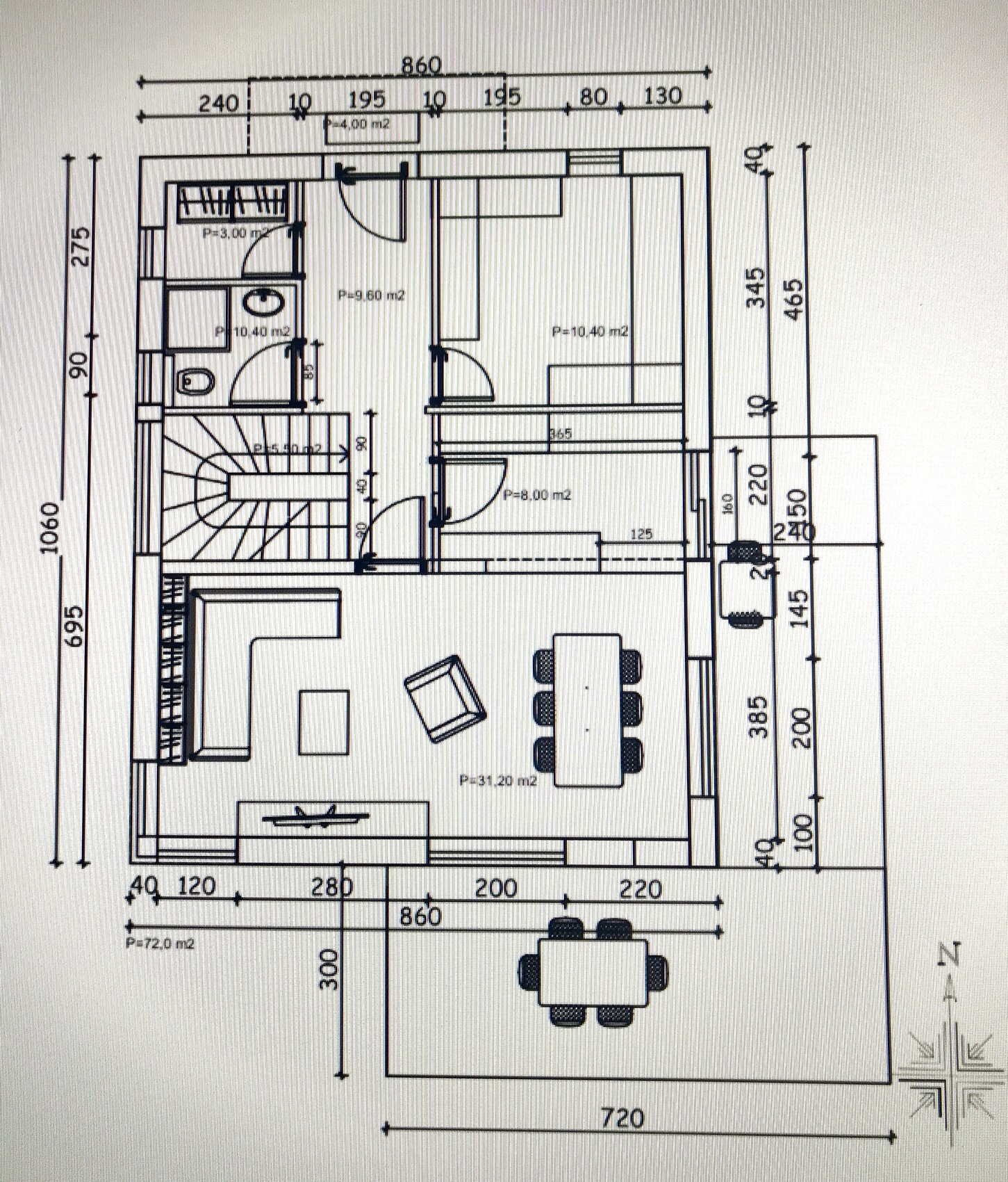

Hello, the architect has sent a new version of the floor plan with many issues 🙁. He didn’t enlarge the living room to 4 m (13 feet), added a door to the walk-in closet, wrote down the wrong size for the guest toilet, etc.. 🤨
There are two versions for the ground floor: entrance from the west and entrance from the north.
We will reduce the size of the children’s rooms using a lightweight partition wall (KNAUFF) to enlarge the bathroom.
I will speak with him, and until then please help us finalize the floor plan. So, I wanted a minimalist two-line kitchen (with a peninsula) and a double-door refrigerator. Is that possible? Maybe a single door leading outside or a large window?

The architect sent a new floor plan version with lots of errors.How does he even manage to include errors? Would you like to just redraw those errors yourself to fix them?

We will reduce the size of the children's rooms using lightweight partition walls (KNAUF) to enlarge the bathroom.I’m afraid there’s a load-bearing wall there, so that won’t be possible. What materials are the walls built from? - Wall thicknesses of exactly ten centimeters (4 inches, 20, especially 40) I’m not familiar with as standard.
For heaven’s sake, remove the corner window next to the TV and replace that window with one like on the upper floor. As it is now, it’s a disaster and the structural engineer will really have some words for the drafter.

Hello everyone. I’m definitely not a floor plan expert, but what immediately stands out to me is that the designer seems to have some issues with the doors. In the first draft for the ground floor, there appear to be three different door sizes – or is it just an illusion? The utility room (or is it an office?) has a tiny door. The kitchen door is a bit larger. The living room door looks normal.
A guest bathroom with a sliding door? I would think twice about that. We recently had one in a hotel, and let me just say: you really need to know each other well for that to work.
In the second draft, the guest bathroom does have a regular door, but how is it supposed to open when you’re inside? So, some of the door swings are going in the wrong direction, and on the upper floor, the doors are positioned so close to the wall that it’s questionable whether a baseboard can even be installed there.
