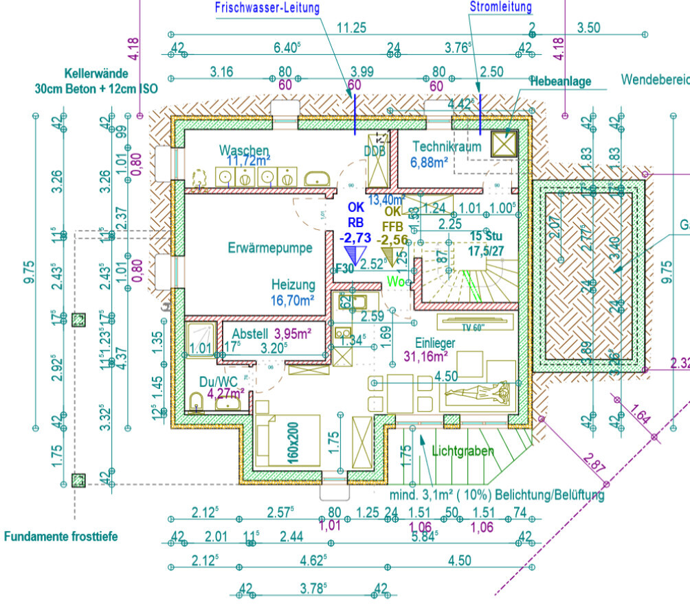

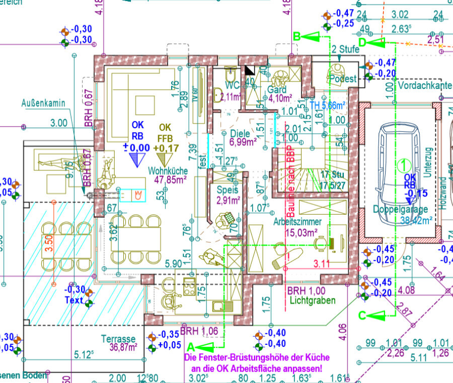

we are having a really hard time picturing the staircase based on our plan. According to the plan, there is a single-turn staircase from the ground floor to the upper floor, and a double-turn staircase from the ground floor to the basement.
However, the steps do not start at the same height (not the vertical height, but the staircase to the upper floor begins earlier; I’m not sure how to explain this better). Does this make sense? Also, the staircase to the basement seems very large to me. If there were no "U" shape, could that provide more space in the hallway?

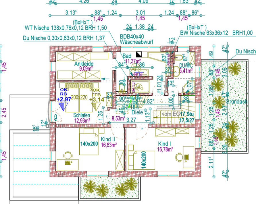

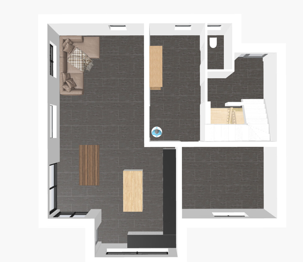

The waste chute has too dominant a position. For me, the pantry pushed into the floor plan is the biggest issue: the kitchen can’t be furnished properly and the dining table is obstructed. If you also straighten the entrance area by the office, the ground floor benefits from better sightlines and a more spacious feel. Then I see something at the window seat. A fireplace? Possibly that should be furniture and not fixed.
hanghaus2023 schrieb:
The bathtub is way too small. … as I said before: the dressing room is too narrow (for broad shoulders), the bathtub too small, and the shower in the kids’ bathroom is already just a corner shower.
What about the space at the staircase now? Can that space be used for a door?

It’s probably OK to reach the granny flat through a shared corridor. Well, it’s not really OK if the tenant has access to your cloakroom and thus your bag contents. No matter how honest someone is: opportunity makes thieves.
And they also have access to your laundry if you don’t lock the basement rooms.
Who is supposed to live in the basement apartment? I don’t want to live there permanently.
The right side has the light well (can you see a bit of the surroundings or just the slope?), and the left side has none at all. On the left side, the light will always have to be on.
Is there a ventilation system for the basement apartment? Because you can’t manually ventilate the sleeping area and the bathroom.
I have made an effort to bring some order to the plans, including the bathrooms. The measurements are not entirely accurate, as some rooms on the ground floor were only estimated.
Ultimately, I no longer have much patience, because when creating a hallway on the ground floor for the secondary apartment/wardrobe, I noticed that the tenant can not only walk into the wardrobe but could also access the entire upper floor, since the staircase is located in front of the basement stairs.
Therefore, I would strongly challenge the general contractor about what they were thinking.
Here are the corrections for the ground floor and upper floor (excluding the secondary apartment).
