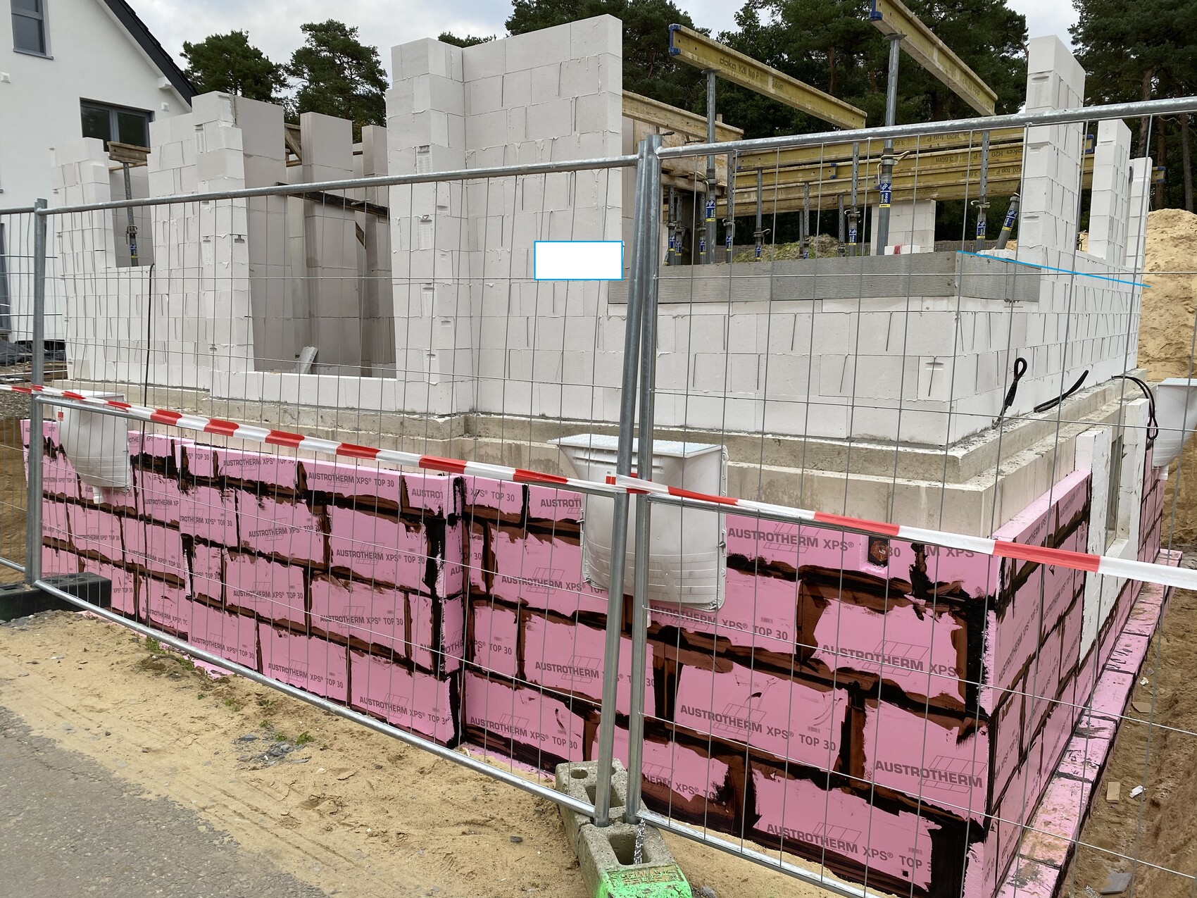

Baustelle mit weißen Betonblöcken, pinken Dämmplatten am Fundament, Metallzaun um das Gelände.

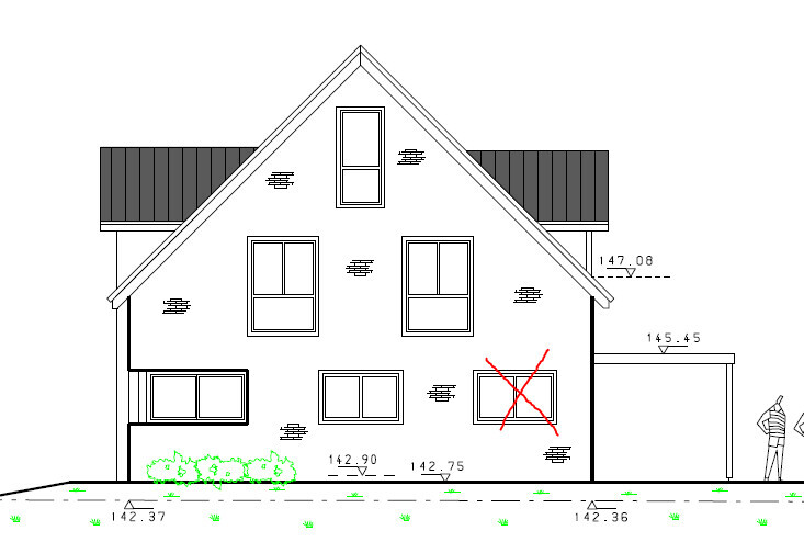

Then we could finally get a feel for the interior layout, and what can I say – we have way too many windows and too few exterior walls. We will now have this corrected by bricking up one window. That particular window had been a point of discussion anyway – it was recently added back into the design just before finalizing, but now it’s being removed again.
That way, we can place a nice display cabinet or hang a picture on the wall. Otherwise, this would have been barely possible in the combined kitchen/dining area.
Architekturzeichnung eines Hauses mit Satteldach, Fenster, Garten; Person rechts, rotes X am Fenster

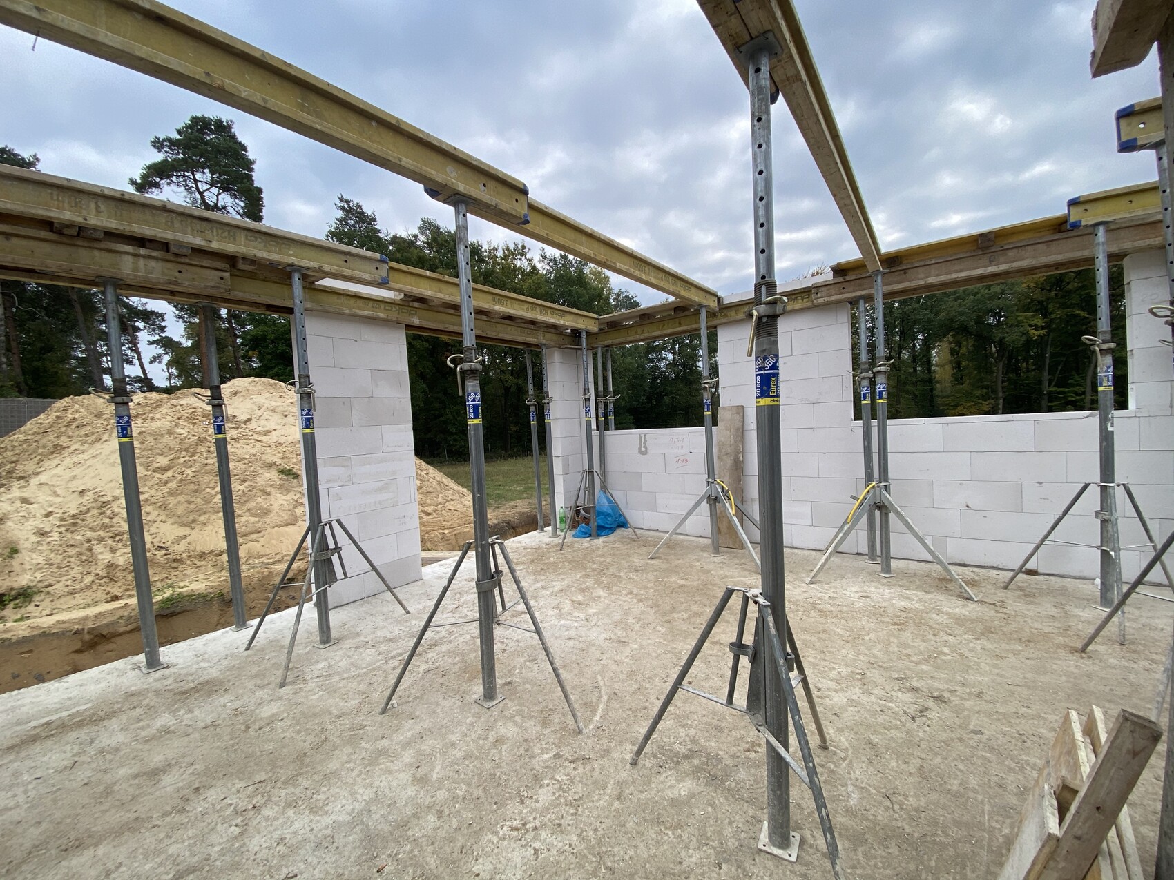

Baustelle: Innenraum mit weißen Betonsteinwänden, Gerüststützen, Holzbalken und Sandhaufen.

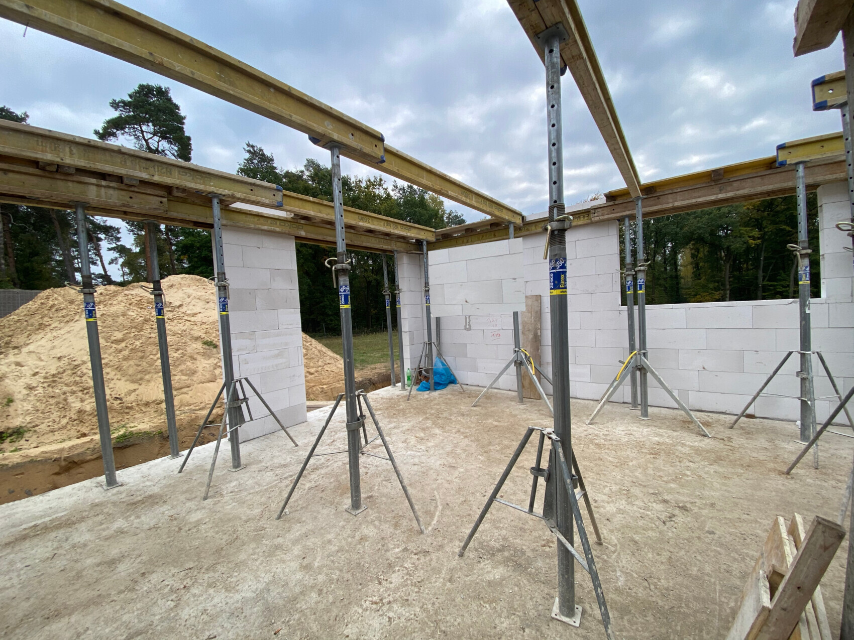

Baustelle mit weißen Blöcken als Wände, Stahlstützen, Holzbohlen und Sandhügel.
Now we just hope this decision turns out to be the right one. At this stage, closing off is definitely easier than reopening. The general contractor is still checking as a precaution whether they have the 150 extra facing bricks on site, and I have informed the energy consultant about the change as well.

OWLer schrieb:
We could place a nice display cabinet there or hang a picture on the wall.
The forest is actually the most beautiful "picture" you can imagine! So, I wouldn’t wall that space up but rather place a slim display cabinet between the two windows. Our floor plan is quite similar, except we even have floor-to-ceiling windows on the side. I really like it when I sit at the table and can look out into the garden instead of at a wall. And someone will always end up sitting with their back to the living room/sofa.
I think it’s good that the kitchen window is going back to a higher position. From the outside, it always looks untidy when you can see everything sitting on the countertop. Opening the window is also easier this way.
OWLer22 Oct 2020 16:22
Würfel* schrieb:
The forest is the most beautiful "view" you can imagine! So I wouldn’t want to block it off with a wall.
Thank you for your comment. The forest will remain, but the view will be obstructed by new construction.
In the long term, the view will either be the neighbor’s kitchen or carport. Then, we will only be able to see the forest a bit beyond the noise barrier through our three floor-to-ceiling windows facing east.

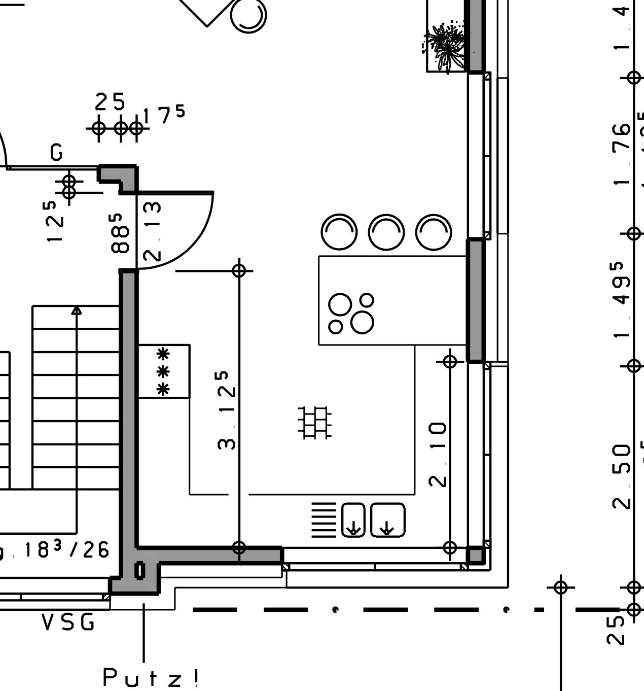

This week, we had the appointment with the window installer and site manager to discuss the usual what, how, where, and how much. In the kitchen, the faucet is located in front of the window, and so far it is not foldable. Contrary to the original plan, we will not be getting roller shutters but rather venetian blinds (raffstores) on the three kitchen windows.
Floor plan of an interior with door, stair area, dining table and chairs.
On site, we decided to go with fixed glazing on the two corner windows. Partly for aesthetic reasons, so the central mullion is removed, and partly for practical reasons, so we don’t have to worry about the faucet.

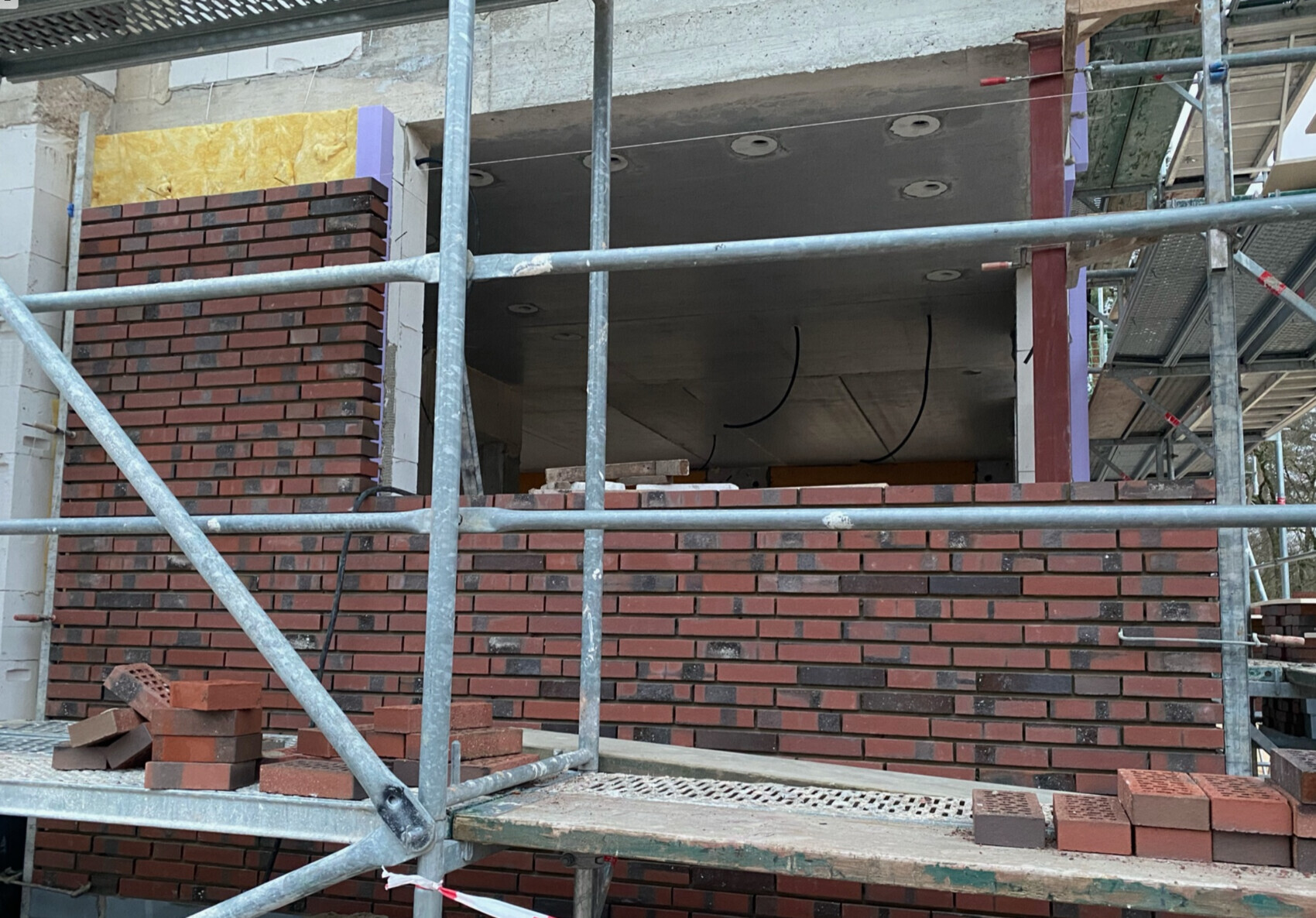

Scaffolding in front of red brick wall, construction work on facade, visible opening in building
Is this a bad idea?
Cleaning the windows from the outside is possible, and the venetian blinds can also be cleaned well this way.
We have a controlled residential ventilation system with exhaust in the kitchen and will be installing a recirculating range hood (KMDA by Miele) in the kitchen. Cross-ventilation will no longer be possible; the maximum ventilation will be through the upper window and the sliding door to the garden.
On site, the fixed glazing felt right, but afterward, I wonder if I might have overlooked something?
