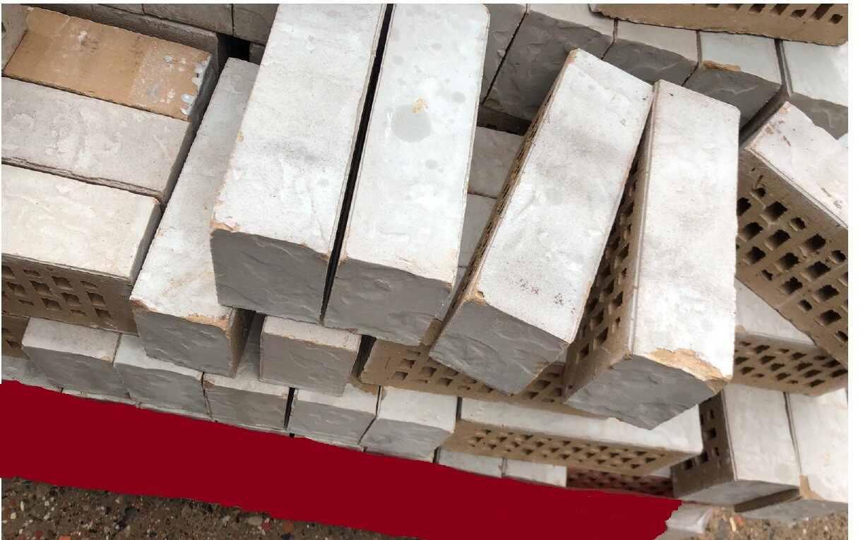

We ordered a clinker brick from a well-known supplier, which arrived after about 12 weeks.
Upon delivery, I noticed damage on one pallet. I contacted the seller immediately, who told me this was normal since it is a natural product and such damage can occur (without having seen it).
The next day, I went to the construction site with my wife. She immediately noticed the damage; I had been so busy I had forgotten about it, and she had no prior knowledge of it.

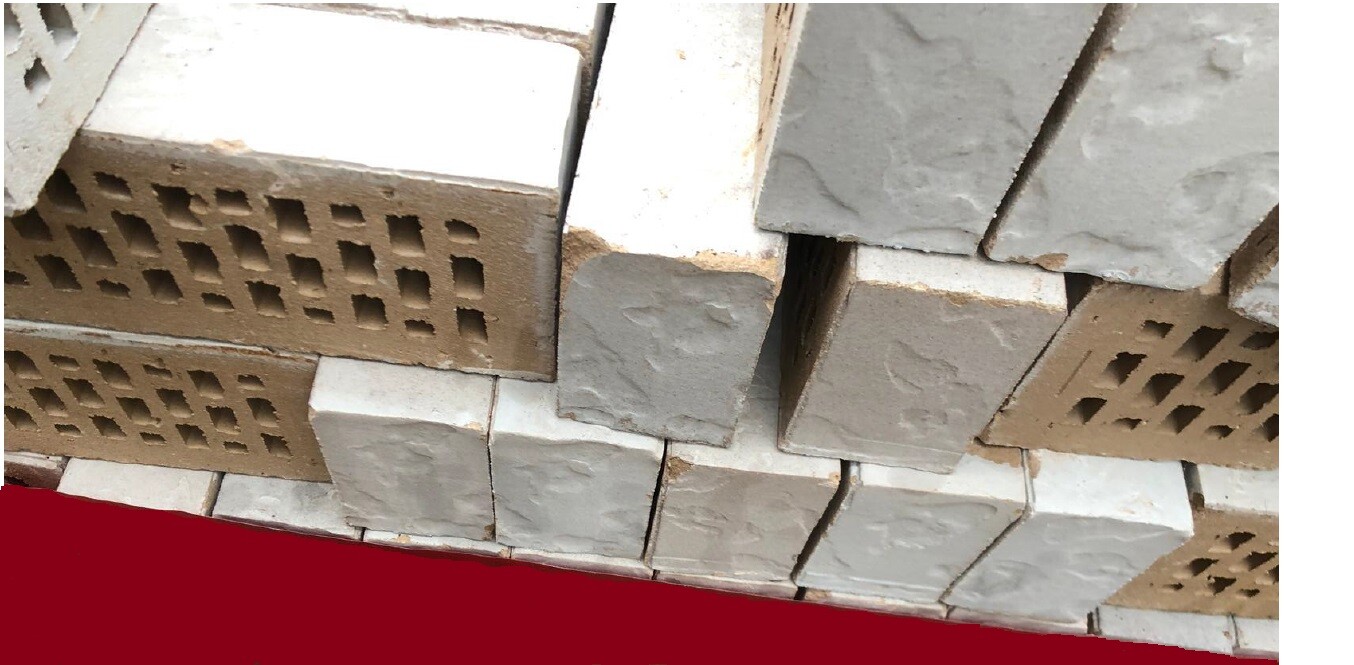

We removed the plastic wrap from one pallet to take a closer look, and the damage was clearly visible. We took photos and sent them to the seller, who did not respond. The next day, I received a call from a company acting as an intermediary, which I hadn’t known about before. The seller had always told me that he sourced the goods directly from the manufacturer. The caller said the issue would now be handled by them.
We arranged a meeting at the site to inspect the clinker. On the scheduled day, no one showed up. I contacted the field representative from that company, who said he had already been to the site, inspected the clinker, and determined the damage was not normal. I strongly criticized this approach since a joint meeting had been planned. He said he wasn’t aware the homeowner was supposed to be there; he had just been instructed by his manager to inspect the clinker onsite. The representative was nearby and spontaneously offered to meet at the site. We met there, and he again confirmed that the damaged pallet needed to be replaced. He planned to discuss with my contractor to sort out the damaged bricks and later talk about whether a price reduction would be granted.
A few days later, my contractor was ready to start the brickwork. He called me and asked me to come to the site because he had found extensive damage to the bricks. We checked several pallets, and many bricks were damaged to the point they could no longer be used. I then contacted the wholesaler/intermediary again. This time, I was told that two field representatives would visit, one of whom was more experienced with such cases.
Three days later, they arrived, and my contractor was also present. At first, they tried to minimize the problem but eventually had to acknowledge that the pallets needed to be replaced quickly. We inspected five pallets together; about 3.5 of them were completely unusable out of a total of 17 pallets (some pallets were still at the manufacturer, with delivery of the remaining clinker planned once the first batch was processed). My contractor mentioned that damage sometimes occurs but never to this extent. He also said he did not consider it his responsibility to check every single brick, which I understand since it is time-consuming. Of course, he could still install the bricks, but I shouldn’t complain about the damage afterward.
I brought up the additional costs incurred (scaffolding, etc.) and made it clear that I would not cover these myself since the bricks were damaged. The remaining pallets were not thoroughly inspected; the issue was to be escalated to the manufacturer.
The next day, I contacted one of the field representatives. He stated that the manufacturer could not explain the damage but was willing to replace four pallets as a goodwill gesture. I asked about the follow-up costs and who would cover them, but I received no answer. I also asked about the delivery time, which was not provided. I told the representative that only a refund made sense here since anything else would drag on.
I wanted to take the initiative and speak to the production manager myself. Through a contact at the manufacturer, I was told that the kiln producing my bricks had a defect. Whether my batch was affected remained unclear. I was unable to reach the production manager. I then drafted a letter to the wholesaler/intermediary, setting a deadline for either a replacement or refund with incurred costs. Otherwise, the next step would be legal action.
Two days later, I received a message from the intermediary/field representative stating that I should contact the seller again to follow the claims process chain. I tried reaching the seller, who told his employee that we should contact the intermediary. I called the field representative and asked what this back-and-forth was about. He was very frustrated with the seller’s behavior and didn’t understand it, even though he had been previously informed. I threatened legal action again and said I did not care who handled the case anymore; I did not understand why I was suddenly supposed to contact the seller again. He could not say anything; he had just been told by his manager again.
The clinker is currently out of stock and will not be produced again until the end of November.
I have a meeting with a lawyer tomorrow. Maybe they can give me a prognosis regarding our chances. Afterward, I will need to find another clinker quickly; waiting longer would be even worse for us. I have also documented everything thoroughly.
I noticed something afterwards: the order confirmation contained a note saying "IP = Individual Product, this brick is excluded from returns." This was not mentioned in the quote. Is this even allowed? Can this still be considered transparent?
Question for you:
Has anyone had similar experiences, and how do you assess my chances in a court case?

A seller is responsible for their sales conduct/business. The question is, if the manufacturer does not classify this brick as a "clinker," why does the seller do so?
My assumption is that the seller does this for "marketing reasons" to make it easier to sell. This is just my speculation.
guckuck2 schrieb:
But fraud requires intent.
[...] I would be very cautious with that. Fraud is a criminal offense, so the complaint is reviewed by a professional public prosecutor, who will not file charges lightly. You can provide facts to them and leave the assessment to their judgment.
guckuck2 schrieb:
It could also simply be a mistake, and the person responsible might not even be the seller. In consumer law, there is effectively the principle of "in case of doubt, against the professional seller."

I have just reviewed the entire thread again. Is it possible that the "intermediary" here simply sold returned goods from a complaint or recalled products?
Greetings,
an update:
The expert commissioned by the court inspected the bricks; many of them are indeed damaged. However, he also confirmed that these are not facing bricks but rather brick slips.
I told my lawyer to inform the other party that I would be willing to waive the penalty interest if I were reimbursed 100% of the purchase price (they had previously offered 60%). This offer was ignored. We then made another proposal, suggesting 90%, but again received no response. The deadline was March 16, 2022.
After my lawyer presented the new offer to the other party, we received a letter from the court a few days later. It stated that something different had been delivered than agreed upon, i.e., brick slips instead of facing bricks. The expert was asked by the court whether a further inspection of the remaining bricks at the factory would be necessary.
On March 15, 2022, the other party suddenly wrote that, for "economic" reasons, the case should be quickly settled through an agreement and requested that we specify our settlement proposal.
Advantages of the settlement:
- The case would be closed quickly, the bricks would be picked up promptly, and I would receive my money.
Disadvantages of the settlement:
- I would lose about €2500 due to waiving the penalty interest and covering 90% of the brick costs.
My lawyer intends to prepare another draft and send it to me before forwarding it to the other party.
However, I can still stop this.
Would you let it play out or accept the 90% offer?
Thank you and best regards
