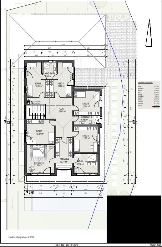

Upper floor plan with bedrooms for parents and children

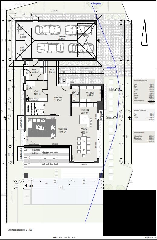

Ground floor plan with garage, terrace, living room, and kitchen

From our point of view, the kitchen should have a rather elongated island around 3 meters (10 feet) long,
Yes, that’s my first complaint: too few cabinets and work surfaces, and also too dark. The small window doesn’t help.
I’ll also take this as an opportunity to say that the ground floor will be darker than expected. At least the open living area. The large south-facing window is fully covered by the upper floor. At least, that’s how it appears. As mentioned before, I can’t check measurements here, but the columns on the terrace indicate the upper floor is resting above. Inside, you basically look up at the underside of the upper floor. There is daylight from the east and west, though.
The dining area would benefit from a partition wall, as would the living area. You want to have dishes or family games within easy reach, especially with five children.

Master bathroom upstairs too small.
Really? I can read 12 sqm (130 sq ft). That can be enough with good furnishings. Here the vanity is opposite the window, so you’re standing in your own light. That creates a passageway. Simply turning the vanity could improve light and space. Personally, I think a south-facing bathroom window is counterproductive if you want to use the bathroom during the day.
I do find the children’s bathroom too small, though. How can three children use it simultaneously? Where can a helper assist? Also, a shared bathroom with two doors for children isn’t suitable: privacy is basically zero. A bathtub would be a good addition in a house of almost 400 sqm (4,300 sq ft). The likelihood of needing one increases with the number of people. What happens if the children are sick? Which bathroom can be used collectively then?
By the way: the ground floor toilet could also have a window.

We have considered swapping the master bathroom upstairs for a small child’s bedroom and moving the master bathroom behind the master bedroom
Then the master bedroom becomes a passage room? That’s not good. Thoughts like this usually create more effort than expected if you want to make a room accessible from the hallway that isn’t currently connected to it.
If someone wants a large house and doesn’t make many adjustments, they can probably be satisfied with the ground floor in principle. For seven people, I find several things lacking, starting with the cloakroom, then the small toilet, and the kitchen (already mentioned), and the living area where, due to a lack of furniture or the option for attractive yet practical furnishing, I don’t see a family TV or game night happening easily. You could say it’s not family-friendly. For example, the west window may look stylish but offers no space for a TV stand.
Upstairs, it could be noted that parents don’t spend time in those rooms, but children do, so the southern rooms deserve attention.

As mentioned before: I wouldn’t distribute the bathrooms in a way that creates disadvantages in the living area. A laundry chute in the utility room instead of the laundry area... I would reconsider the arrangement of the rooms in the basement. The guest room and half-bathroom could also be placed on the east side. The bathrooms on the upper floor would also fit well there. The gym room is too small. Upper floor: a bedroom with the panoramic window won’t bring much joy. I also find the balcony concept questionable. Even if you can afford a gardener, you don’t really want to hang out up there—not even if you have the money to afford a balcony or are wealthy. The upper floor has potential for a complete redesign.
