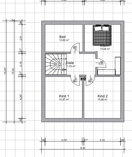

As mentioned before, start your planning on the upper floor. There are plenty of duplex floor plans that work well. Trying to adapt a single-family house plan often doesn’t turn out well. I’m attaching a floor plan sketch just as an example. I’m not a fan of the master bedroom layout, and I’m not sure if having a fireplace on the upper floor is feasible. I just copied this quickly, but maybe you can use parts of it.

We plan to take the basic floor plan of the model house to the general contractor and discuss our ideas and changes there.I wouldn't do that. Instead, I would first ask to see their standard floor plan. You can always change it later if it doesn’t suit you, but after all, it is their job to design, not just to copy what you provide, which in my experience doesn’t improve the quality of the design.Instead, create a detailed room plan based on your needs.
Not just bedrooms, but include the bed with dimensions of 2.2 x 2 meters (7.2 x 6.6 feet), a 4-meter (13.1-foot) linear wardrobe.
Make sure the bed is not placed under a sloping ceiling, and so on.
All your furniture needs to fit. The display cabinet with trophies, the books, the shoe collection, the sports bag in the wardrobe, the dream sofa.
This way, you can more easily check every floor plan. Draw your wishlist to scale, then you can see if it fits.
