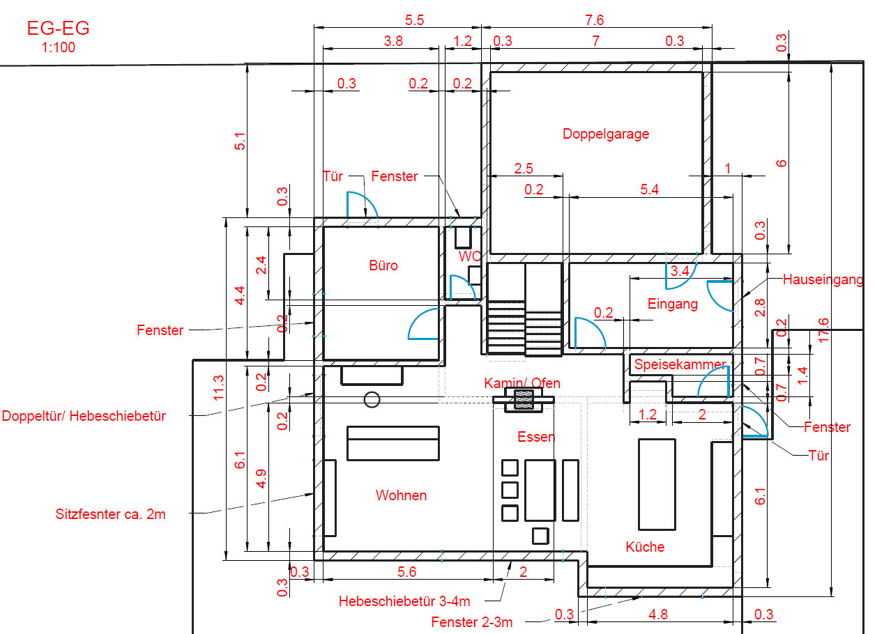

To me, this is not a fully clear floor plan at all. Sure, you can guess some things, but there are missing doors, windows, and room names – I don’t even know where the entrance is. The furnishing is also quite questionable in parts – so many niches and corners that no one understands the purpose of. Sorry, it’s too confusing for me.
I have now labeled the rooms and drawn in the doors. This doesn’t necessarily make the layout clearer but might help with understanding.
I have also marked the windows but deliberately did not provide dimensions. Firstly, I want to stick to available/standard sizes, which I am not familiar with, and secondly, especially on the upper floor, the sizes are not really fixed.
I don’t see too many alcoves or corners, but if anything is unclear, please ask specifically, and I can try to clarify.

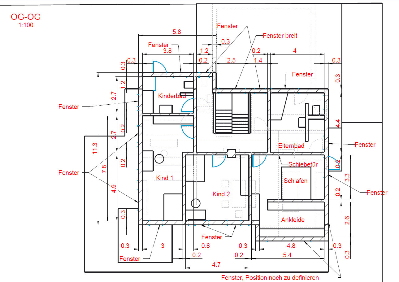

Regarding the upper floor, it should be noted that the dressing room and bedroom will probably be swapped.

Cost savings: Removing a few corners from the exterior walls
Entrance: Like furnishing
Pantry: What should go into this tiny corner?
WC: 1.2m (4 feet) structural dimension, very cramped
Living room: Where should a TV go?
I find the layout of the upper floor terrible, especially the hallway and one of the children's bedrooms.
The bedroom has very little space between the bed and the wall.

I find the upper floor quite awkward. The overall large floor area is not used optimally. The one children's room with that angled section is hardly practical as it is. There should be a way to make the room a more regular shape. In my opinion, the question is also whether the layout of the ground floor really has to be fixed as it is (meaning: first you should determine the bottleneck, i.e., whether it’s the ground floor or the upper floor). Then you design the bottleneck floor first, and only afterwards the other floor. So, in this case, I would develop the upper floor first, then the ground floor.
@ haydee:
- The furnishings for the entrance area have not been finalized yet. Jackets and shoes should be stored there. I was thinking of cabinets along the top and bottom walls of the plan.
- Pantry: The niche accessible from the kitchen is intended for a side-by-side refrigerator. The inner corner has not been decided yet; it resulted from external requirements. It might be possible to adjust the pantry by moving the walls. However, the current size should already be sufficient.
- The toilet is just a toilet; dimensions are known (from other toilets), but good point, we will see if we can make it a bit wider. My dimensions should be finished dimensions.
- Living room: TV on the bottom wall of the plan (south wall).
@ haydee, @ montesalet:
What you say about the upper floor sounds quite awful
Regarding the bedroom: There is 1m (3.3 ft) of space around the bed, which I think is definitely enough. (The bed is drawn to scale, 2.3x2.2m (7.5x7.2 ft))
Please explain in more detail what you don’t like about the hallway.
The children’s rooms both have almost identical floor areas, hence the kink. You should consider that the room is still 3m (9.8 ft) wide here, which is about the size of “standard” children’s bedrooms, usually around 3x4m (9.8x13.1 ft). It’s just elongated. Personally, I think this is better than a square room because it makes it easy to define different zones later on.
