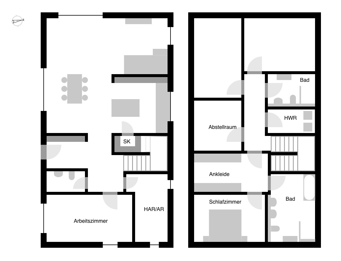

opalau25 Aug 2018 00:52
The residential house in Muhl has some genuinely interesting ideas upon closer inspection. The sight lines require too much circulation space for my taste, but regarding the dance floor in the living-dining area, I borrowed a bit. (The upper floor has remained almost the same.)
The pantry is now really just that, and the utility room (HAR) has become a storage room (AR). The kitchen has been slightly reduced in size, which allows for more space in the rest of the area. I’ll sleep on it.
(The drainage for the kids’ bathroom would certainly be a challenge, but that's probably also the case for the master bathroom in Muhl.)
Two-story floor plan: left wing study, utility/storage room (HAR/AR); right wing storage room, bathroom.
11ant25 Aug 2018 01:41
opalau schrieb:
The sightlines require too much traffic area for me,
I prefer to let my gaze wander rather than focus it on a bowling alley.
Not that I don’t see a quality improvement in the discussion, but I have the impression that the sheer number of explored variations multiplies even further. The only really significant change I see is the swap of the entrance location.
In my opinion, the original draft was already only one refinement step away from “final preliminary design maturity” after an architectural consultation. Changes I would have made were more a matter of personal taste rather than indicating any fundamental flaws. If you still enjoy this process, that’s fine—but sometimes I can relate well to those who only present their slab layout after the dice have been cast. In my view, some designs are also unnecessarily overanalyzed here.

kaho67425 Aug 2018 10:57
So I would also aim for the living room in this layout.
There are still some issues here and there. The pantry is quite small now and causes this awkward corner in the hallway. It’s borderline—not really ideal for a dream home. The kitchen island is reversed again due to limited space—do you need that many cabinets? Are you serious cooks? Or could the island also be placed against a wall?
If you’re only building a carport, wouldn’t it be more convenient to have the entrance next to the car, rather than having to walk all the way around the house? It’s not a big problem but would be a nice to have.
The utility room upstairs is quite narrow. If it’s just for the washing machine, that’s okay. However, I wonder what exactly you plan to store in the storage room and whether the washing machine could be placed there instead? Something like a laundry folding area with an ironing board and large cabinets for diving gear plus Christmas decorations or similar.
Here’s another approach with a slightly narrower kitchen (3.50 m (11.5 ft)). This shifts the staircase a bit towards the garden and creates a wonderfully large walk-in closet and bedroom with a view upstairs. On the ground floor, office, WC, pantry, and entrance hall fit well (the pantry under the stairs shouldn’t become a fixed rule, as that can cloud your view for alternatives). Entrance on the right.
opalau25 Aug 2018 14:49
@11ant, @Wickie I’m glad to hear that. It’s reassuring to know that we aren’t overlooking any major issues at this stage. I think we’ve basically reached a point where a lot is decided, and there’s not much change between the different drafts (almost the entire upper floor, rough layout on the ground floor). Ultimately, it’s also fun to experiment a bit more right now.
@kaho674 The pantry is indeed not ideal. Could you explain how a kitchen island could be oriented the wrong way? I actually liked that design (It was also copied from the Muhl).
Since the carport extended along the house is planned to have a shed attached (6 x 6 + 3 x 3 meters (20 x 20 + 10 x 10 feet), see site plan on page 1), having the main entrance on the right side of the plan is difficult. But even with just the carport, you’d have to squeeze between the cars. I don’t want to design the house around that, but for now, I would still prefer the entrance on the left side of the plan.
11ant25 Aug 2018 17:14
Wickie schrieb:
Do sight lines really require that much traffic space?
If I have the lake view from the sofa, that’s enough for me—I don’t need to arrange the living room door so that I can enjoy the view eight meters (26 feet) away as soon as I come in through the front door. You can push things and exaggerate everything. Personally, I’m pretty laid-back about it: if I look up from chopping vegetables, I don’t mind if there’s a photo wallpaper with the pantry door behind it.
opalau schrieb:
I think basically we have reached a point where many decisions are settled and there’s little change between designs (almost the entire upper floor, rough layout on the ground floor). Ultimately, it’s actually fun to experiment a little more.
Then don’t forget to stop when it’s at its best. After that, it goes downhill, meaning you’ll have so many variants that differ only at the fifth decimal place—and then the fear creeps in that flipping a coin (because if it’s too late to narrow down the list by elimination, that’s the only option left) could make the “wrong” choice.
Given that the "architect’s filter stage" still lies ahead, I’d suggest slowly closing the discussion and, if necessary, switching to a vote on the existing proposals 01 to 88.
I don’t expect anything more substantial to come now—even if not every wall in every conceivable position has been drawn yet.
