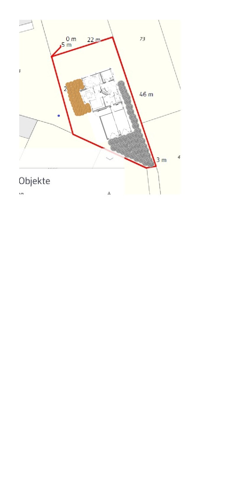

The possible plot is approximately 850m2 (9,150 sq ft), located in the second row with access from the southeast.
The plot slopes slightly to the north (about 2m (6.5 ft) over the entire length).
There is no building permit / planning permission for the plot, and no further information is available.

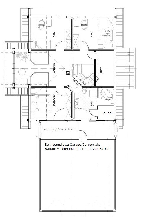

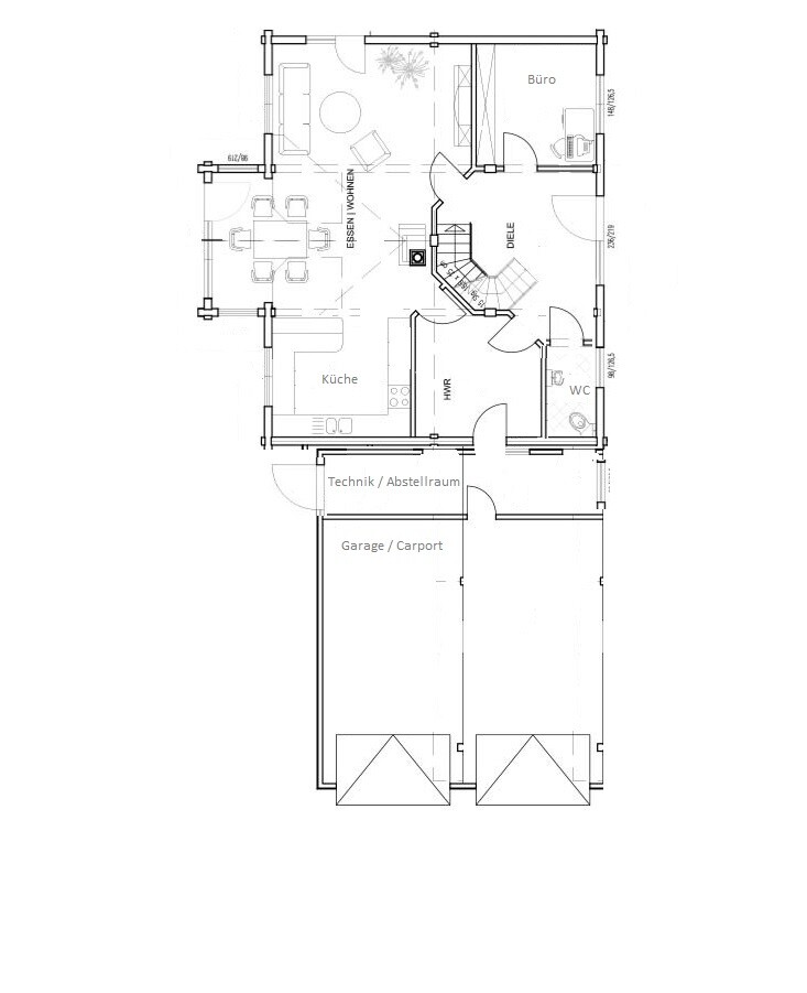

I have sketched out some ideas based on how I imagine it could be. Does anyone see any major flaws or have tips or suggestions? I feel like I’m missing the forest for the trees and would appreciate any advice!

Is the orientation on the plot okay or are there better options? Is attaching the technical/storage room to the garage sensible/technically feasible? Possibly a better place for the sauna than under the sloping roof?

PS: On the sketch of the plot, grey = paving stones and brown = terrace

saralina8714 May 2020 15:52The problem is that without measurements, it’s hard to say much about it... But in principle, it looks good to me!
Drasleona14 May 2020 17:26I find the floor plans to feel somewhat outdated...
The stairway with its angles, the toilet tucked in the corner, a shower that seems relatively small to me, 45-degree walls... It’s just not quite my style, but I can’t really put my finger on why, sorry.
