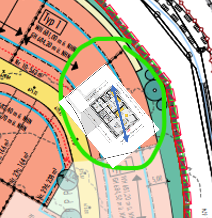

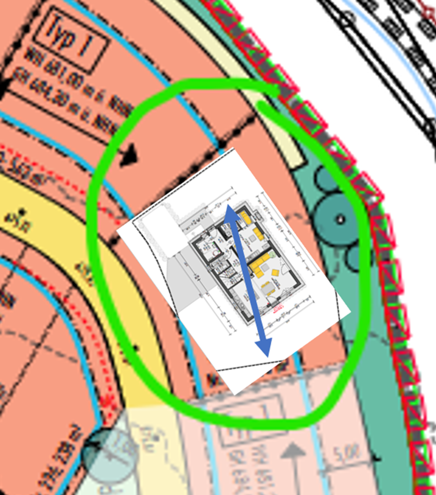

Circled in green and oriented to north.

As ypg already mentioned, the small porch at the entrance is missing. I also think the upper floor lacks an open space with a small balcony. We have looked at Fjorborg. However, we would like to come up with a basic concept to show roughly how it could work.
hanghaus2023 schrieb:
Sorry, I didn’t mark the first picture correctly. The building boundary and ridge direction still don’t match. Many thanks to hanghaus2023 for marking that. We also noticed that the ridge direction doesn’t quite match (there is some tolerance according to the development plan). But also that the building boundaries were completely ignored in the design – quite wild.

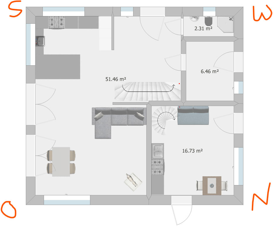

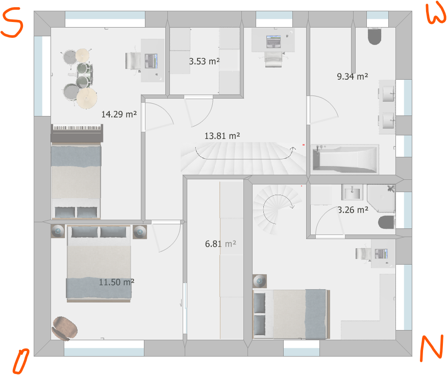

I started from scratch and created a new draft with exterior dimensions of 10.38m (front/street side) x 9.44m (34ft (front/street side) x 31ft), which is significantly smaller than the initial plan.
The open-plan living area is smaller again but feels more open due to the staircase, I think. Also, sitting on the sofa, you don’t have to strain to see the entire TV or screen.
There is now more space at the entrance area for both dog and human gear.
A small balcony above the entrance area would now also be possible upstairs.
The windows still don’t fully work out yet.
The bed in the study is supposed to be a sofa bed, only pulled out when guests stay overnight. In that case, the second workstation can be used as well.
Looking forward to your thoughts 🙂
Ground floor
Upper floor

But your house does not resemble a Swedish house at all. It is a simple rectangular box, a standard, run-of-the-mill design. The classic Swedish house from the Büllerbü catalog of 1922 requires a porch, a balcony, a covered entrance—something along those lines... exactly the features we know and love from “The Children of Büllerbü.”
