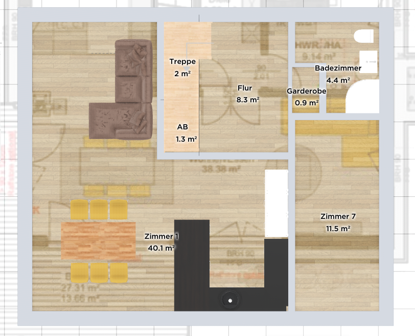

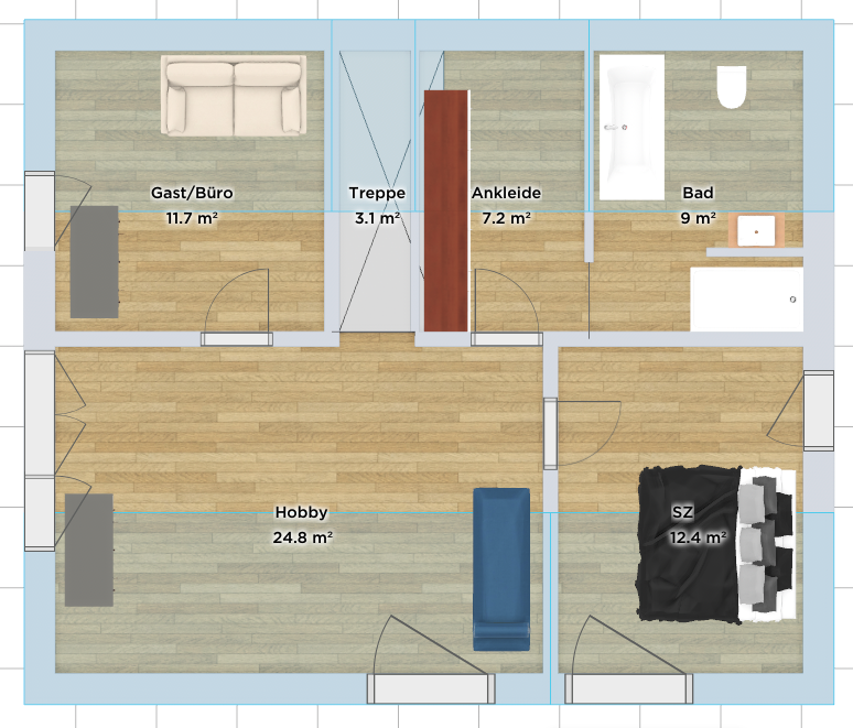

Here’s a quick and simple idea for inspiration:
Thank you @ypg for your time and ideas.
I already liked the initial concepts; they definitely make the upper floor feel much more comfortable. We will try to rebuild that over the weekend!
I really like the idea of having the technical room downstairs and a utility room upstairs. Laundry usually happens upstairs, etc. Downstairs, you have a robot vacuum to clean the floors, while upstairs you more often need a regular vacuum cleaner, and so on.
In your new design, you swapped the kitchen and living room. I’m still undecided about this because, in this arrangement, the kitchen becomes wider and thus a kitchen island becomes more realistic. At the same time, this allows the technical room to be located behind the kitchen. That wouldn’t work with the living room in that spot, since there would be no suitable space left for a projector screen or TV. Two good reasons to arrange it this way.
The living room would then be facing southwest, which I don’t like for two reasons:
- I prefer the living room to be darker, so north-facing works well for that
- I would rather have the view from the street into the kitchen than into the living room (depending on how the house is positioned, there may be more or less space between the house and the street)

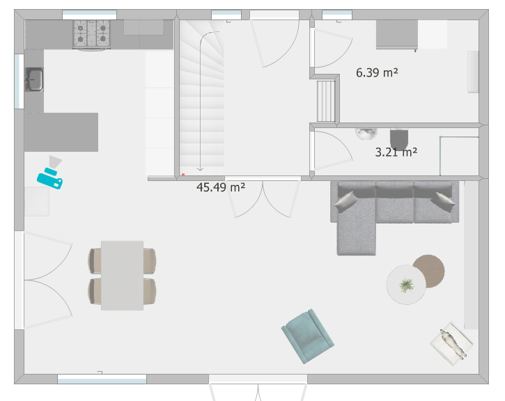

Thanks @11ant for the explanation. We inquired: a knee wall height of 2m (6 ft 7 in) works with standard windows. That costs about €7000 less than 2.3m (7 ft 7 in). We don’t want a truss roof since we plan to use the attic as storage space.

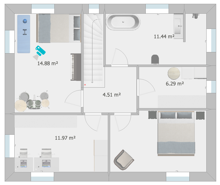

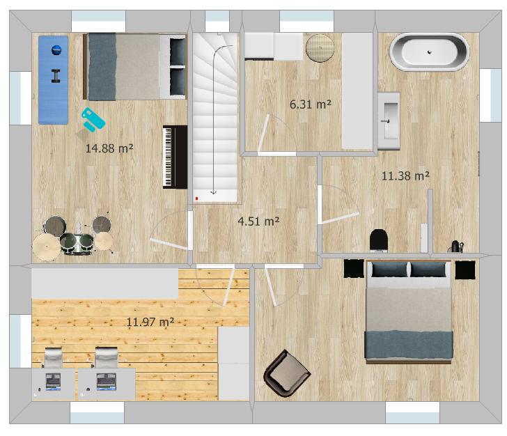

@ypg, thanks again to you as well. I tried to implement this (some windows are still missing and not quite correct, especially on the upper floor).
Ground floor
Upper floor
Upper floor alternative
I don’t think the bathroom furniture layout is optimal in either case, but I really like having the utility room on the upper floor and the wardrobes in the study. The bed in the guest/hobby room is just a placeholder; in real life, a sofa bed will go there.
Overall, I’m quite happy with it now. What weaknesses do you still see?
