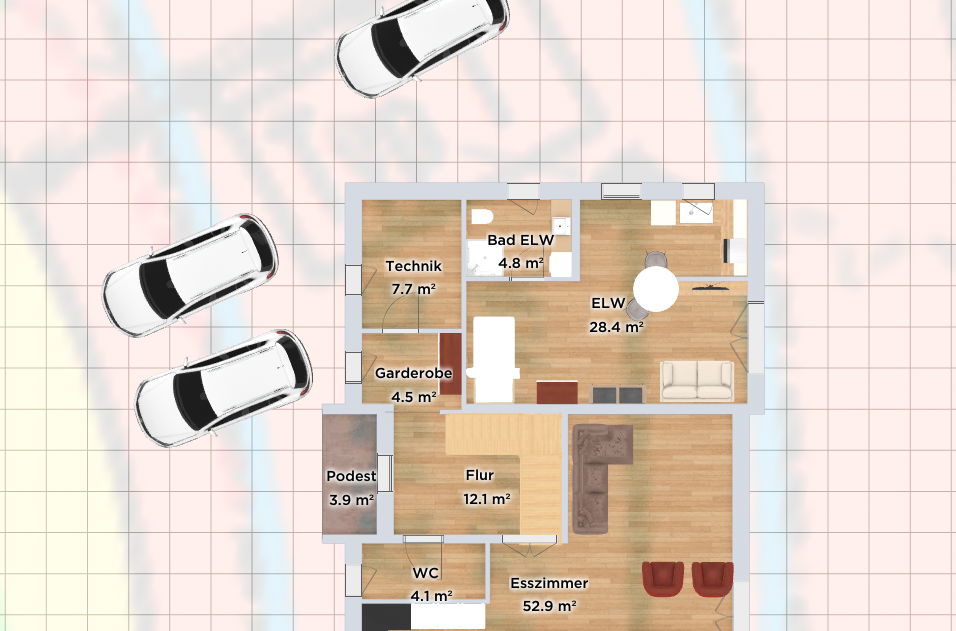

We are a couple (both 34 years old) looking to build our home in a rural area of Baden-Württemberg. Important preliminary information: no children planned, but a dog. A separate apartment (granny flat) is mandatory with at least 23sqm (250 sq ft).
We would appreciate your input to help us avoid making major mistakes.
Plot size: 494sqm (5314 sq ft)
Slope: none
Site coverage ratio: 0.32
Edge building allowance: garage permitted
Number of parking spaces: 3
Number of stories: 2 full stories required
Roof style: gable roof with a pitch of 25–38°
Orientation: see plan
Additional requirement: separate apartment
Homeowners’ Requirements
Style: country house / modern Swedish style
Basement, floors: no basement, 2 full floors
Number of occupants, age: 2 adults (34), 1 planned dog, 1 person in separate apartment
Space requirements on ground floor and upper floor: 120sqm (1292 sq ft) for us plus at least 23sqm (250 sq ft) for the separate apartment
Office: home office, 1 person working fully from home
Guest stays per year: total about 5–15 nights
Open or closed layout: open
Open kitchen, kitchen island: open kitchen with kitchen island or U-shape preferred
Number of dining seats: 4–6
Fireplace: desired for coziness, small in size, probably not really necessary
Garage, carport: carport plus 2 additional parking spaces
Kitchen garden, greenhouse: small greenhouse plus kitchen garden
Other wishes / special features / daily routine, also reasons why certain things should or shouldn’t be: the most important space to us is the kitchen and living room combined as an open area. We want it to be cozy, which is very important. The building plot faces east on the edge of the village, with no further development planned in that direction. We really like this view, but we would also like the terrace to face south.
In general, we want to make the best possible use of the remaining garden and are looking for ideas on how to place the house on the plot to maximize garden usability. We understand the garden won’t be very large.
We both have home-centered hobbies that require space: my husband plays drums, I play piano—space needed upstairs. I enjoy baking, he enjoys cooking—space needed in the kitchen. I like to read—books require space too. We both enjoy gardening.
Designed by: architect (BU)
What do you like especially and why?
- Layout of the open space and size of the kitchen
- Location of the separate apartment
- Additional space gained upstairs. We originally considered a single-story extension for the separate apartment, but the architect said it’s more expensive than enlarging the whole house. This way, we can keep the technical room small downstairs and move the utility room completely upstairs. We would swap room usage upstairs: bedroom → utility room in the northeast, office → bedroom (this also allows a nice built-in wardrobe niche).
What do you dislike and why?
- The separate apartment has no room for a closet
- Unsure if the size of the open space is sufficient
- The bathroom is very large—like a ballroom. We considered extending the hallway to create a small extra storage room. However, this would reduce western light in the bathroom.
- We don’t like the windows and terrace doors at all yet
- Carport location: needs to be rotated and, in our opinion, moved to the boundary
Cost estimate according to architect/planner: €600,000 including secondary construction costs
Tasks we will do ourselves: roofing, purchase and installation of photovoltaic system & battery, wall and ceiling boarding, filling, painting, flooring, bathrooms
Preferred heating system: air-water heat pump with underfloor heating
If you have to give up some details / expansions
- Can give up: fireplace, so much space upstairs
- Cannot give up: separate apartment, large kitchen
Why has the design turned out this way?
Because this reflects our wishes, the separate apartment, and respects the development plan. We tried ourselves to design a squarer house to create space on the south side, but that didn’t work with the separate apartment.
We’re happy for you to roast the floor plan and welcome any improvement suggestions—thanks in advance.

DieHnnH schrieb:
So, to sum it up: our own designs are so bad that it’s not worth trying to revise them ????
Well, we gave it a shot.
What do you think was our approach? We deliberately went to the planner (not to Fjorborg) WITHOUT any prior planning and only with the room program and building permit / planning permission documents, who then forwarded it to the architect. The result is what you see on page 1. Obviously, it didn’t work out that way, hence the DIY enthusiasm.
I would have liked to send something back as feedback that fits better, so that the planner/architect can see which direction it could go.
Anyway. We are considering the next steps. Thanks to you all anyway. DieHnnH schrieb:

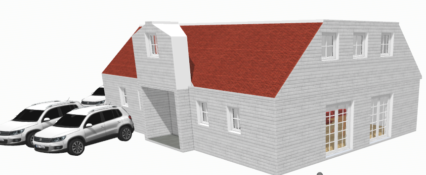

haydee schrieb:
Please continue this thread.
The only question is who and how the costs for a granny flat / accessory apartment are determined If this is better, feel free to use it.
I have estimated it roughly with the following assumption: 30 m² (320 ft²) x €3,300
DieHnnH schrieb:
We are now allowed to pay a penalty, even though it’s very frowned upon! This penalty amounts to about 1/5 of the cost for a potential granny flat / accessory dwelling unit. PURE RELIEF is flowing through my veins right now.It’s probably for the best 🙂
Still, last week I experimented a bit with the granny flat / accessory dwelling unit. You can get a nice house that way. However, the question remains whether the zoning group you mentioned actually exists.
Here is my quick & dirty draft:
