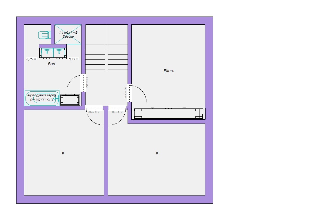

We are unsure if the bay window on the ground floor is practical and will actually be used.
The plan includes two children’s rooms, but we are considering adding a home office to the layout.
The bathroom on the upper floor could be larger, though we are satisfied with the current size. It should definitely not be smaller. Additionally, we would like an extra source of natural light in the bathroom, preferably a door, so that we have access to the garage roof.

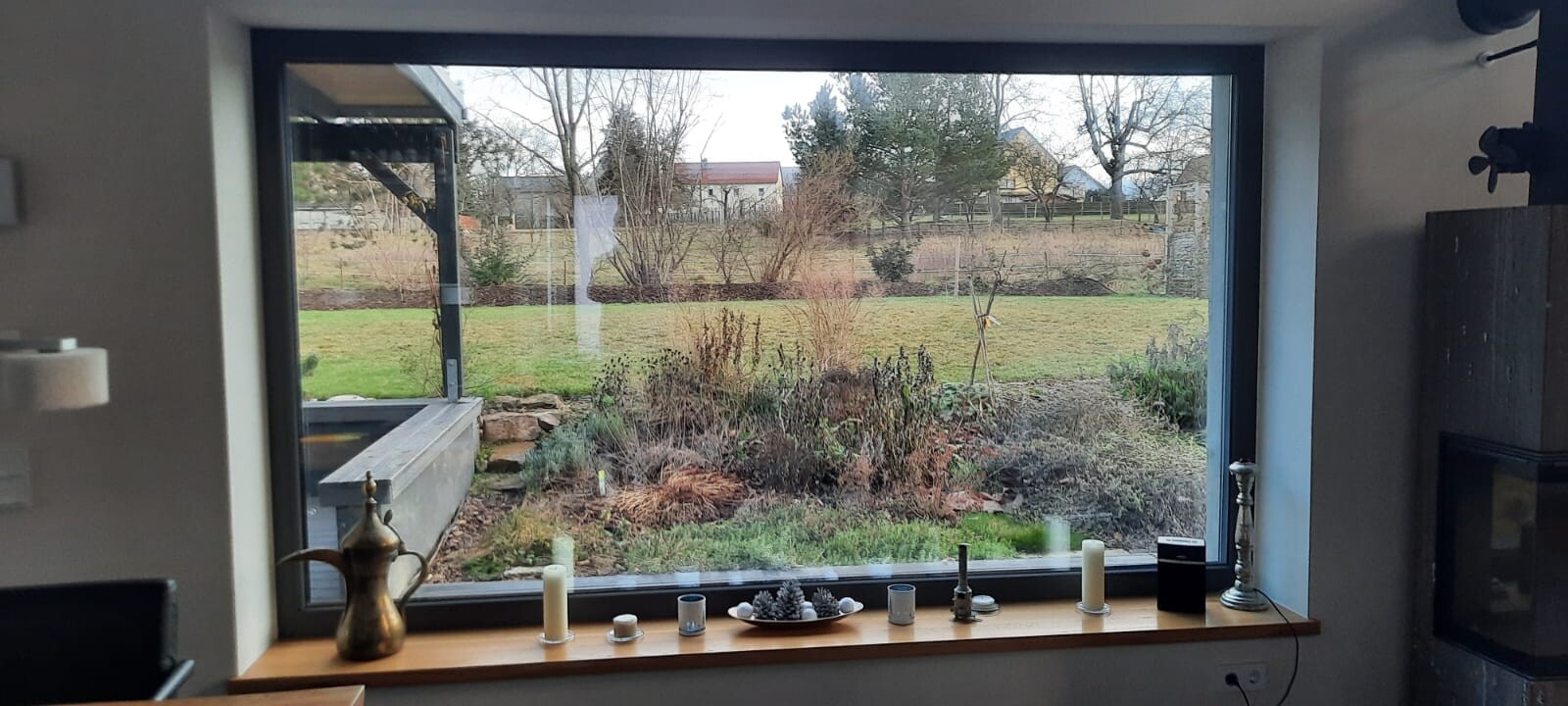

Good tip about the seat depth. We’ll discuss that again if there’s going to be a window seat.Just to be clear: I wrote "seat height," meaning measured from the floor. A "seat depth" obviously is also necessary for such a desired window seat, and that’s exactly the challenge, as it protrudes into the room.Murmele305 schrieb:
We’ve already tried a few layouts for the upper floor. However, we haven’t managed to create a well-organized layout that we like. Then the idea of the mini hallway came up.I would do it like this:Whether to arrange the bathroom without the T-shape is up for debate.

Regarding the depth of the window sill, shouldn’t it be about 60cm (24 inches) deep to really sit on it comfortably?Here is an older picture, please ignore the decorations as there were still some things left over from winter. The window sill is 3m (9 ft 10 in) wide, 40cm (16 inches) high, and 30cm (12 inches) deep.Murmele305 schrieb:
