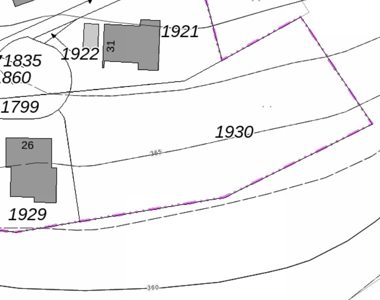

Do you at least have photos of the plot that show the slope? Or share the topography from the geoportal. There are often contour lines available there as well.
philipe
8 May 2025 18:26
We are planning this not as a granny flat but as two separate dwelling units, both under the same ownership.
Here is the topography; the idea was to use the excavation material to fill the area in the ground near the terrace.
Lageplan mit grauen Gebäuden und Parzellen 1921, 1922, 1930, 1929; lila Grenzlinie

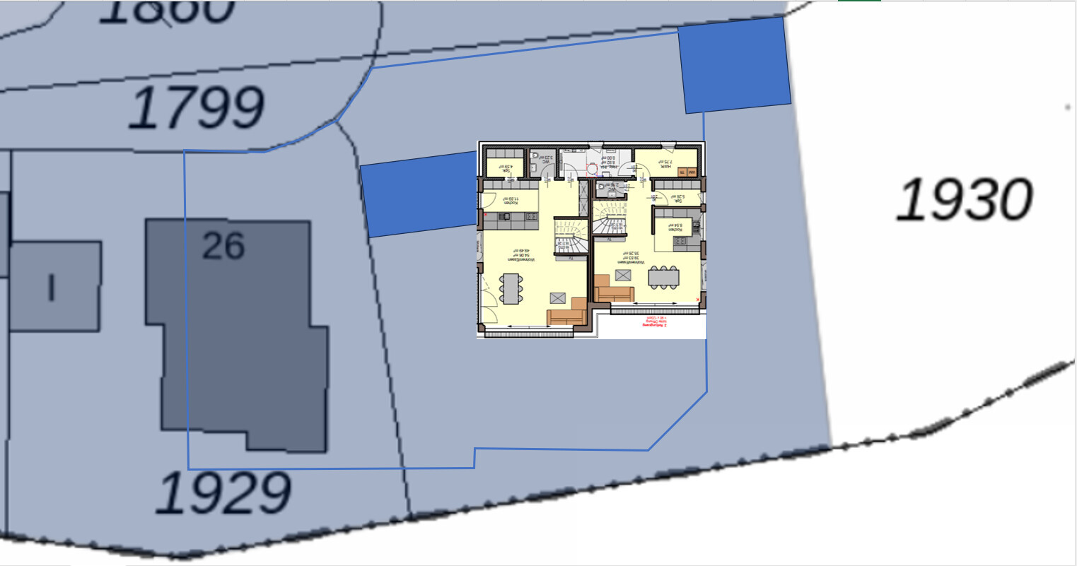

Thank you. What is the elevation difference between the contour lines? Presumably 2.5 m (8 feet)?
Here is the building plot marked on the map.
Map view with parcel numbers (1799, 1929, 1930) and embedded house floor plan.
If you want a carport or garage to the west, then the structural setback line (SSM) must be moved further south.
Is a garage allowed to the north outside of the building plot?
The 3 m (10 feet) high retaining walls are quite expensive.
How did the neighbor to the west manage the slope?
Is there a reference point for the 9 m (30 feet) height?

The placement of the garages will be tricky; a double garage for the father-in-law is almost a must. I’m also thinking a carport. I placed the garage here because ideally a driveway leading to the garden property should remain free at the top. Currently, this is outside the scope of the zoning plan, so it needs to be looked at again.
So the plot is only partly within the zoning plan area, and the change in color on the plot indicates the boundary to the unzoned area? – In that case, I would expect only one corner of the garage to be in a problematic spot.
