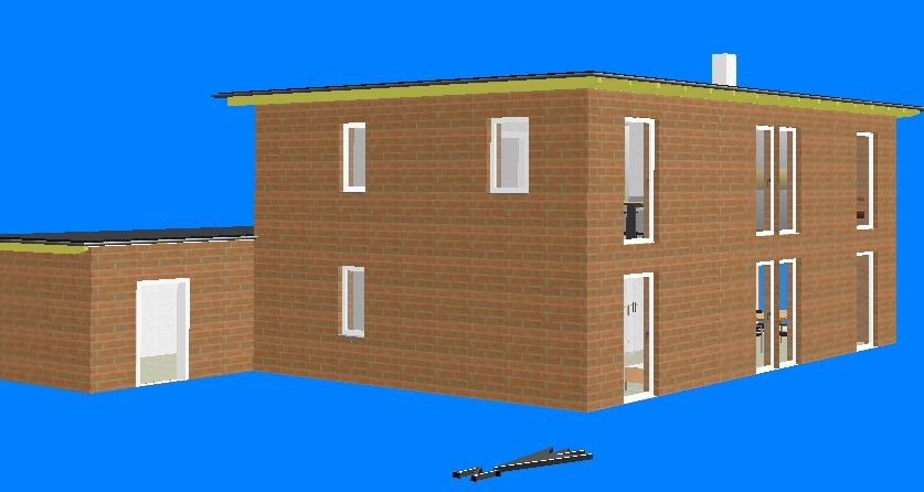

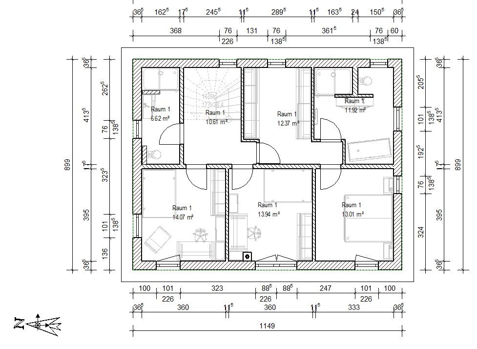

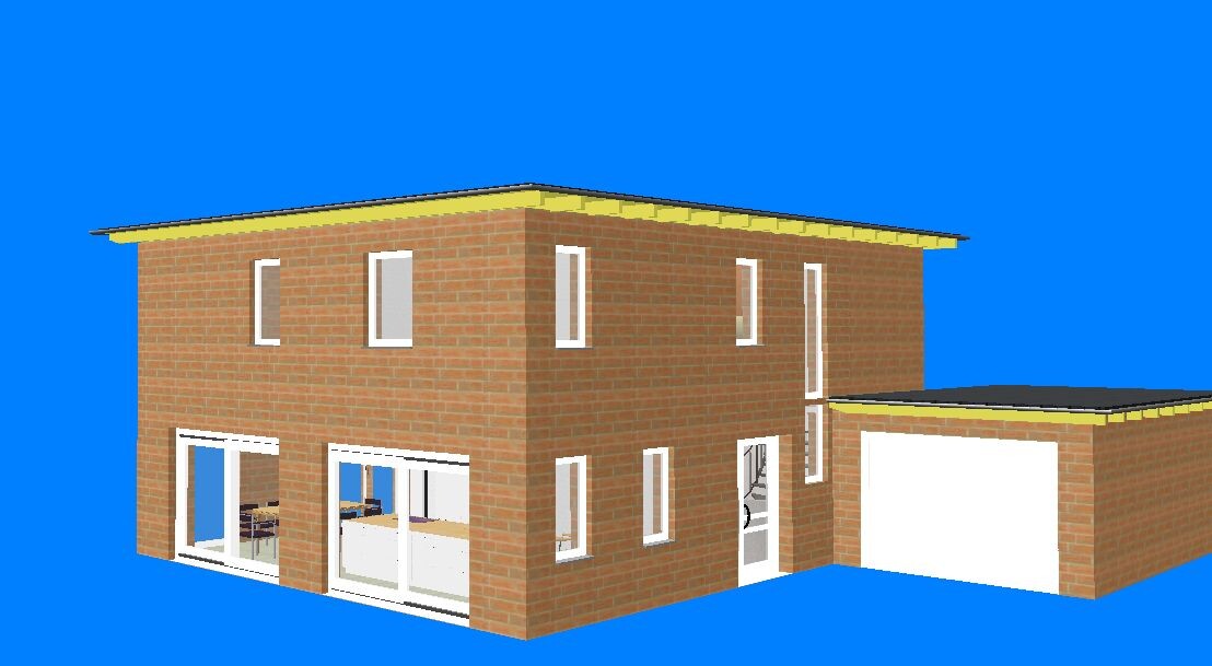

The kitchen now also has an east-facing window... very nice on sunny summer mornings like right now.
Pantry/storage room as a walk-through with two 120cm (47 inches) wide storage areas. The rest can then go into the basement.
Kitchen with a sunny east-facing seating area and a nice view to the south.
Fireplace now on the exterior wall.
Hallway with a niche for the wardrobe, bathroom arranged so that the shower has enough space. The upstairs bathroom is identical, by the way.
Partition wall in the living area for a possible sleeping space could be placed similarly to upstairs at about 360cm (142 inches). This way, the fireplace can at least still be used. The living area would then shrink to roughly two comfortable armchairs.
Upstairs, the master bedroom was also moved to the west side. This allows better positioning of the bathroom and walk-in closet (a real walk-in closet) with 600cm (236 inches) of wardrobe space.
Maybe there are a few ideas for you here.

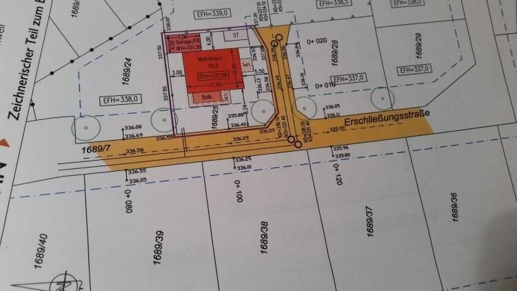

Oh, by the way, I positioned the house about 50cm (20 inches) further south because of the stairwell windows 😳
P.S: The program is acting up right now... it labeled everything as Room 1 😉

I am specifically referring to the discussion about this design. I just skimmed through the other thread again – there is very little below the belt. The main focus is on the issue of the pantry, which over time becomes more like a storage room (despite having a basement), the impractical kitchen that will look cool but lacks countertop space, the bedroom/bathroom layout, and the topic of age-appropriate living. Windows and elevations are also discussed. These critiques have been mentioned here as well. I just don’t see whether the feedback has been acknowledged.
