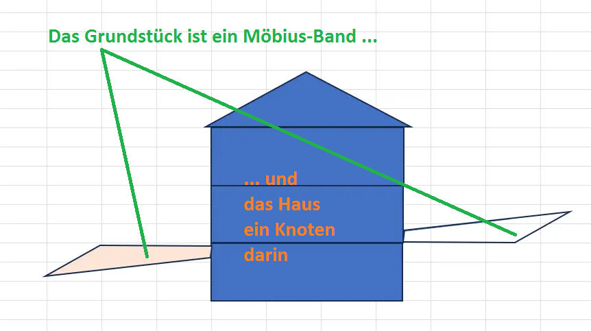

hanghaus20231 Feb 2024 19:16@K a t j a I can help with that. The contour lines are each 1 meter (3.3 feet) apart. I have marked the slope in my illustration (post #38). Approximately a 12% slope towards the west. Unfortunately, the original poster did not understand what I was trying to show.
hanghaus2023 schrieb:
@K a t j a I can help with that. The contour lines are each 1 meter (3.3 feet) apart. I marked the slope in my illustration (post #38). Approximately a 12% incline towards the west. Unfortunately, the original poster didn’t understand what I was trying to show.No, of course not. Because the house is supposed to be a little to the "left or right" anyway. But I don’t think he’s capable of sketching or drawing the site plan with a house himself.K
Kreisrund2 Feb 2024 08:19Vivusorg schrieb:
As a layperson, your sketch is not easy for me to understand. It is clear, however, that the northeast corner of the basement is the deepest in the ground, and the southwest corner the shallowest.Why do you insist on designing your house yourself if you don't even understand this very simple sketch?
Vivusorg schrieb:
Your sketch is not easy for me to understand as a layperson. Kreisrund schrieb:
Why do you insist on designing your house yourself if you can’t even understand this super simple sketch? Well, then I’ll share how I as a professional interpret the drawing from post #38: as a suitably humorous comment to the popcorn thread creator that the contradictory references to the site of their property are confusing:
