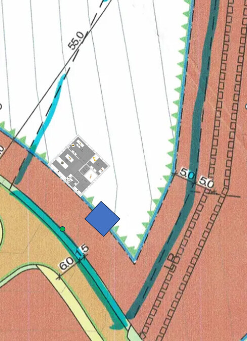

I have sketched the ground floor on the plot. However, I wouldn’t want it like that.
What does the surrounding area look like?
Where can I find the building permit / planning permission?

I already did,
hanghaus2023 schrieb:
I sketched the ground floor onto the plot. However, I wouldn’t want it like that.
Where is the building permit / planning permission?
The placement is not quite correct. The house should be further to the right.
What would be more interesting is what exactly you wouldn’t want about it. I would appreciate it if you could be more specific here.

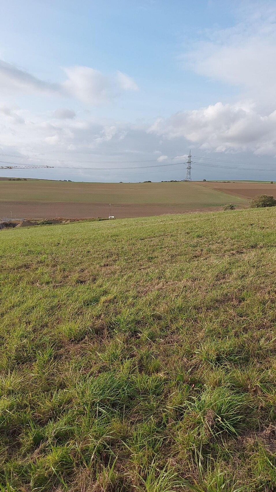

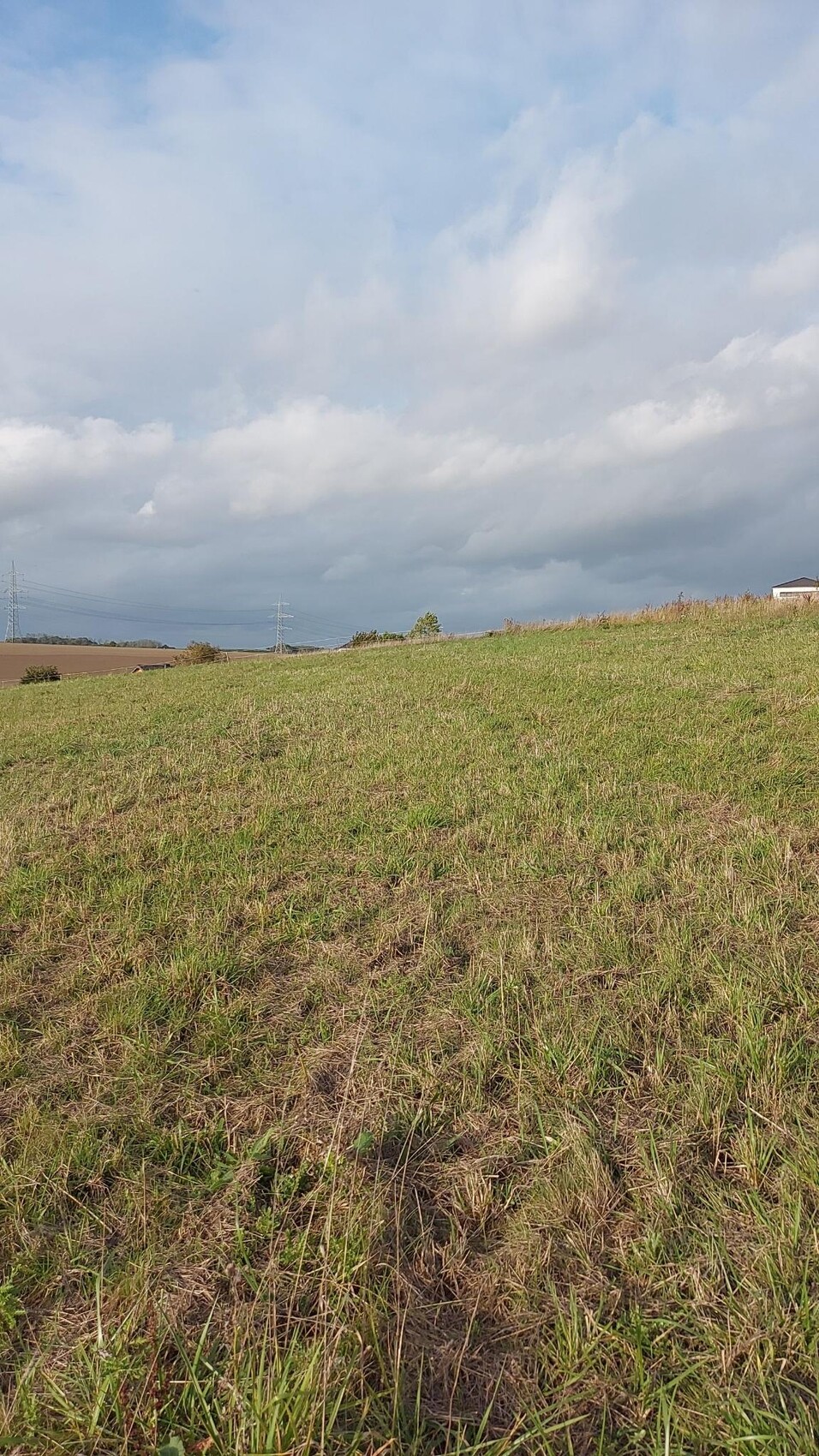

The surroundings can be seen in the pictures attached to the original post.
There are currently no houses within a 100m (330 ft) radius. The best view is from the dining room / living room.
