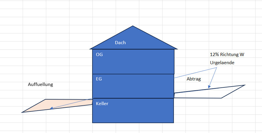

hanghaus20232 Feb 2024 17:30Hello @11ant. Sorry, my mistake. I didn’t consider that the original poster has less knowledge about the subject.
Here it is again with labels:
Where it says excavation, the original poster wants to place the garage with a 4 m (13 feet) distance. The garage will then be at a higher level or will need to be partially dug in.
hanghaus2023 schrieb:
Here again with labels:
Where it says excavation, the original poster (OP) still wants the garage at a 4 m (13 ft) distance. It will then be either higher or will need to be built into the ground. Because of the slanted lines I highlighted in yellow myself, I actually thought you wanted to illustrate to the OP the nonsense of their words using a drawing that is both perspectively distorted and linear at the same time.
