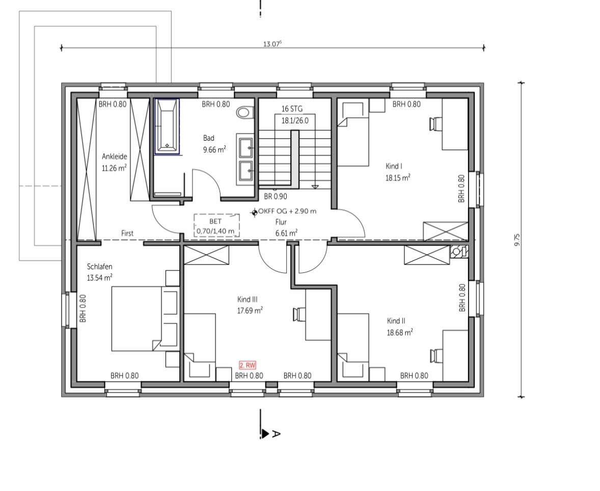

Dear forum,
We are currently working on the floor plan with our architect and would appreciate any suggestions or information. Our plot is quite narrow, with a country lane on one side and a large, almost adjacent building—a farm—on the other side.
There is still an old four-sided farmstead on the property, which will be demolished as part of the new construction. On the site plan, all parts to be demolished are marked in yellow. The areas marked in purple will remain as a basement replacement and storage space. The approximate location of the new building is shown in red. We are basically building in the second row, which we like and have cleared with the building authority.

Grundriss eines Obergeschosses mit Bad, Schlafen, Ankleide, drei Kinderzimmern, Flur und Treppe.

Okay, let’s agree that the door leading forward to the carport will be removed. Otherwise, I can’t really imagine a better layout for the extension – could someone sketch it out?
It would definitely be preferable for us if the niche for the washer/dryer were removed again, as it caused us sleepless nights upstairs.
If the staircase is moved 70cm (28 inches) to the left according to the plan, then our bedroom should be able to shift back to the north.
Regarding storage: the plan is to move rarely used items (such as partially used paint cans) to the barn. There will also be cupboards for seasonal decorations there. The barn is dry and built like a cellar. Supplies, vacuum cleaners, and so forth should then be stored in the pantry.
The utility room is really only for the building services. I asked twice, and according to the architect, it should work. But I will have it drawn in for confirmation!
There is no ventilation system. Corner windows are generally desired but were apparently lost in the latest revision. We didn’t want a window in the pantry because there will be a freezer placed there.
I am attaching the previous draft of the upper floor (the house was still somewhat larger then). We liked the layout of the rooms better at that stage.
Upper floor: bedroom, dressing room, bathroom, corridor, staircase, and three children’s rooms.

Edit: Compared to the previous floor plan for the upper floor, the staircase and bathroom would, of course, be swapped.
Also, as an addition to the last post: I see the laundry issue as a problem as well. In summer, it’s fine since I can quickly hang clothes outside. But in winter, I don’t have a proper place to hang them indoors. However, no ironing is done here.

25 Jan 2024 23:47
The top area has remained almost unchanged.
You could still refine it for another three weeks – this is just a rough idea of how it could look (please consider it as a sketch).
Shoes and bags – there could still be space to park a stroller here, before three school backpacks and sports bags need to be placed somewhere else.
The guest toilet will get a window above the toilet, and the utility room might also have a patio door if the washing machine is located there.
The wardrobe cabinets are 1.50 and 2.50 meters (5 feet and 8 feet 2 inches) long.
