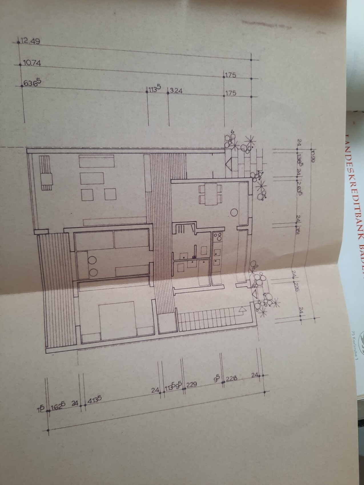

Flo_plant19 Aug 2024 23:28Hello everyone,
I would appreciate your ideas on the floor plan. We are planning to buy my grandmother’s old house and want to make some adjustments to the layout of the upper floor (ground level, due to the hillside location) as part of our renovation. We are still at the very beginning of our planning and mostly have wishes rather than concrete ideas (see below) – so we welcome any input!
Plot size: 338 sqm (3636 sq ft)
Slope: Yes, the house has two levels – the upper floor is at ground level at the entrances, and the lower floor is ground level at the garden. The slope descends from east to west.

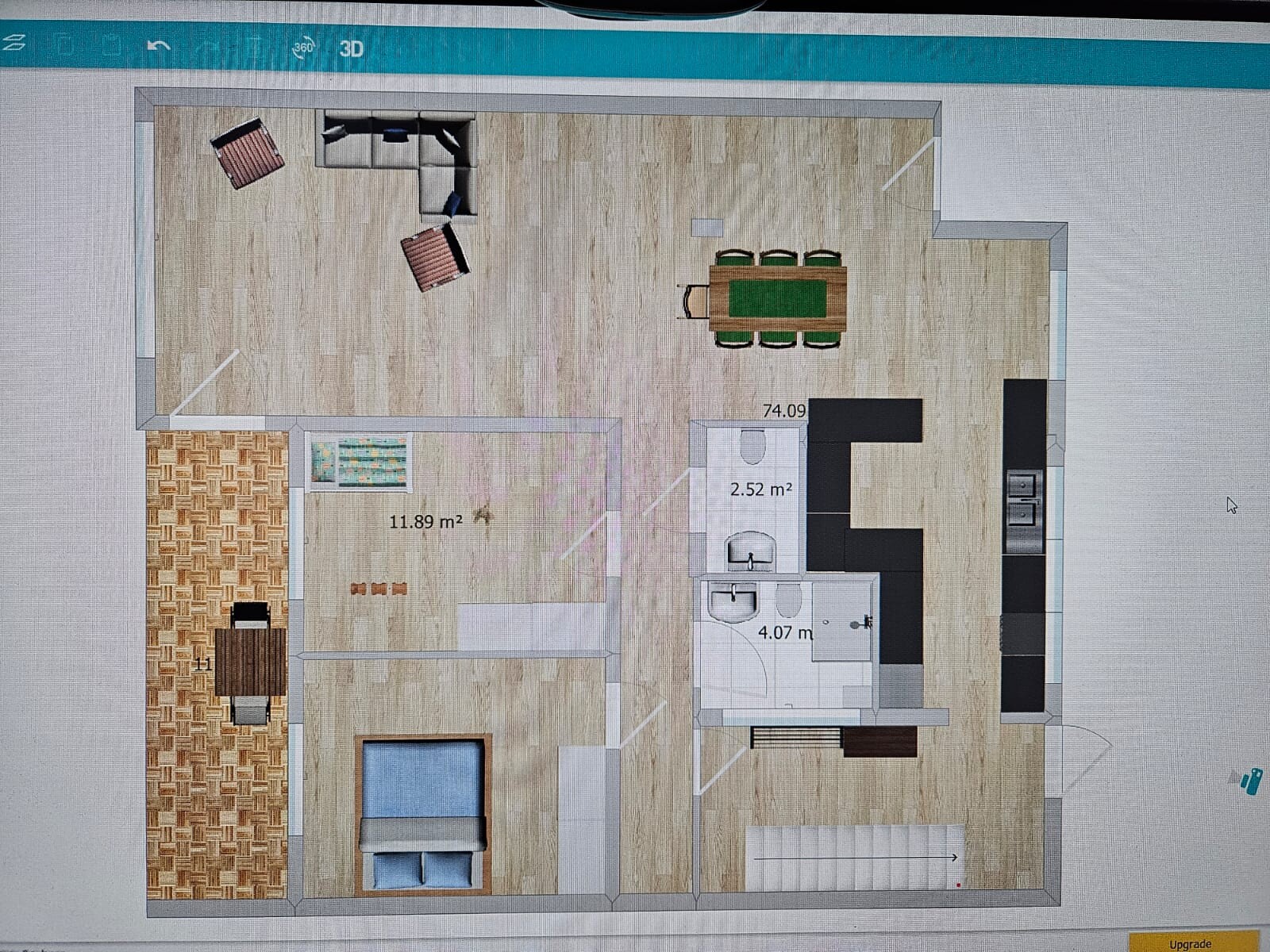

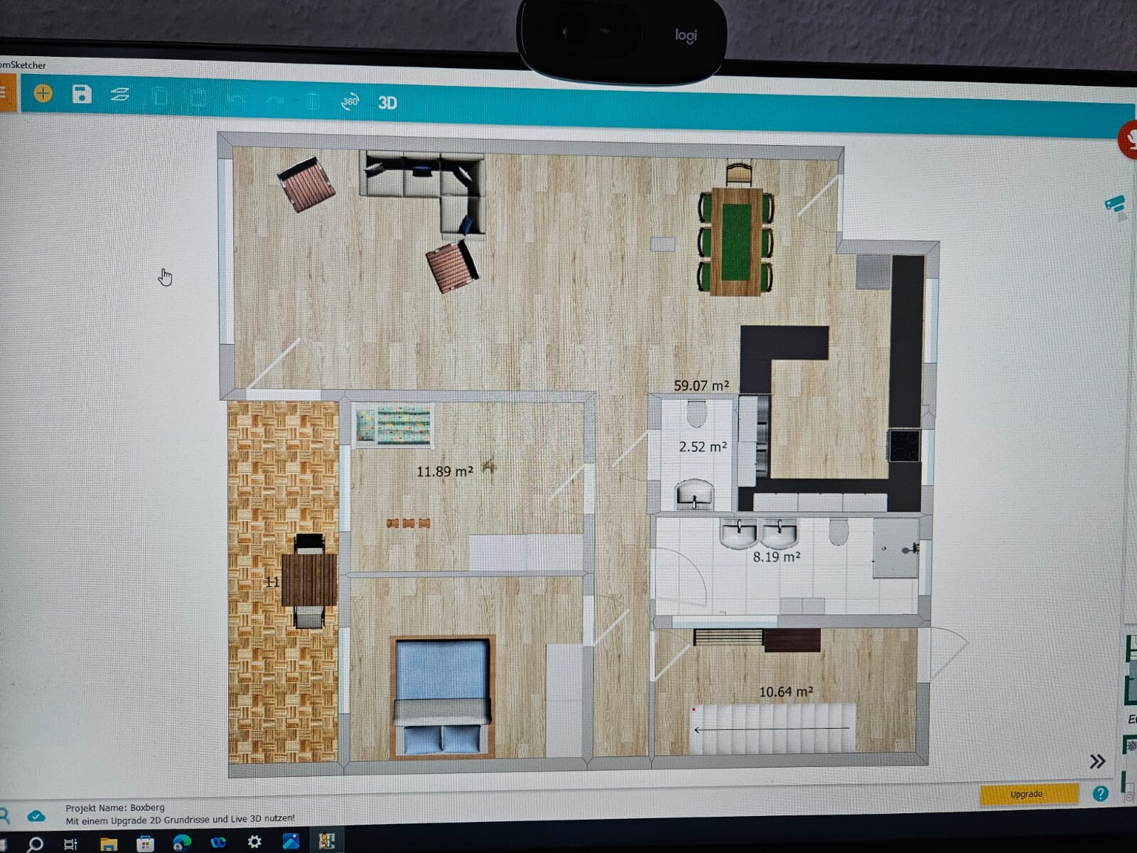

- We would like ideas for the layout and feedback on my rough initial drafts
- Goal is to modernize and brighten the interior bathroom, either by converting it to a daylight bathroom or adding clerestory windows
- The narrow, galley-style kitchen should be more open (I would love a kitchen island but don’t yet have a good plan)
- The house has two entrances; we are considering removing one entrance with a vestibule and replacing it with a patio door by removing the wall to create a larger dining area

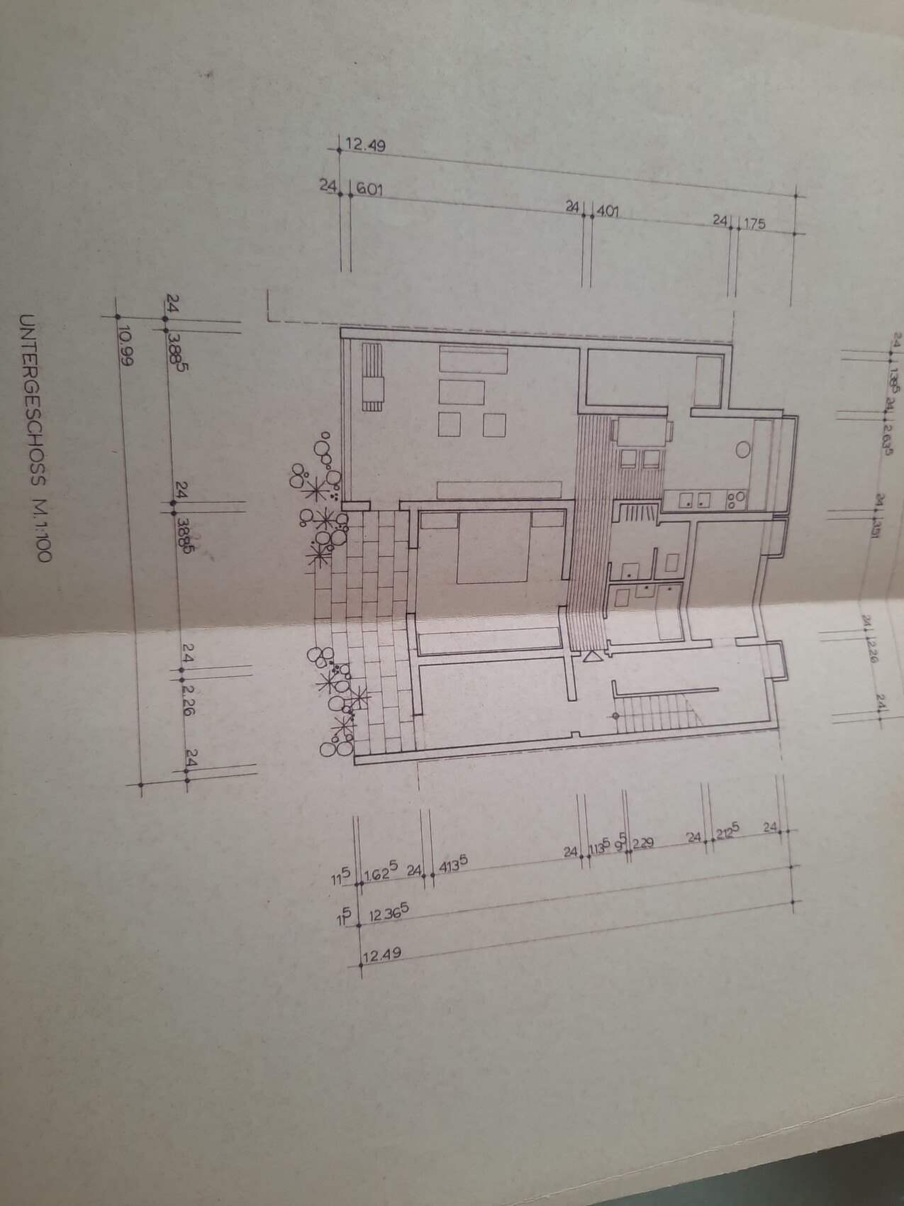

I would design the basement level as living space and therefore use the ground floor as a private sleeping area.
Divide the bathrooms on the ground floor so that one half can be used as a utility room. This way, there is also a bathroom with natural light.
In the basement, shorten/open up/remove some wall elements so that you enter a bright area immediately when going down the stairs.

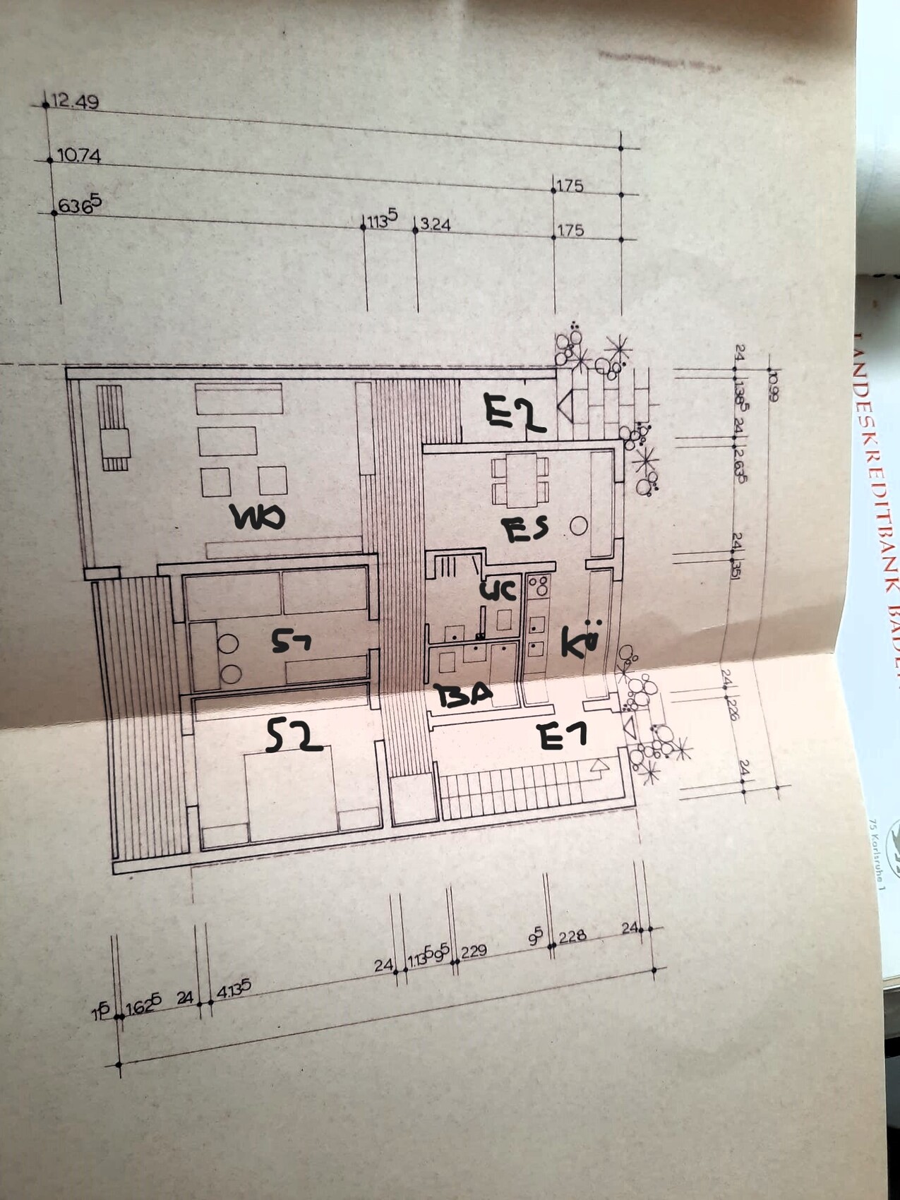

Flo_plant20 Aug 2024 09:10Flo_plant schrieb:
I have added some labels for the ground floor to make it clearer – see attachmentThen please take a photo from above or make a scan with your phone.F
Flo_plant20 Aug 2024 12:01What do you mean by from above? Unfortunately, I don’t have access to the house yet to be able to do a scan.
Flo_plant schrieb:
What do you mean from above? Unfortunately, I don’t have access to the house yet to do a scan.Of course, I meant from your little paper. You can easily take photos or scan from above with a smartphone.Similar topics
