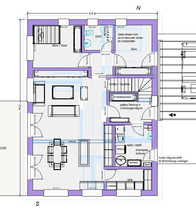

I want to show the open version in response to #52. I personally like it better. However, you probably won’t get away without a beam here – indicated as a double line:
Floor plan of a building complex with offices, kitchen, bathroom, utility room, and stairwell.
The exterior door for the offices is no longer optional, because otherwise colleagues have to walk through the living area to get to meetings.
SoL
2 Feb 2022 09:10
That really looks great!
The exterior doors are optional for us because my wife plans the lessons on her own, and my team is located 250km (155 miles) away. I work 100% remotely (independent of the pandemic). 😀
