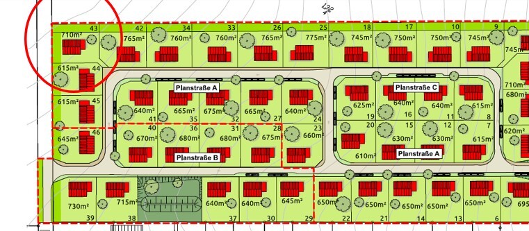

The house is planned for the top left corner plot (circled) on the site map.

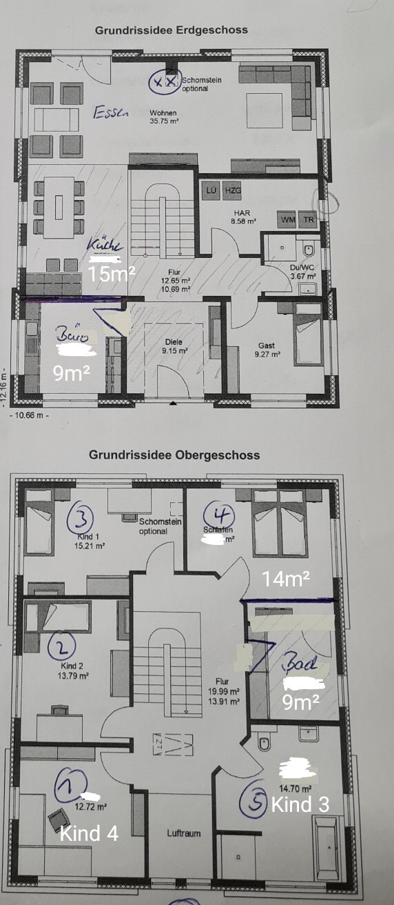

The floor plans have unfortunately been manually altered, so my revisions regarding room names are included. The guest room is actually office 2... The revised room sizes are approximate.

I generally like the floor plan; perhaps adding a bay window to the kitchen could create more space for a better connection to the living area and a pantry. This would also benefit the upper floor area, as I personally find a 9m² (97 sq ft) bathroom for six people quite tight, especially as the children grow older. 😉
where is north on the site plan?
I find the bathroom size problematic for 6 people.
I would remove the gallery and create a large bathroom for the children with a bathtub, plus a small ensuite bathroom in the master bedroom.
Another option to consider would be to place the utility room (possibly including technical equipment?) on the upper floor. Then the laundry is done where most of it originates. This saves walking distances.
However, that will be quite challenging in terms of space.
I like the large entrance area; you will need that space, but you probably already know that... 😉
Unfortunately, I’m not really happy with the layout. I have a feeling that a different staircase design could save a lot of circulation space on the upper floor...
Also, you have the unwanted access to the living room through the kitchen.

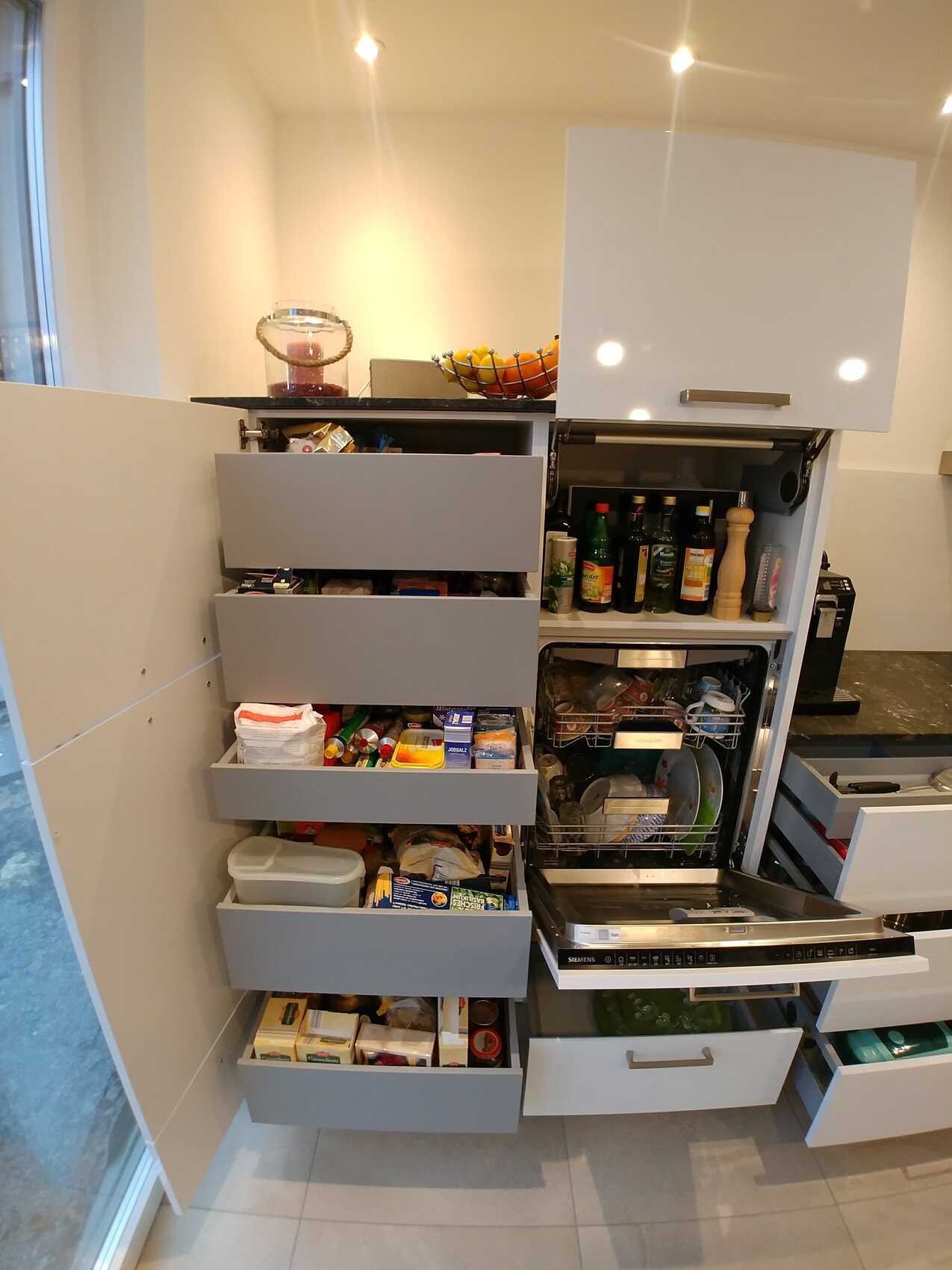

I prefer a large built-in refrigerator in the kitchen and a storage cabinet, which holds plenty of supplies. Rarely used items can go into the utility room.
I’m always surprised how much stock we can fit into our pantry cabinet.
I’ve attached a picture; ours isn’t even head height.
€: And a skylight above the staircase would probably be a good idea for the ground floor as well. I imagine the hallway might otherwise be rather dark.
First of all, thank you for your assessments.
I share the concerns regarding the bathroom size; possibly Child Room 3 can be redesigned to utilize the unnecessary empty space, which would benefit the bathroom.
Thanks also for the picture, it eases my concerns about the pantry, and we also have the kitchen island for additional storage.
Regarding the north orientation: in the upper part of the plan, you can find the plot number of the adjacent field (132/4), which is oriented to true north. So north is to the upper right.
NoSchnitzers25 Jan 2022 21:50A few suggestions from my side, as we had six people ourselves:
- I understand your concerns about having to walk through the kitchen to get to the living room; I would feel the same. We had an entrance to the kitchen (more like the dining area) and a separate entrance to the living room. Like the next point, I believe this brought calm to our house, as anyone going in or out of the living room didn’t have to pass through the dining and kitchen area.
- We were able to separate the kitchen/dining room from the living room with a sliding door. That was something we really enjoyed. There was always a lot of activity in our house, so this helped to reduce the noise and disruption a bit.
- We had two showers; the one on the ground floor (main floor) was never used. From that perspective, I think one bathroom would be enough for six people, but we were all girls, so maybe teenagers are more tolerant than in “mixed-gender” households. As mentioned, a slightly larger bathroom probably wouldn’t hurt.
- What I really like is that all the bedrooms are on one level (speaking as someone with a childhood fear of stairs 😀).

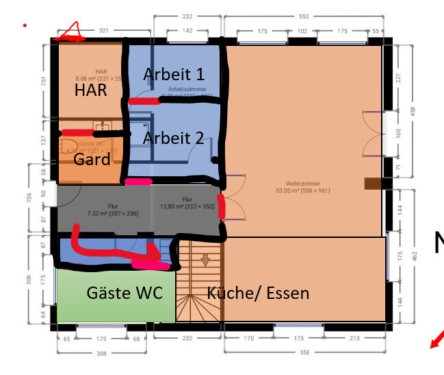

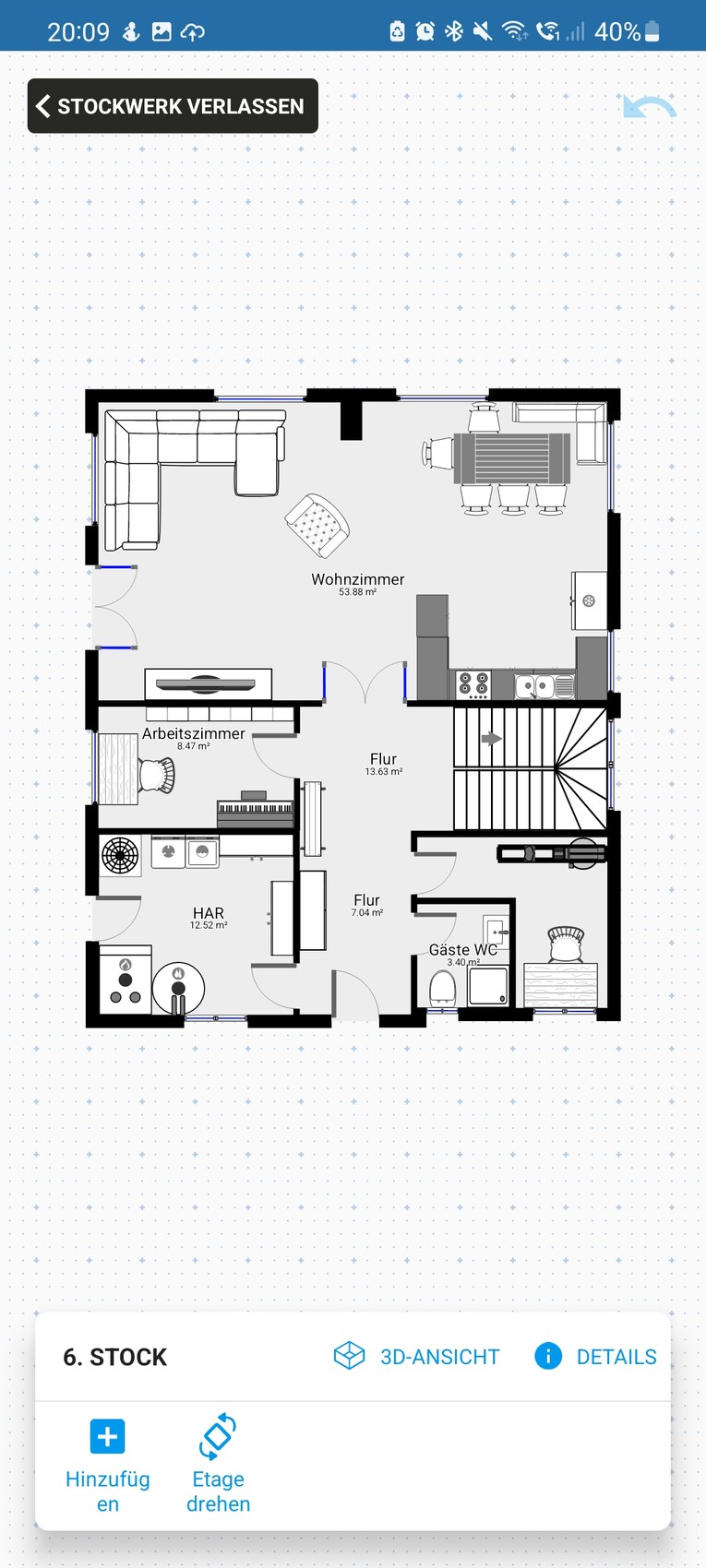

I don’t see a practical kitchen there yet... what is shown is not suitably furnished or dimensioned. However, if I assume an exterior dimension of 10.66 m (35 ft), the kitchen only has about 3 m (10 ft) width and also serves as a passageway.
It would generally make sense to measure the site plan accurately, add a true north arrow, and then also include a north arrow on the floor plans.
The advantage of having the staircase in the center of the house is that you can arrange the rooms all around it on the upper floor. Since there should be 5 bedrooms and at least 1 bathroom, each room should preferably have an exterior wall and be accessible from the hallway. I would also omit the open void/cutout space above the staircase.
